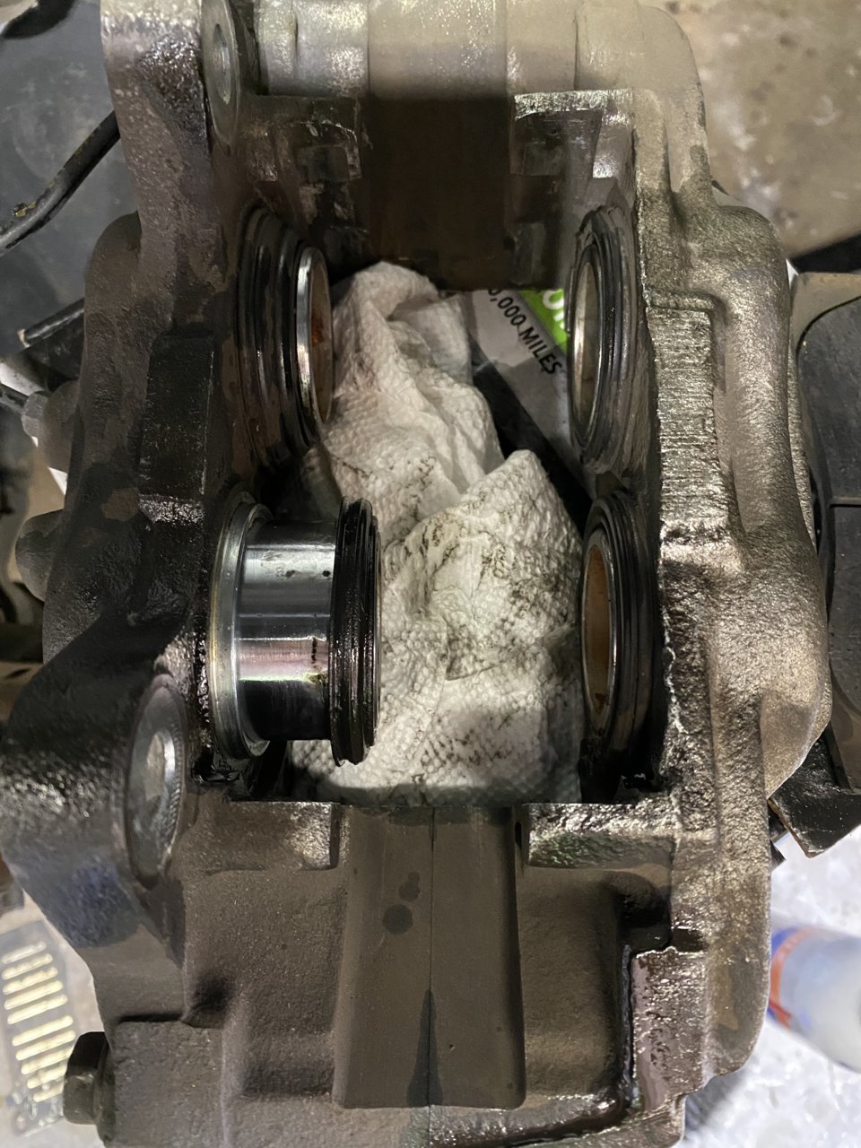

    Hey all, swapping out pads and turning rotors. I was re-compressing the calipers and I didn’t notice as it was happening but one of the pistons popped out of place. Leaked fluid everywhere.
    I was able to clean it all up inside and get it back down. Got the boot around and the clip back on. Seems okay… but my question is, what else could have been screwed up in the process?
    I assume I let air in the lines and obviously lost some fluid. Should I do a full bleed session now? I’ve read that some people really have problems with bleeding because of the ABS system, and I was going to skip bleeding for this go-round. I bet I have to now…
    any tips? Any advice at all would be appreciated.
    Thanks TW

    Did the master drain?

    No still plenty of fluid in the reservoir

    You should be ok the re: no need to bleed system.
    But I would carefully bleed that corner, and maybe test the other side for bubbles

    Man, that's a tough one. My mind would be jumping to options. Depending on how confident I was that trash did NOT get inside the system, I would make sure the gasket is in great shape and fitting right, then bleed the system. If I thought that trash did get inside, I would swap out with a good used one or reman. (be glad you don't live with my mind. LOL)

    If the piston popped out, he pushed air back in the system when replacing it. So yes absolutely bleeding that side is necessary, and if you are doing one you may as well complete the job and do all 4.

    I would think at minimum bleed the caliper that the piston popped out of, air definitely got in then when the piston was replaced

    You'll need to bleed the brakes. You can do it the old fashioned way without worrying about the ABS unit. Start at the caliper that popped its piston out. It's easy to do with a self-made bleeder bottle:

    I rebuilt my calipers recently so see the pics:
    2 Gen Caliper Rebuild | Tacoma World
    There is a snap ring type band that holds that outer seal on so make sure you get it on in the groove.
    Make sure the inner seal in the caliper did not rip - when you put the piston back in it should slide smoothly in.
    Looks like it was the inside piston closer to the bleeder so easy bleed job.
    If it doesn't leak when you get them bled and then turn the key on and the pressure pump comes on - test the pedal pressure and no leaks you are good to go.
