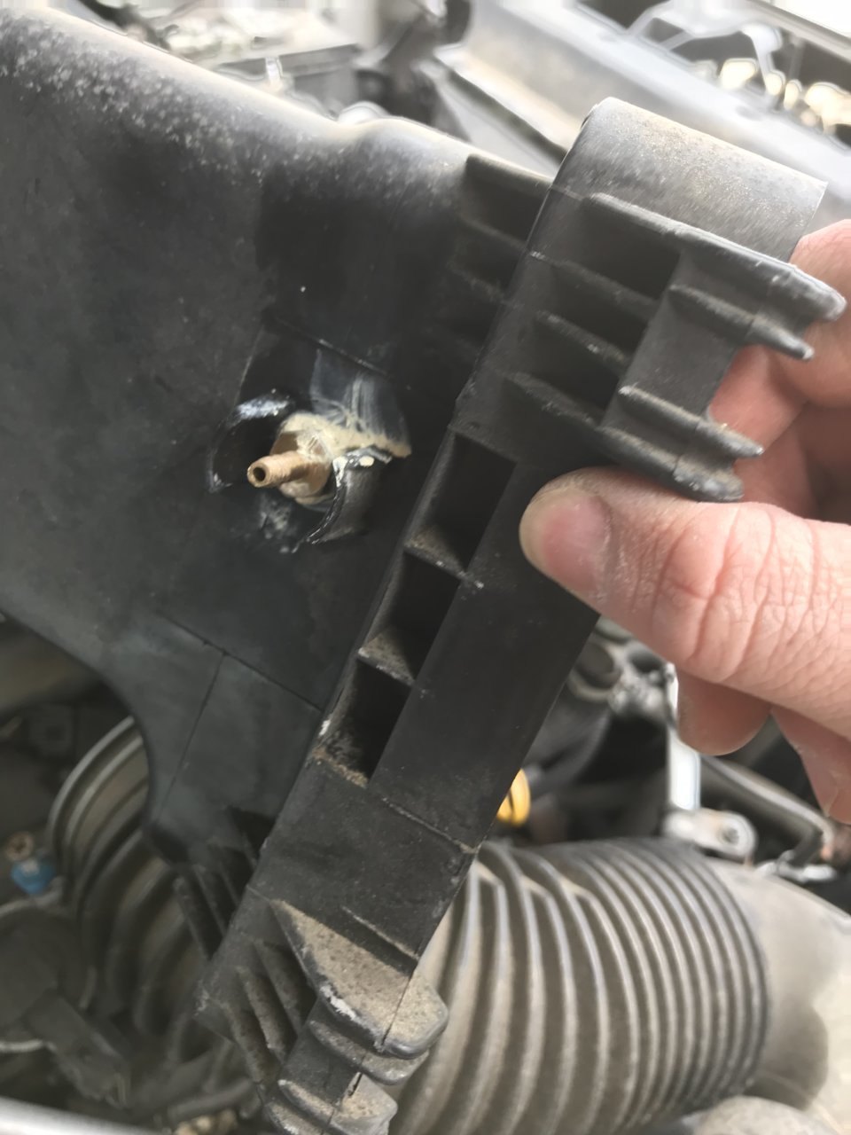

    Uhhh there’s no way that will fail smog
    The 1/8” barb should work perfect

    Yeah that barbed by threaded will work fine, just find a drill bit that is ever so slightly smaller so you can tap the threads into the plastic airbox with it.
    Like how I showed in one of the pictures I posted, it may help to heat up the plastic and the fitting slightly so it threads in easier with less chance of cracking the plastic.

    So I have everything put back together. It’s looking good. If anything looks iffy just let me know. Threaded the new nipple on with Teflon tape and a little compound and got the vacuum hose snuggled up.

    Man this thread is a life saver. Spent about an hour trying to find just this. I was doing the same as the OP and -“SNAP”. Except my fix is way less pretty.. i cut the three plastic supports at the base of the broken nipple and slapped the hose back on that stub for now..
    Time to make a trip to the depot and fix this permanently before it slips out...
