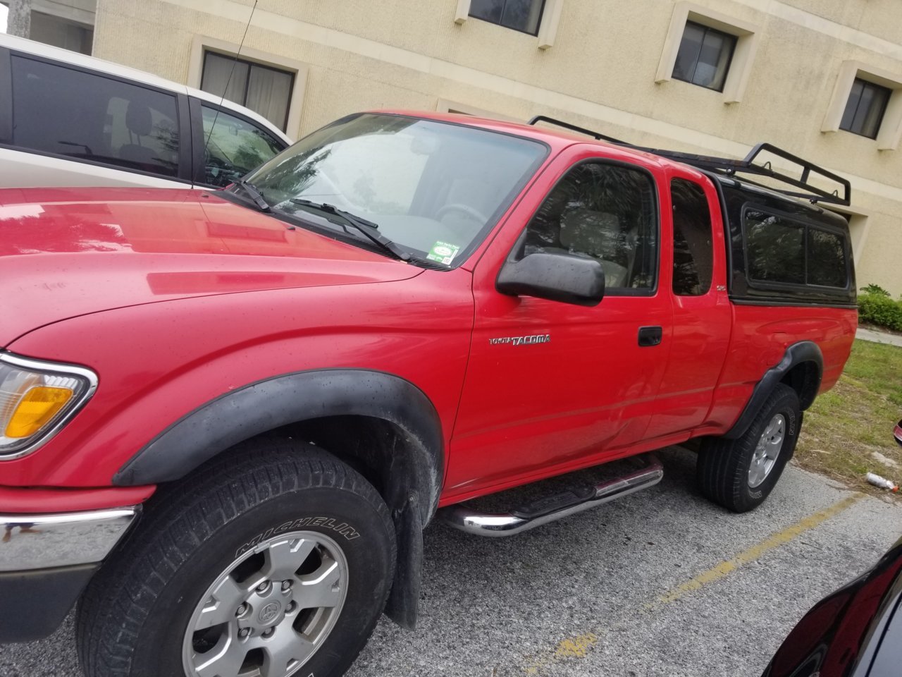

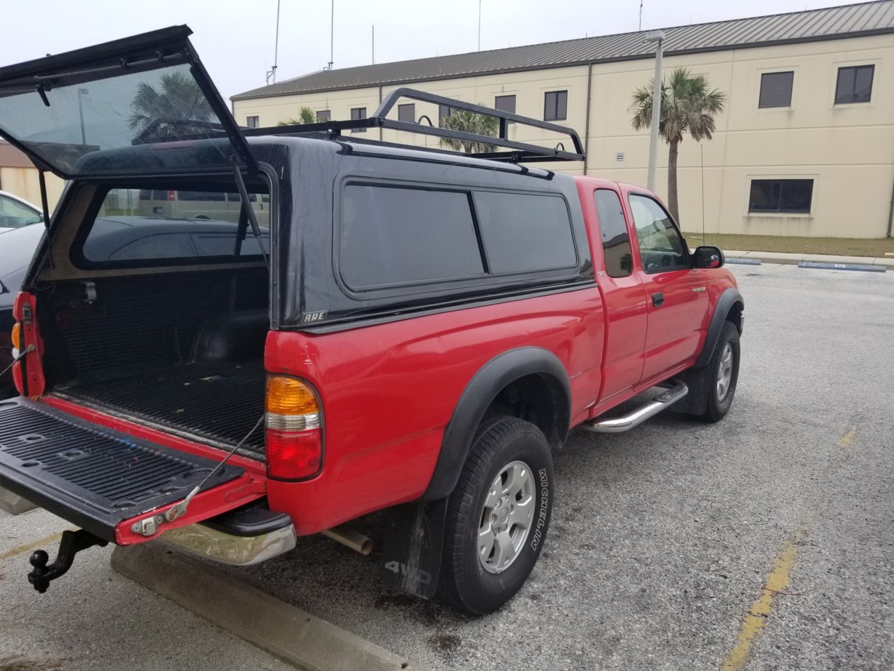

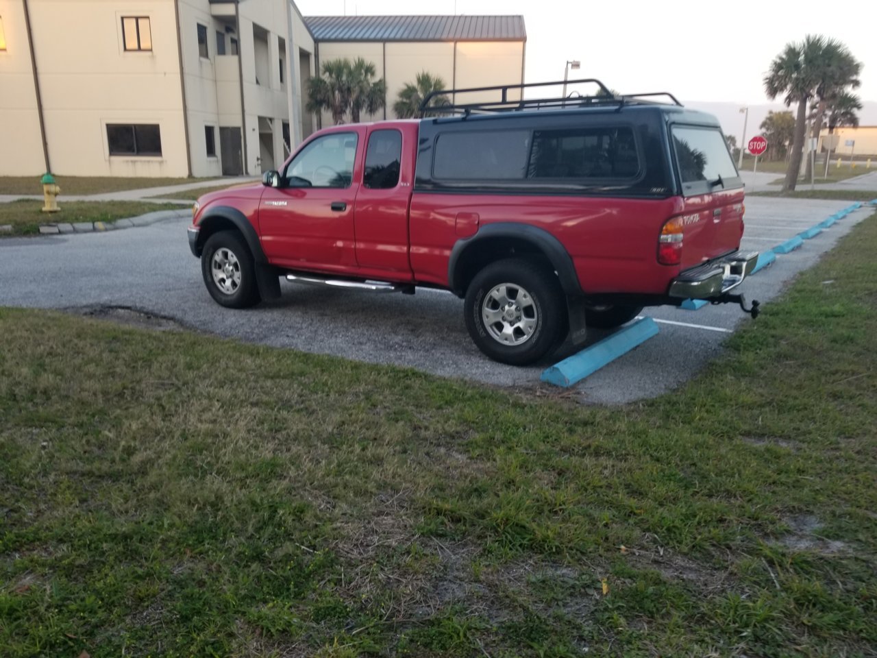

    Hi, guys!
    I recently purchased an 01 V6 5spd 4wd SR5 taco with 62k miles on her. I really enjoy going to the beach weekly. Also, going on mild trails. I believe it has a 3in lift in the rear and 2in in the front. Other than that it's stock.
    This is my first truck btw..
    I want to build a basic beach rig that will also be good on mild trails(getting to the beach).

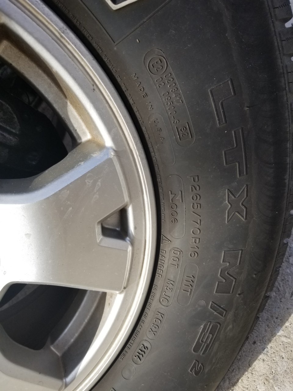

    If y'all can help me out on how to do so it'll be great! Such as tires and wheels. Also, what basic upgrades I need to make her last forever.
    Thank you so much for your time

    That looks low for a 3" lift... But it's hard to tell with pics anyway.
    The key with sand is airing down. You could easily work with what you have now as long as you air down appropriately for the sand (15-20ish psi). If you find that's not enough, then you could easily go for some more aggressive all terrains in a 265/75r16 size, of 285/70. The 285's might rub a bit, though.
    These trucks wheel perfectly well bone stock. It's amazing what you can get yourself into with them... :)
    So I'd just drive it as is and air down when you get to the sand. If you find that's not enough, work on some more aggressive tires.

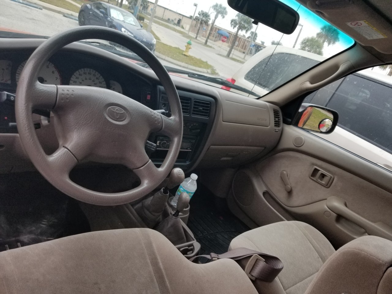

    I also don't think that your truck is an SR5 since it has no bucket seats or power windows

    Its an sr5 in spirt.

    One other thing I'd recommend is pulling the plastic bedliner to check the condition of the bed underneath. When I pulled mine, some of the ribs on the bed floor were stripped to bare metal from the thing sliding around ever so slightly with sand trapped between the metal and the plastic liner. In a dry climate, no biggie, but if you're spending a lot of time by the ocean, that wet, salty air will go to work on bare metal pretty quickly.

    Here is an exhaustive and all encompassing list of what comes with an sr5.
    1. Sr5 badges
    2.
    And that's it. My 01 was an sr5, most stripped down vehicle iv owned in a long time. Power nothing, right foot cruise control, intermittent wipers until you got tired of turning them non/off, manual hubs the list of what it didn't have was impressive.
    And yet the original owner paid extra.
