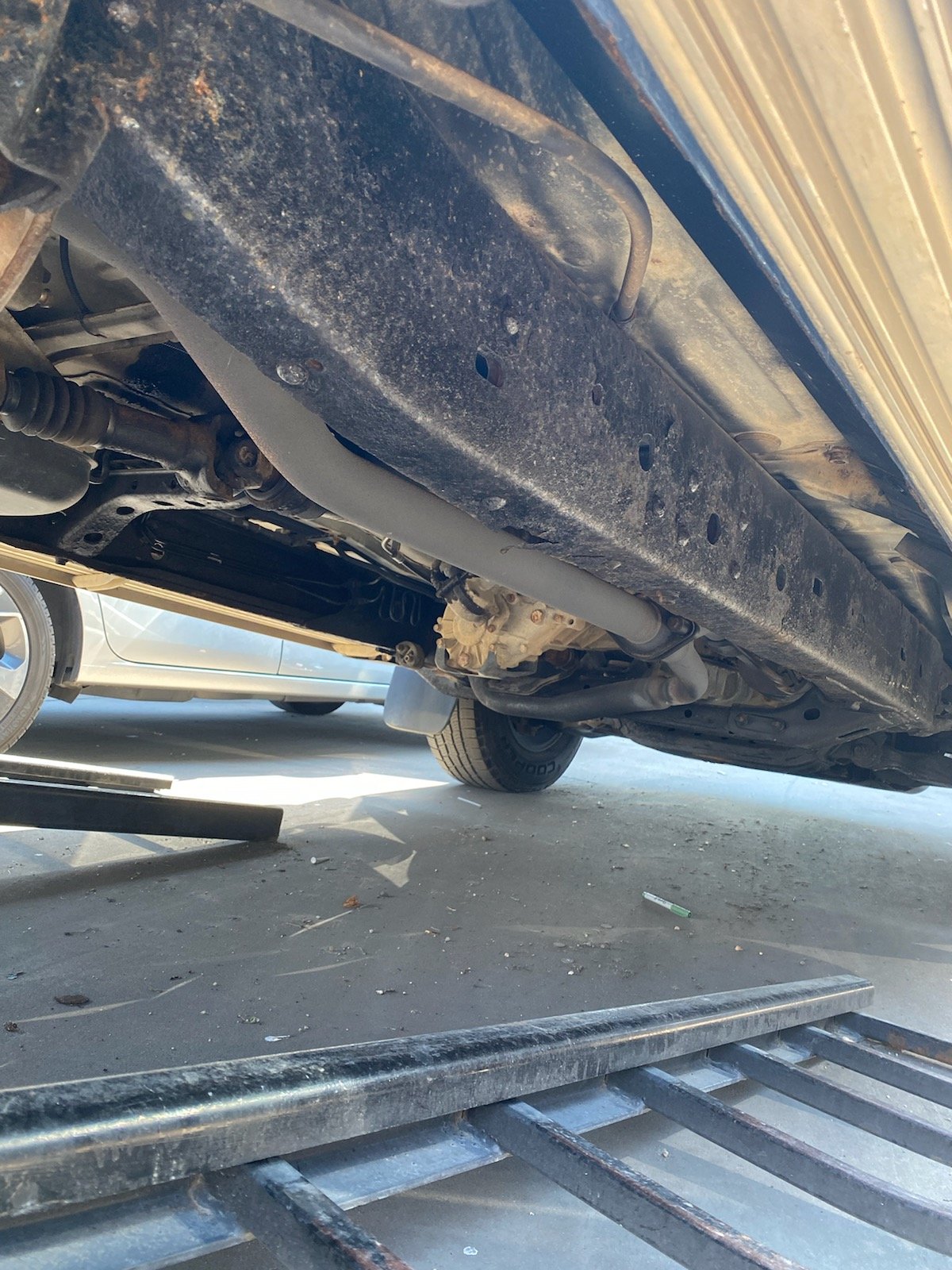

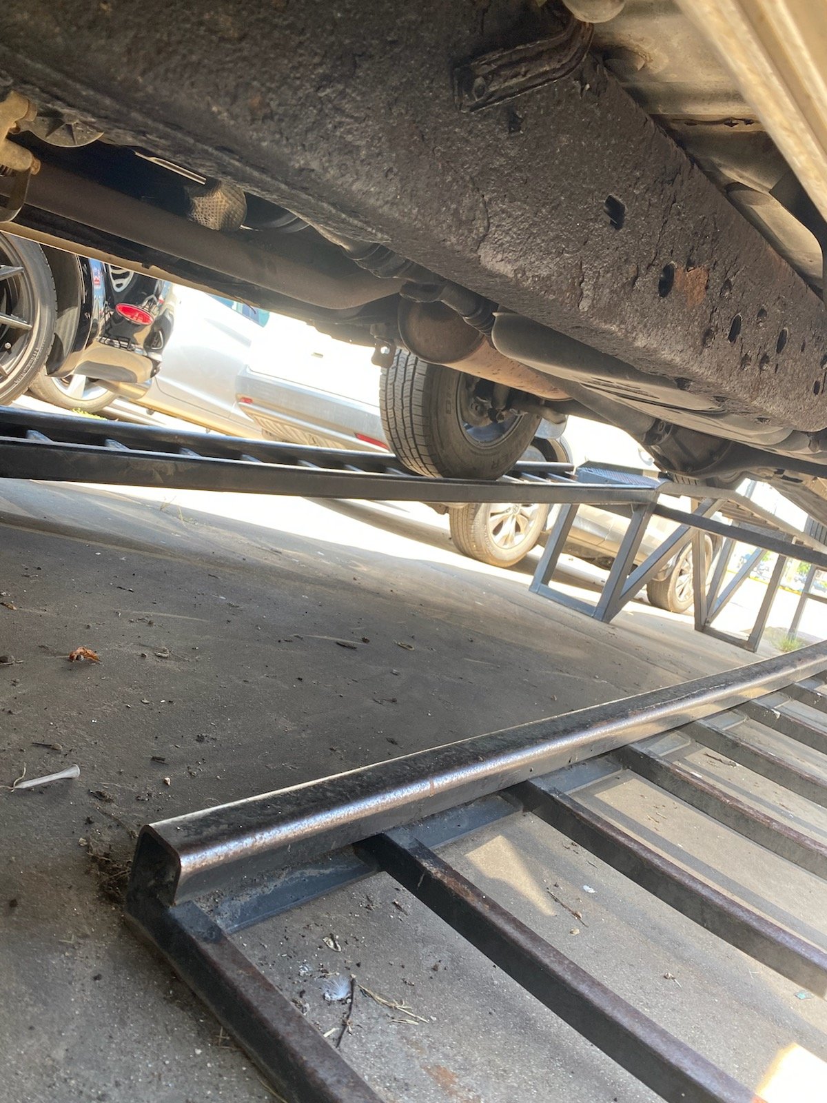

    option 1: Seller is selling tacoma, but underneath looks a little rough. I talked him down to 8700, but still hesitant. How bad is the rust? 208K Miles
    2006 Toyota Tacoma Double Cab Manual V6 4x4

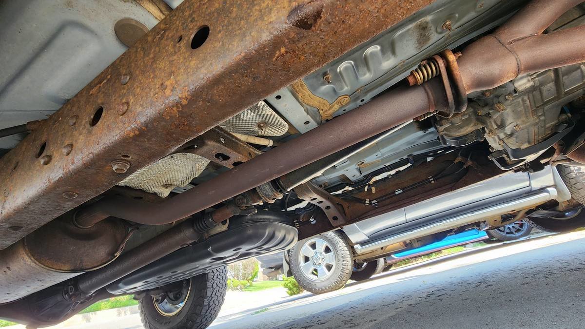

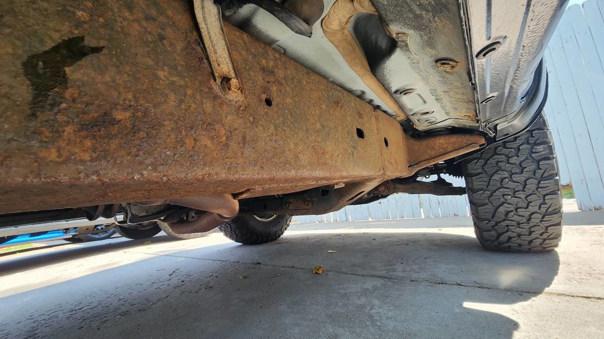

    Second option: 05 tacoma 235k miles
    also has frame rust, here are some pics of that one.

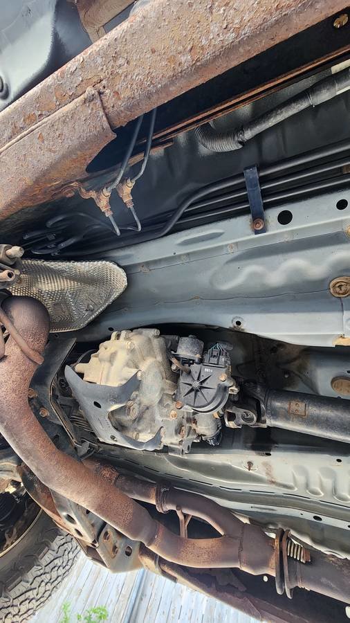

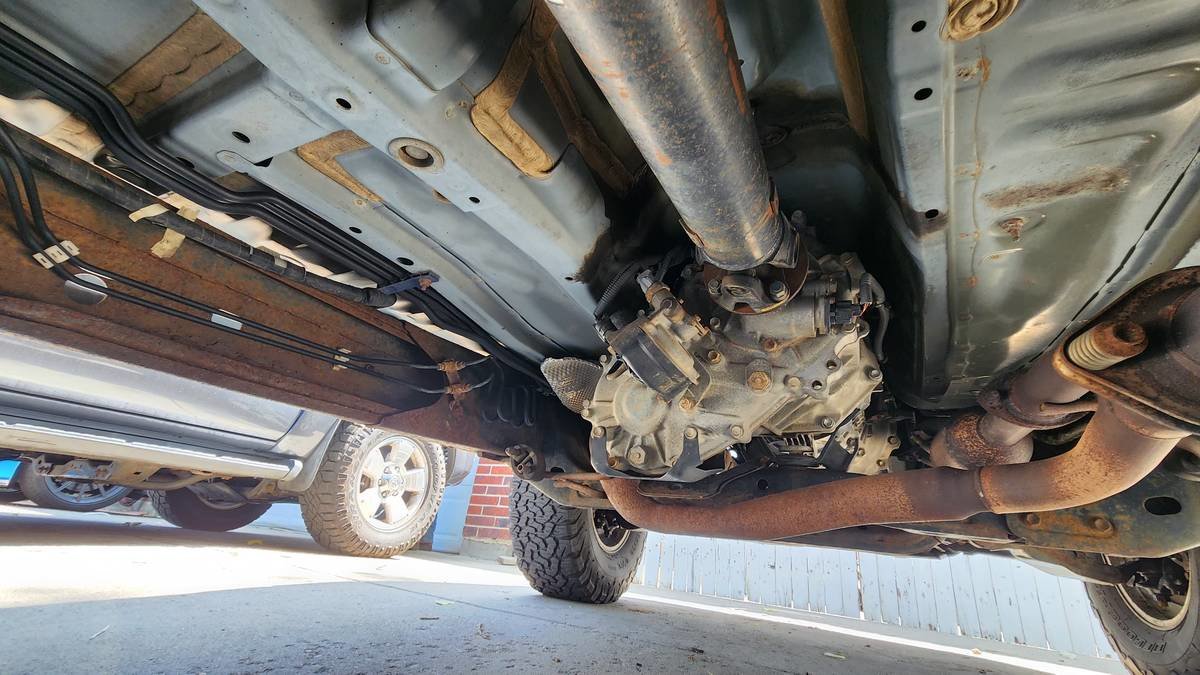

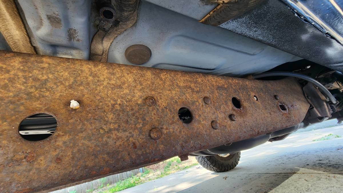

    going for $9800 744567236.jpg 744567160.jpg 744567194.jpg Screenshot_20240805_101648_Chrome.jpg Screenshot_20240805_101659_Chrome.jpg
    What do you all think? Should i buy either one of these or wait for a less rusted one? This is kind of my budget range, so it makes it difficult.

    If don't need the truck now and can afford to wait for something better to come along then I'd pass on these trucks. If you absolutely need the truck now I'd go with the first option. Just my opinion

    2nd option is a hard pass.

    What makes the 2nd option a hard pass? Just curious...
    Dealership said and i quote:"the peeling that you see is the rust protection that was sprayed underneath. we bought it like that."

    The 2nd truck bothers me more because even though it's been coated, at this point, the coating is holding more moisture than it's preventing.

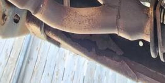

    Option #1 at least looks like an "honest" truck - that is the seller hasn't done anything to camouflage any rust damage.

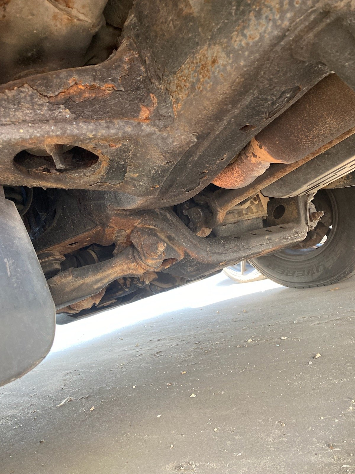

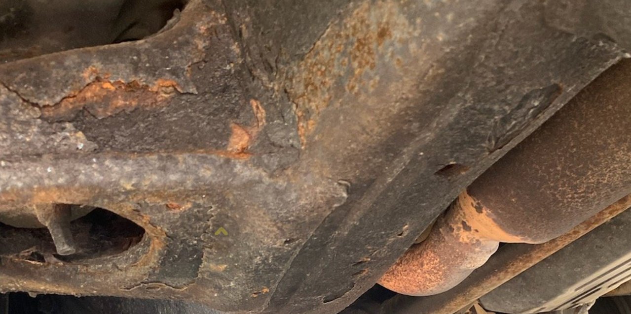

    However, what is this?
    Option #2 is not worth your time or money, hard pass.
    There is already a hole in the frame and I'm betting a good smack with a hammer and there would be a hole in that body mount.
    As a general rule, never buy a vehicle with a recent "undercoat" job, this was done make the frame look nice for about 6 months, eventually the rust that the undercoat was sprayed on lets go and the real (bad) condition of the frame is visible.

    1st looks okay
    2 nd looks like it’s delaminated already
    But the pic @RustyGreen pointed out is not good.
    Might want to pass on both.

    That 5th picture would be the deal breaker for me.
