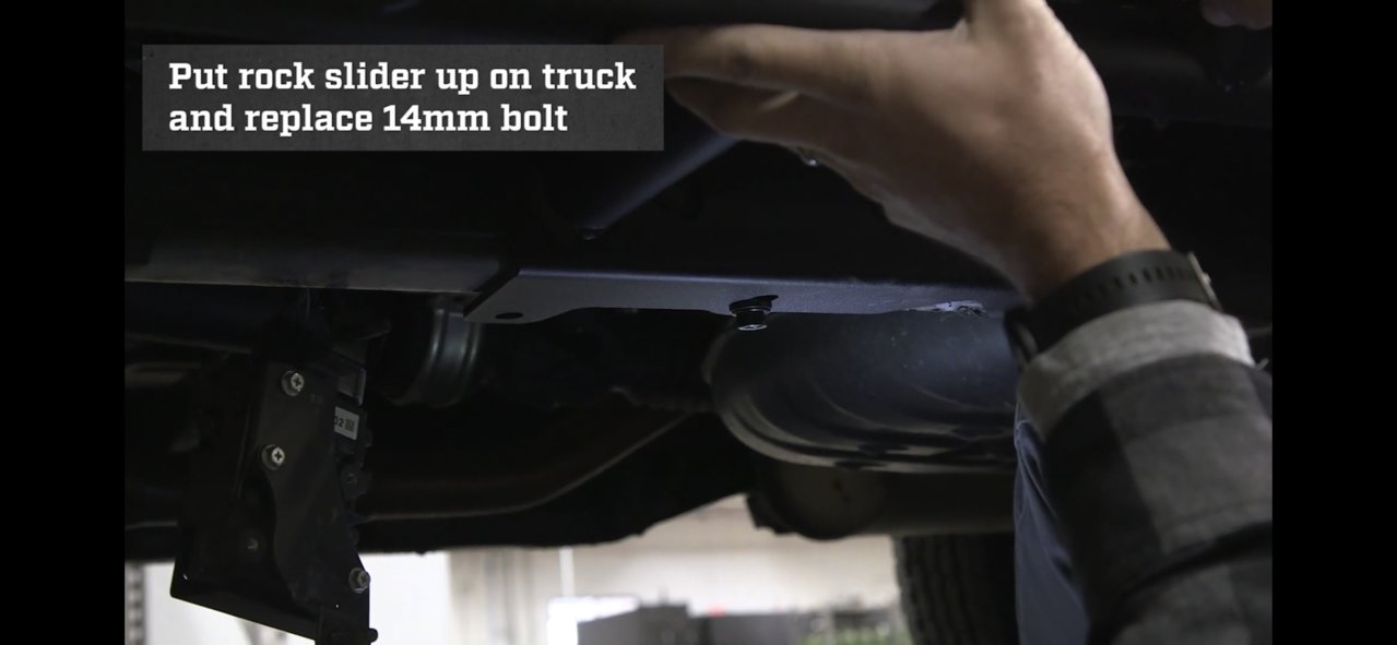

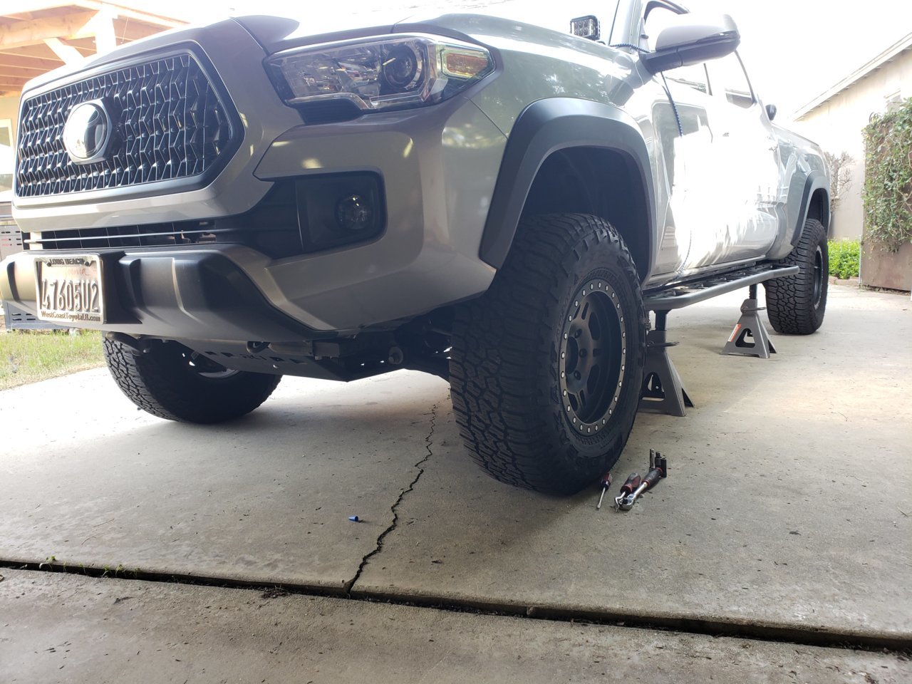

  10. Feb 16, 2020 at 8:29 PM
    Guccitaco
    Guccitaco [OP] TRDPro 2020 Army Green
    Dec 17, 2019
    #313585
    195
    2020 AG trd pro
    little bit of here and a little bit of that...
    Out of the instructions I got to install the 14mm black stock bolt in the center first, I think yours look different..... here’s how mine look from YouTube vid

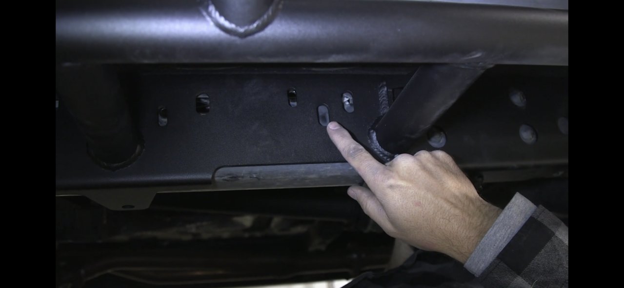

  11. Feb 16, 2020 at 8:38 PM
    Guccitaco
    Dec 17, 2019
    #313585
    195
    2020 AG trd pro
    Here’s a photo of Cali raise YouTube vid. Where he’s pointing at- the bolt hole to the left, bolts holes on mine is millimeters off, and sliders aren’t flushed in like that on the top of the frame. Want to mention again, I did not tighten up any bolts, I did a few turns (3turns) to hold in place, and did lots of wiggling to try and Line everything up and flush it. Just gonna try again tomorrow, something so easy has to be my errors, 8FA6CC8B-89BE-4D3F-B5F0-0659FC5E8ADC.jpg

    Oh they are different because I'm Double cab long bed. Your pro is short bed.
