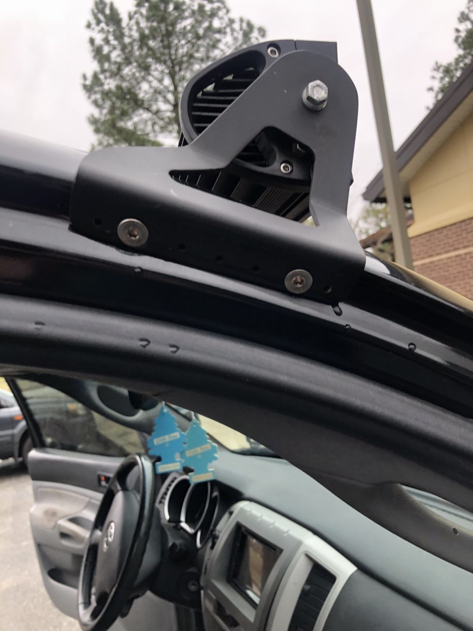

    Picture of the brackets?

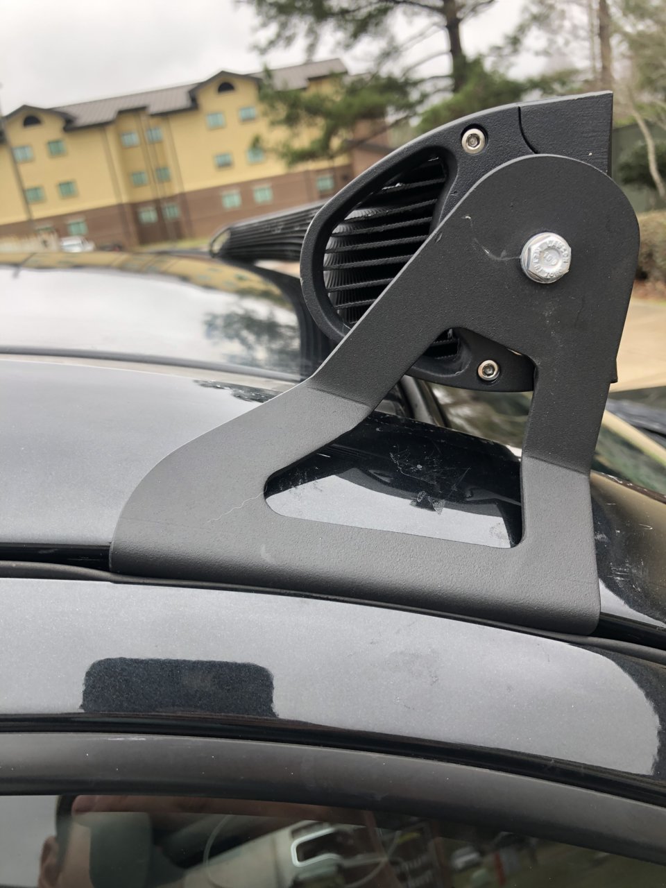

    Here’s some pictures of the right side.

    Looks to me that the design channels water into the door. I don't know if new seals will change anything. Also, I doubt there is any sealant behind the brackets which I assume don't exactly fit perfectly flush with the cab.
    If it were me, I'd get rid of it and look for a bracket/light bar that uses the OE mounting points for the roof rack.

    If you do decide to keep it. I'd say at least remove it to add sealant to the holes they drilled to keep water from making it's way into the pillars.
