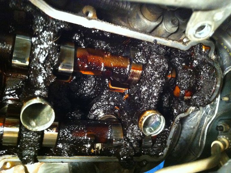

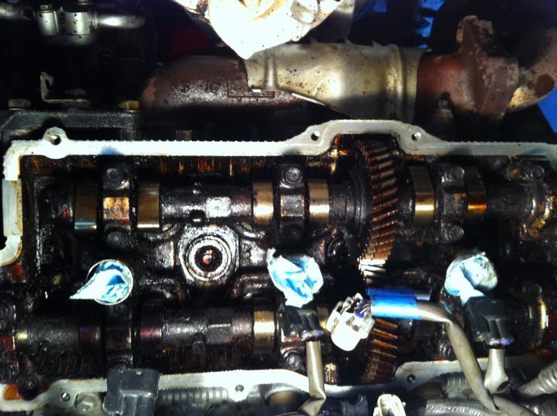

    Thanks for all the input so far so here's an update I've cleaned passenger side camshaft casing. I've attached a picture of the cleaner casing. All the cleaning was done with an air compressor and a plastic scraper tool the tooth brushish tool turned out to be worthless for cleaning.
    I then opened the drivers and not surprisingly it wasn't much better (third photo). So sticking to the plan i'm going to put her back together run the engine flushes and open the casings again to see if there's been any improvement. The casing still does look a bit on the nasty side even after cleaning cuz i didn't use any solvents. But when you look at how it was before cleaning this is all kinds of awesome.

    Damn dude that's a mess. Sub'd!

    There are small looong brushes available to get those oil passages clean. Especially the oil return gallery from the head to the pan.

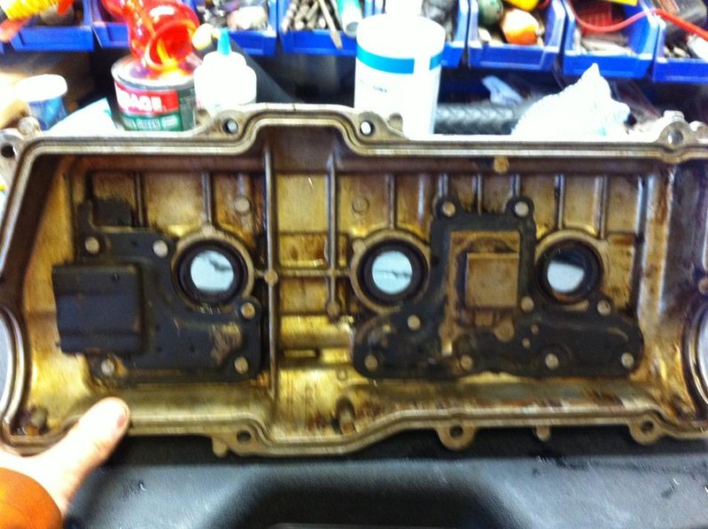

    Ok I got it back together and it started horray! But my excitement was short lived because now the oil warning light is on. So i went from elation at having it start after taking the most gear i've ever taken off and engine to being terrified about letting it idle on the account of the warning light.
    I didn't change the valve cover seal after i opened up the valves because i was just going to come back in there after the flush and i was going to do it then. So that may be contributing to the lack in pressure except maybe not because the valve covers are never a perfect seal anyways on account of the PCV valve that will let pressure out. So now that i think about it reusing the seal not likley the problem.
    So should i change this oil refill hope the oil pressure light is off and then do the flush?
    Or run the flush now with the oil i got in there and hope the flushing clears up the low pressure business?

    With that MUCH sludge in the engine only way to do this right is to pull the engine out of the truck.
    Your cam in a few pics looks BURNED from no oil pressure or very little. Tho the 5vz is a good engine sludge is common around number 3 valves. Do to poor design.
    You cam bearings i bet are TOAST and out of spec. If the top looks like that the bottom of the engine will look twice as worst. Im thinking at this point the screen on your oil pump in the oil pan is plain plunged up from sludge.
    Only problem with adding anything to the oil at this point will be in vein. Even if you could break up the sludge your screen on your oil pump and oil pump its self might not make it. I would also bet the oil pump is full of sludge also.
    Now is a good time to rebuild it.
    That sludge is not from synthetic thats from conv. oil. and and prev. owner with either poor oil changes or using substandard oil( cheap oil)..

    Well i fushed the engine oil twice yesterday and replaced the valve cover gaskets. When i opened up the casing after the 2 flushes I did notice a slight improvement in the reduction of the sludge.
    What was most encouraging was that the cam shafts and casing was covered with a light coat of oil so this lets me know that the oil is getting in and out of the cam casings (crank casing? I'm still not sure which term is correct). The drivers side showed a bit more of an improvement because the flushes were dumped in there i figure. I have some pictures that i'll post later.
