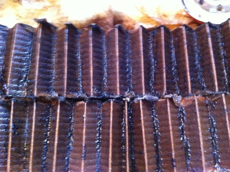

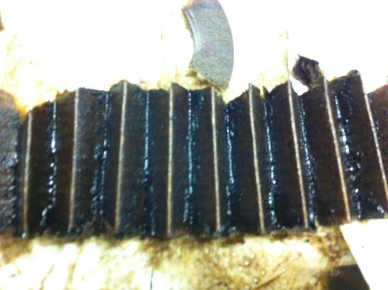

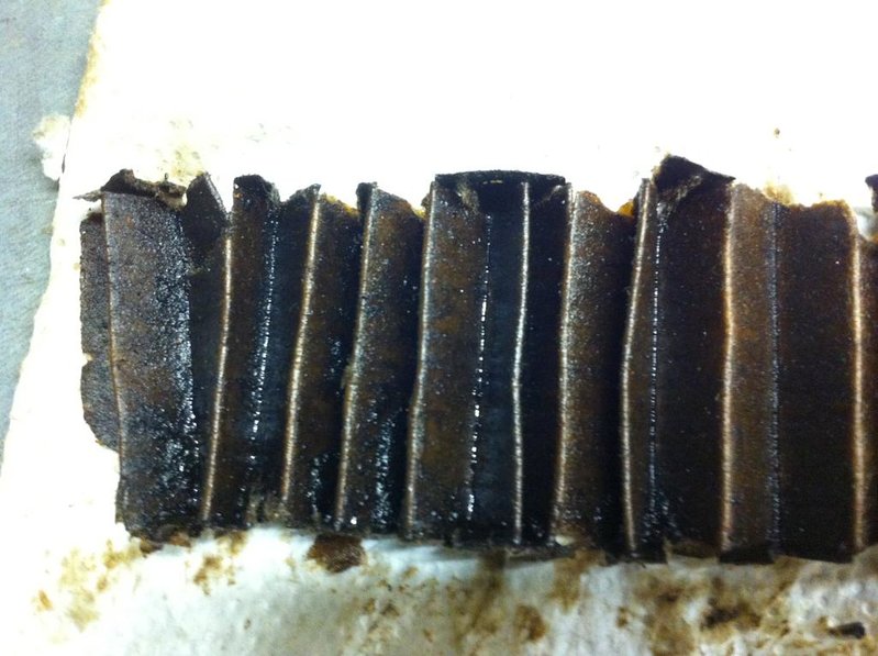

    So far since cleaning the oil pan and fixing the low oil pressure I've put ~1500 miles on the engine. In that time i've changed my oil twice I ran 1/2 a can of seafoam in the engine for ~300 miles then changed that oil. The oil was really dark and had many suspend particles in it. I also cut open the oil filter the first picture is the oil filter after 300 miles w/seafoam.
    I ran the truck with new oil and without seafoam for 600 miles then did another oil change. I did this because i think i had some leaking due to the seafoam making the oil thinner and i was going on a 600 mile one way trip so i wanted to eliminate a leak if i could. The oil at the 600 mile mark did still have alot of particles suspended and was very dark too however not as bad as the 300 mile oil.
    Second picture is the oil filter from the 600 mile interval.
    I'm quite happy with it's performance over the 600 mile trip i didn't appear to be losing any oil and over all the engine is getting cleaner.
    After this trip i think the old girl is out of the intensive care unit. Next oil change will be at 1000 miles i'm going to add the other half of the can of seafoam for the last 200 miles or so. If not the next oil change then the one after i will check my pside valve cover to see if there's been an improvement.

    The 300 mile filter picture didn't really capture how dirty it was here are 2 better pictures
