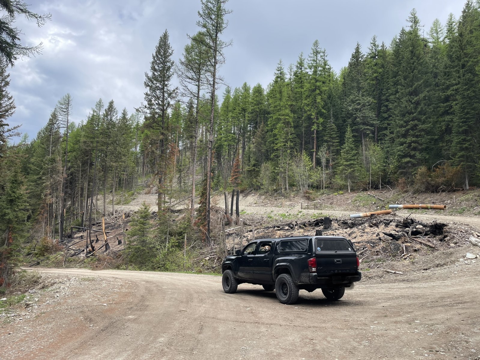

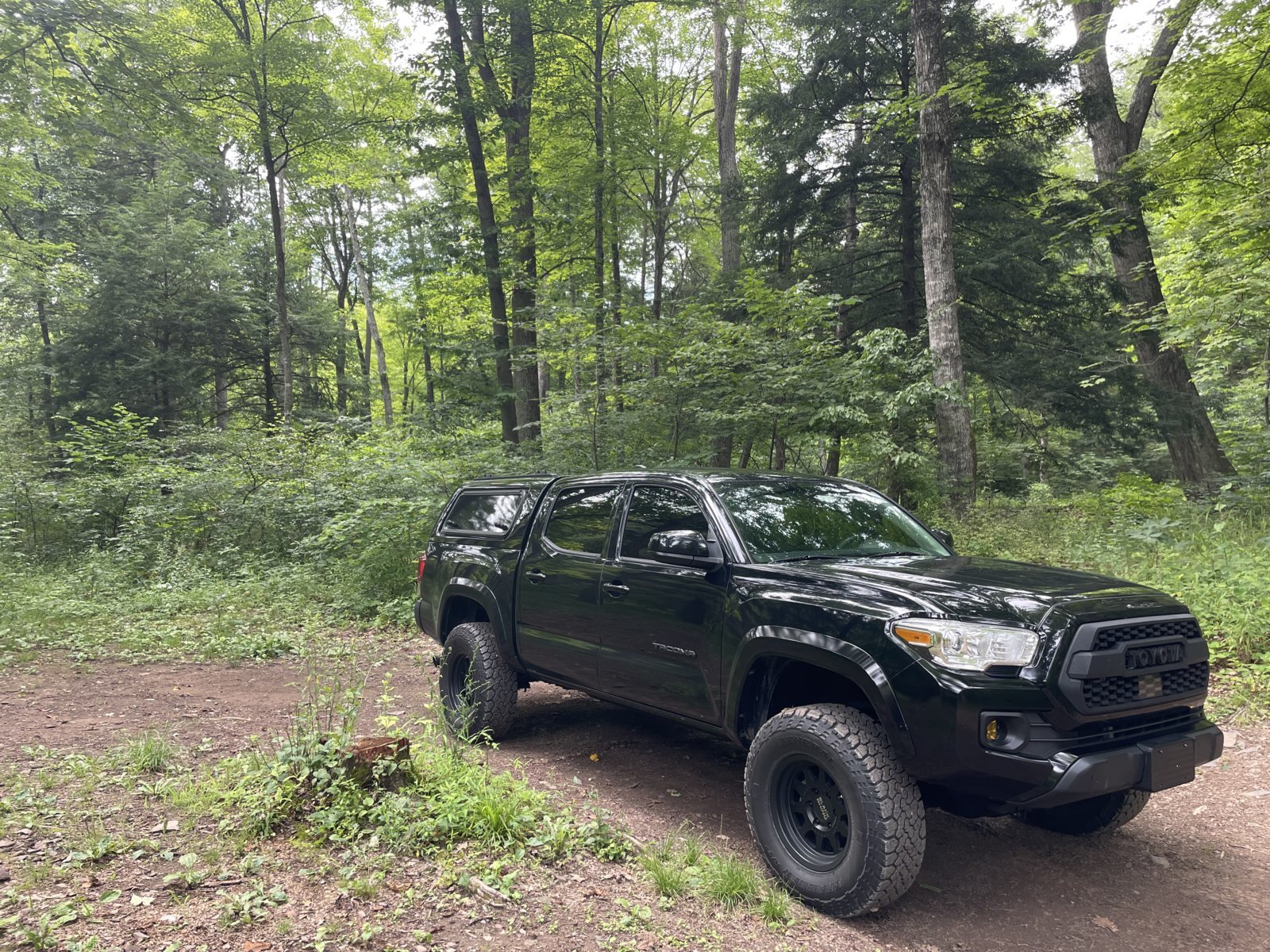

    Well it’s not exactly what you want but here is my truck on 265/75/16’s with the Bilstein 5100’s set to the top notch:
    It looks good in pics but in person the 265’s are very small with a 2” lift. I recently went down to the 4th notch and they still look a bit small. Here is my truck back when I had 285/75/16’s:
    If you don’t care about the look of the size, 265 is a great size. I’d personally go with 275’s if I was you.

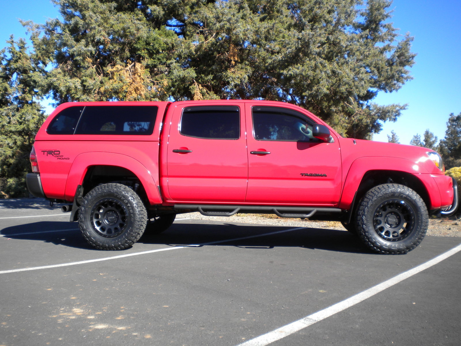

    Icon Stage 8, ECGS Bushing, Timbren ubolt flip, Crown extended brake lines, Overland Custom Design sway bar links, rear differential breather extension, oil filter drain hose, a/c drain hose extension & reroute, front windows tint, Cat Security, XPEL headlight/fog & grill protection, OEM block heater, RCBS illuminated 4X4 switch, Weathertech mats, Wet Okole seat covers, Sherpa Grand Teton/Crows Nest, Baja Designs S8 light bar, Diode Dynamics SS3 Pro fog lights, Piaa driving lights, Method 305 NV Double Black, 275/70/17 Toyo R/T Trail.
    2007 with a 2" lift front/back. After upgrading the suspension the BFG a/t 265/75r16 looked small and wanted a new look anyway. Upgraded to Toyo R/T Trail 275/70r17 and changed out the stock oem 16X7 +30 offset wheels to 17X8.5 0 offset. Had to do some minor plastic trimming, modify the mud flaps, and the pinch weld mod (probably not needed but thought what the hell.) Ended up clearing the cab mount by 1/2" at full lock... glad i didn't go any bigger. Haven't notice any change in power... city, mountains, or towing boat. Not sure about gas milage... never checked it since new. When i upgraded i wanted to go bigger than my previous size while keeping in mind power loss, wear and tear, milage, tread life, and weight. And i really wanted to avoid a cmc or regear.
