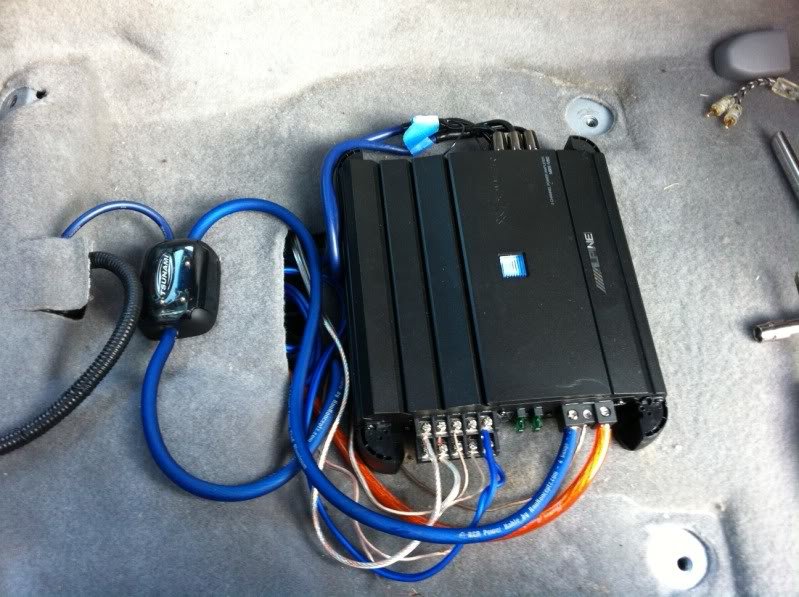

    If you have the amps under the seat you have to be focused on the physical dimensions. If the amp has all the wiring on one side that would be ideal, especially if all of the adjustments were on the other side. Once you pull the seats you will realize that there is already a perfect channel through which to run all the wires just to the front of where the amp will go, just behind the forward attachment point for the seat itself. This way you could have the wiring coming from the amp going directly into that channel, and the controls would be easily accessible from the back seat area.
    The Kenwood XR-4s and XR-1s would make a great setup with a VERY clean install. The only other option that has a small form factor AND the same wiring/control setup is the JL HD series, which gets expensive fast and doesn't have any real advantages (IMO) over the XR series.
    If you purchase an amp with wiring on two sides you will end up with something like I have in the pictures below. I have since cleaned it up some, but I still didn't have the space vertically to comfortably run all of the wiring directly under the amp, which would have been my first choice. The picture does show you the channel I mentioned.
