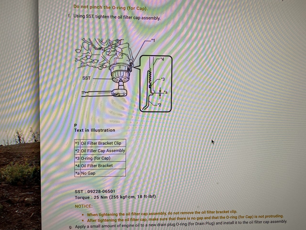

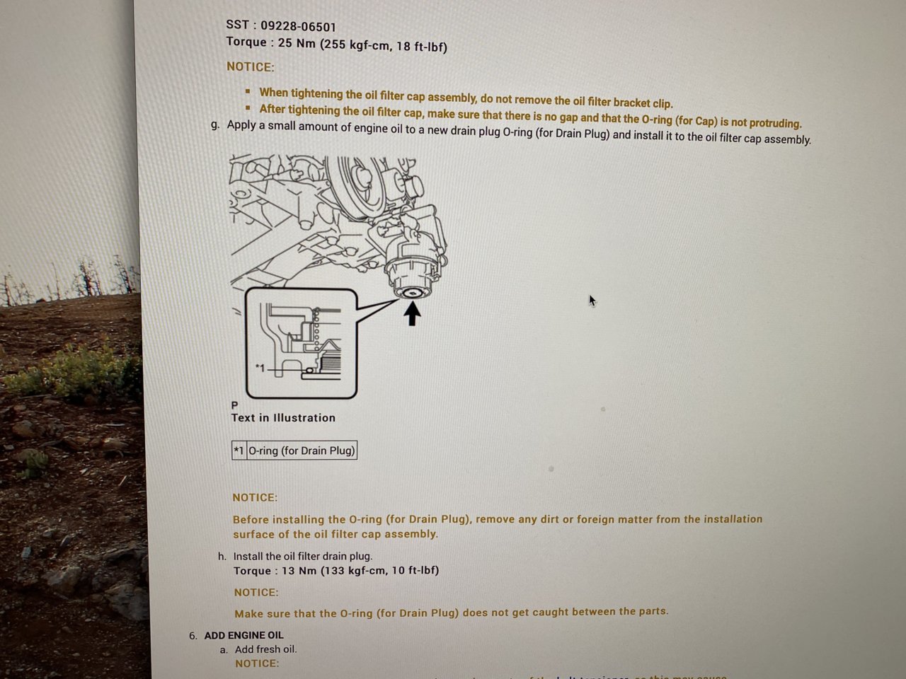

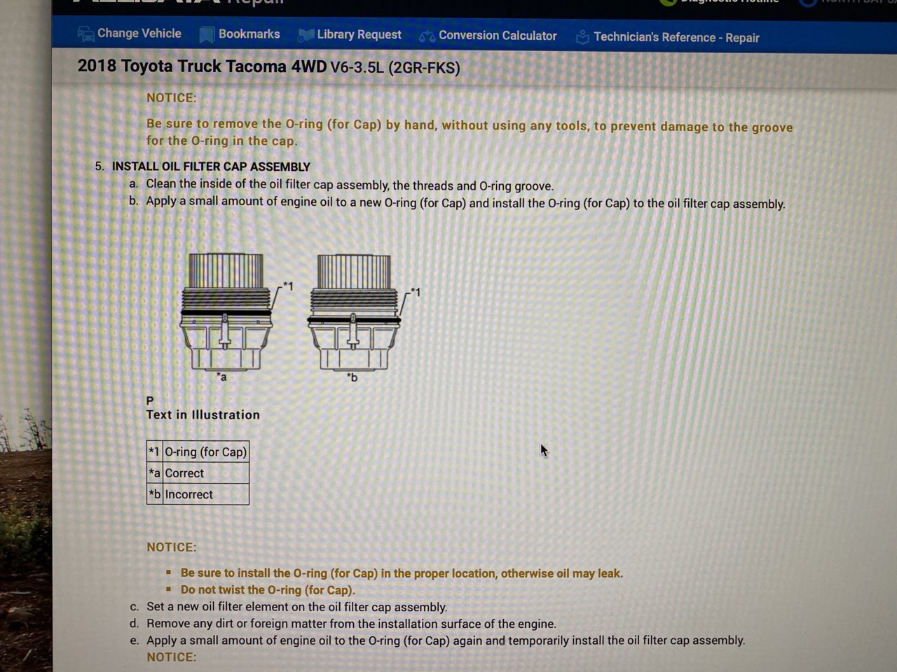

    Hope these help!

    For what ever reason people think they need to tighten filters on vehicle extremely tight. On some it can case more harm than good. Ive seen oil filter seals fail to seat properly due to being on so tight. Most spin ons are 1/4 to 1/2 turn after the seal meets the housing. For these just use the provided torque spec to make life easier on your next oil change.

    I've installed the oil ring on the wrong "groove" and had a leak just like yours (this was on the plastic one.) FWIW, I have an aluminum with no issues.
