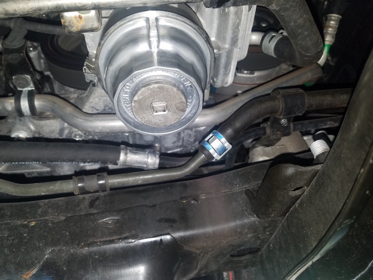

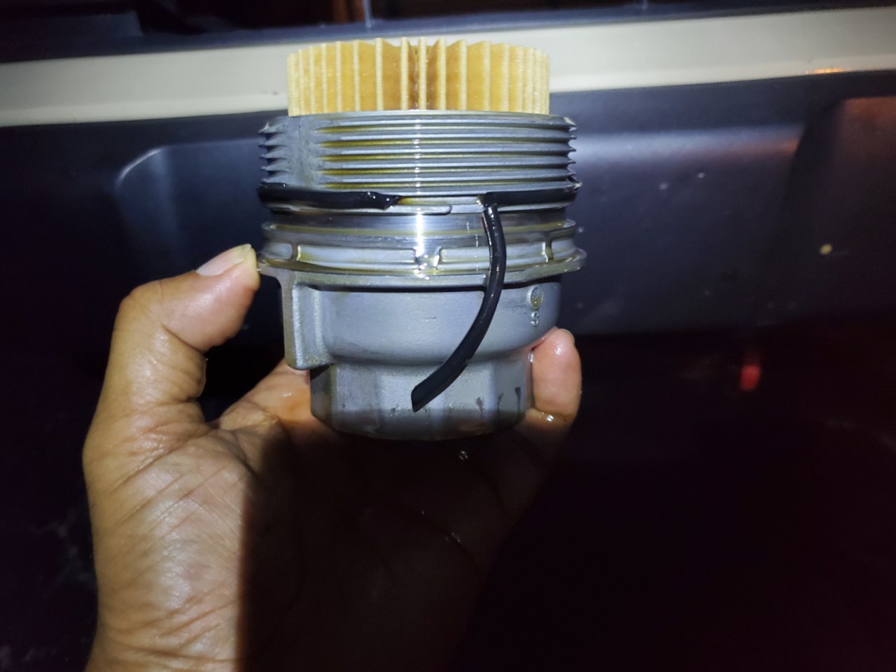

    JUST DO IT!!! I replaced the plastic one with the aluminum one in both my taco and the wife's highlander. Zero leaks or any other issues. OP probably installed the O ring in the wrong groove.

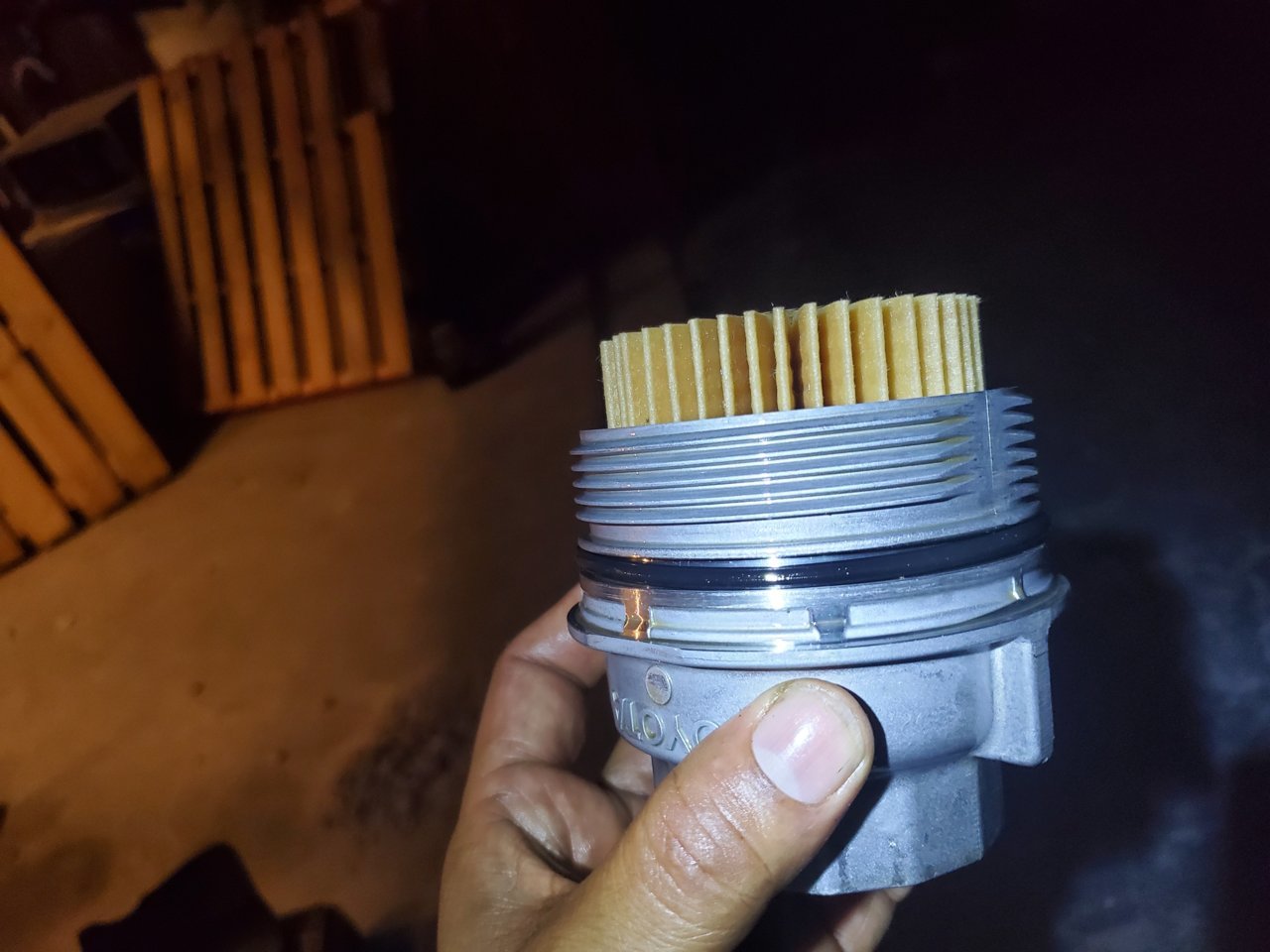

    Correct. I'm a little sheepish about my mistake. I did put the oring on the wrong groove! It can be easy to make the mistake because the end of the grooves have a large gap. Rookie mistake from someone who has done in depth mechanical work, little pissed about that but hopefully my post avoids someone making the same mistake.
    Properly it should look like this.

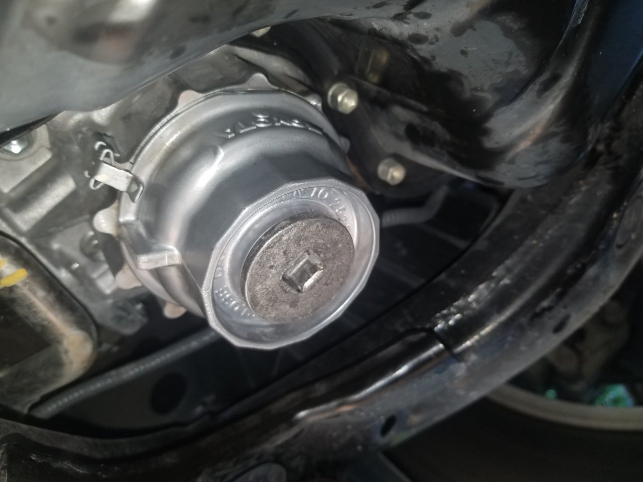

    When putting it on, the aluminum case is better designed in that, you can hand tighten it all the way because of larger wings on the housing making it easier to grip. I did not use a wrench because hand tightening was tight enough .
    Finished 30 miles and not a drop of oil.
    Scary lesson but in conclusion the aluminum was not the problem but an over zealous yours truly.
