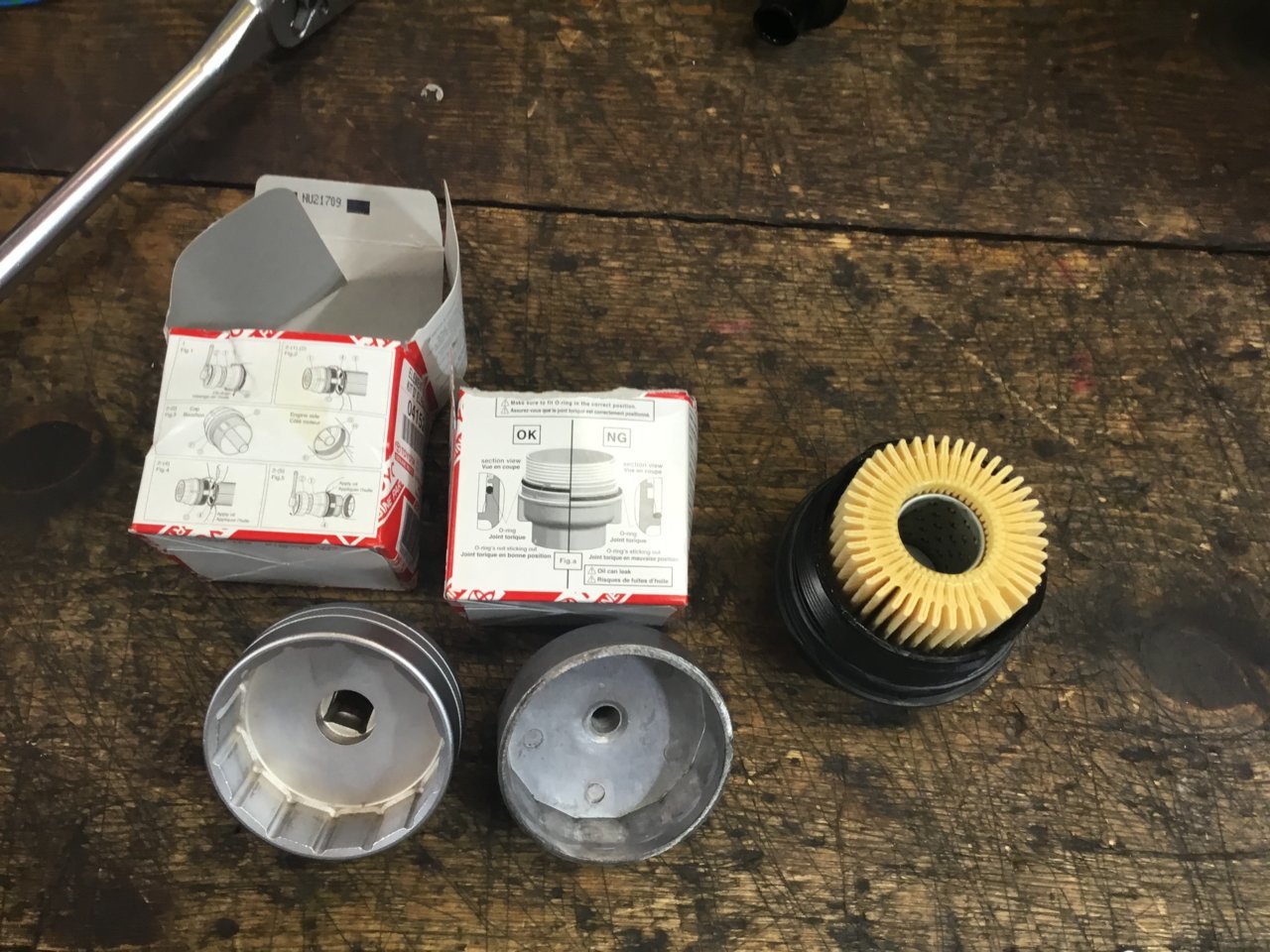

    The canisters have been around going on 10 plus years now and if you treat it like a spin on filter you’ll have problems, the main problem seems to be over tightening. We bought a new Toyota in 2014 and the canister was so tight from the factory I ruined the housing trying to get it off. The dealer provided 3 free oil changes and they did the same thing, over tightened.
    Since 2015 I’ve done all the oil changes at 5k mile intervals using the composite canister housing and never had a leak. I buy the filters in bulk from Toyota dealer in Florida via Amazon and if you look you see information right on the box concerning installation. Also notice I’ve got 2 wrenches the one on the left is Snap On / Blue Point and the right is a shitty 5 dollar pot metal wannabe. The one on the left was purchased used from eBay and it fits much better. Proper tooling really does makes jobs go easier. The cheapie was in use when I broke housing doing that first change.
    run it all the way down and just a little snug that’s it don’t over tighten. I’ve got 115k miles on it now and no leaks.
