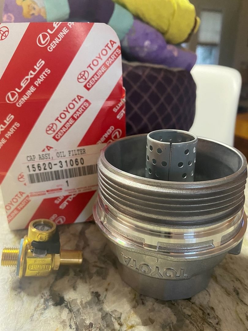

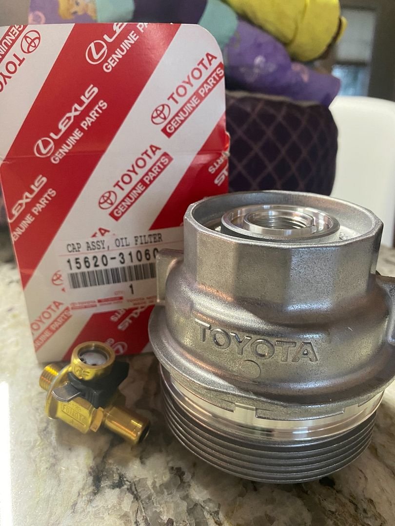

    I'll be installing the same Aluminum Oil Filter Cap on my next oil change in May of this year. I'll be sure to put the o-ring in the same spot as the plastic.
    The tower looking thing will be swapped with the one from the plastic one.
    I'll also be adding the fumoto valve.

    Be careful when you swap the center tube I e heard there can be issues with that
    Your not supposed to remove it . Although when you look at it it doesn’t see. Like it would pose a problem

    The spring action that holds it in-place is like a twist-off; not that difficult to change out.
    At least, that's what I did when I tested out the swap...then put it back in the plastic filter cap.
