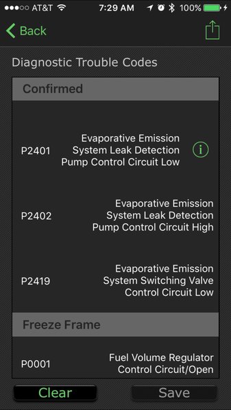

    Gents,
    Think I have a similar but before I go replacing expensive parts I wanted your thoughts. Attached is a snapshot of my error codes

    Well if you overfill your gas tank by clicking it multiple times to force more gas in you can mess up the carbon canister happen to me doing the frame replacement they tilted my truck to far with a full tank of gas and caused the same condition still fighting Toyota trying to get the to fix it. 500 dollar plus part.
    This causes the engine light to come on after resets in the 300 plus mile range. Small emissions code.

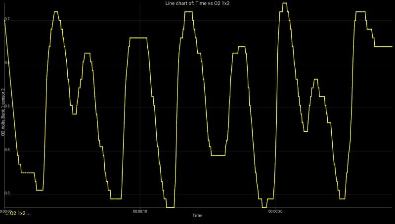

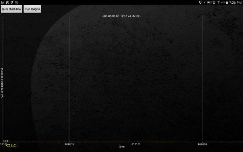

    I am getting a P0158 code as well! I just replaced both downstream o2 sensors, ignition coils, and spark plugs (used all denso oem parts). I checked the resistance across the o2 sensors and they read around 16 ohms at 90 degrees Fahrenheit(means they're good). I logged both downstream o2 sensors and found out that sensor corresponding to bank one would have a voltage that varies. o2 sensor correspding to bank 2 holds at a constant voltage (around .9 volts)I will post pictures to show this. Does anyone know where else I should go from here as far as diagnosing goes? goodCircuitbank1.jpg BadBank2.jpg
