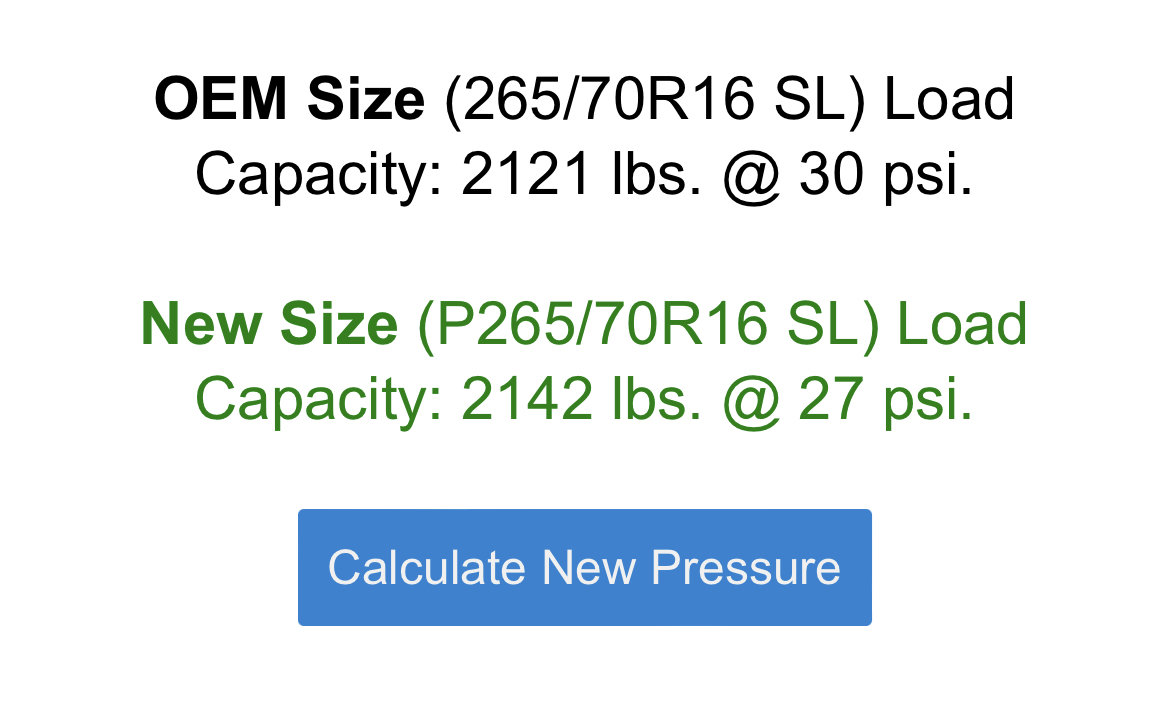

    Okay, dropped all four Wildpeaks down to 27 lbs. Forgot to push the little reset button under the dash so on my first trip out the TPMS said that all four were at 28lbs., but both rear were under-inflated. Kind of strange. Anyway I reset the system and it showed no numbers in the DIC for a while, but after a few miles they all popped back up at 28lbs. Re-checked them last night when they were cold, took out a pound each so they should be good to go.
    It seemed like they rode a little smoother but the road noise was about the same. It might have been my imagination but they seemed to "drift" left/right a tiny bit now, as if they were somewhat squishy. Might have been the grooves in the freeway though. They're terrible here from folks running studded tires. Causes more road noise too.
    So time will tell. So far they ride well, handle well, don't bounce or vibrate. The road noise is slightly annoying, but I replaced the door and dash speakers with some nice ones from DS18 and Infinity a couple of weeks ago so I can turn up the tunes a bit. :headbang:

    I'm confused. I don't see P265/70R16 as an available size on the Falken website and the sidewalls of mine do not say P265.
    According to the pics I have of my old tires, the stock Goodyears and the Wildpeaks are both 265/70R16 112T, so I'm still running 30PSI.
    I've not experienced any issues whatsoever thus far.

    Well damn, you are correct. I should have noticed that when the 112T didn’t match the 111 on the P portion of the tire pressure website. I called them P’s because discount tire’s website listed them that way. I should have checked Falken and TireRack.
    So, @TRDRed, the factory pressure of 30 psi is correct after all. My bad!

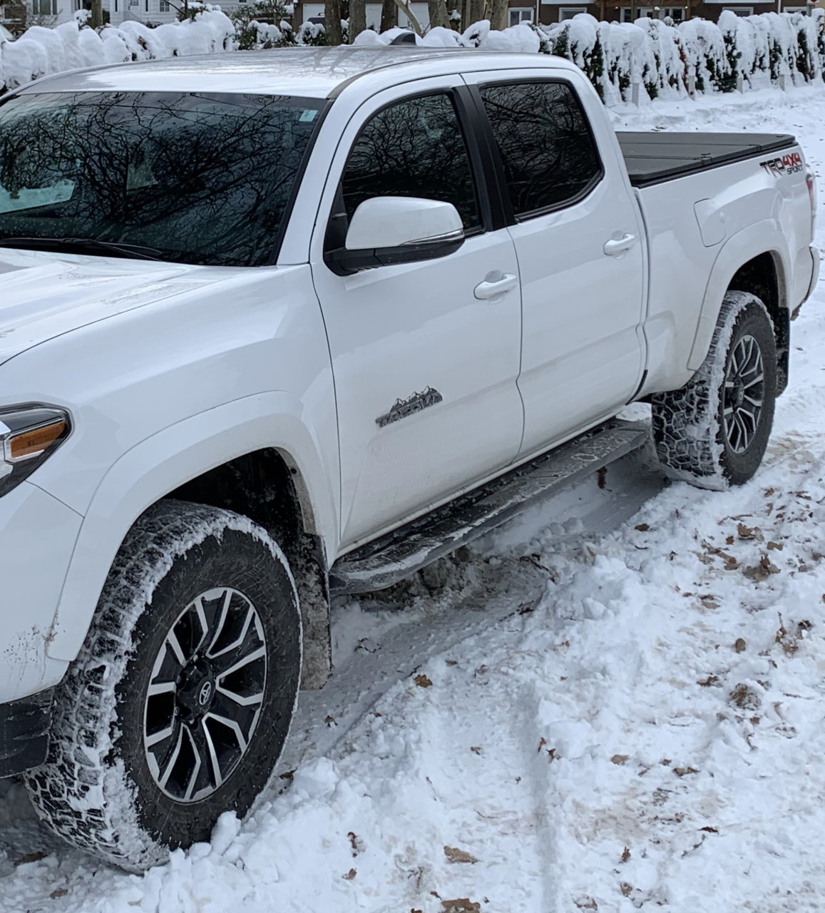

    Very subjective subject. It was a choice between Michelin Defenders or the Toyo AT3’s. Never had an A/T tire before so I chose the Toyo’s one size up from stock.
    It’s been 1.5 years so far and have been very happy. Long, Hot sunny road trips, Atmospheric Rivers, back country exploring and winter snow storms.
    I would buy them again at this point.

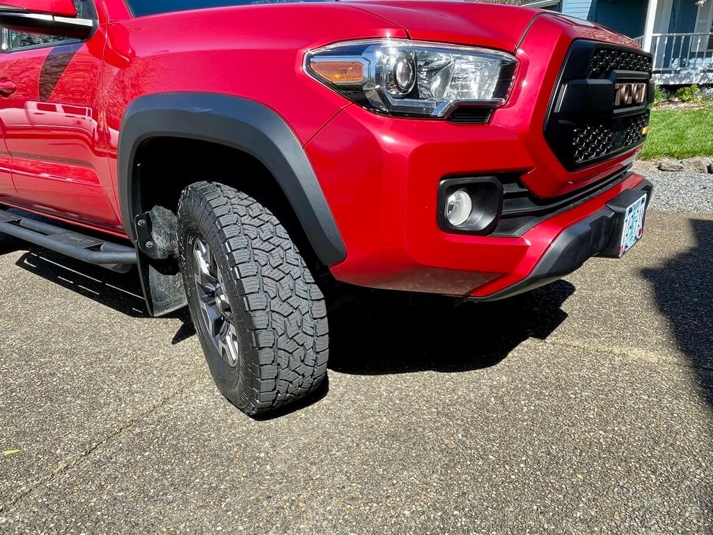

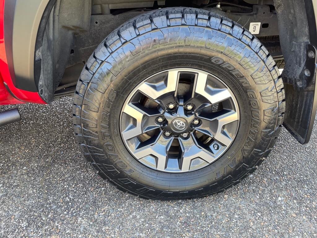

    Quick follow-up to my earlier post about the vibration issues I was having with the Falken Wildpeaks I recently installed. Discount Tire to the rescue. I contacted Jordan here on the forum and he arranged for me to take it back to our local outlet and exchange them for Toyo Open Country AT3s.
    After driving on the streets and freeways, dry pavement and in the rain, I have to say they are MUCH better! :thumbsup: Little to no vibration at any speed and as smooth as I'd expect any AT tire to be.
    A number of folks here and elsewhere have had zero problems with their Falkens. However a number have and some described what I encountered... just an annoying buzz/rumble/vibration. Not the kind you get when one tire is out of balance, but just an overall rough ride.
    When they were about done installing them, the tech came to me and said that they checked the road force balance on the Falkens and they were all in the 25 to 30 lb. range. He said that might have been okay on some vehicles, but not the Tacoma. By comparison he said all of the Toyos were in the 7 to 11 lb. range. So he said that it wasn't just my imagination and that they were happy to be sure that I was taken care of.
