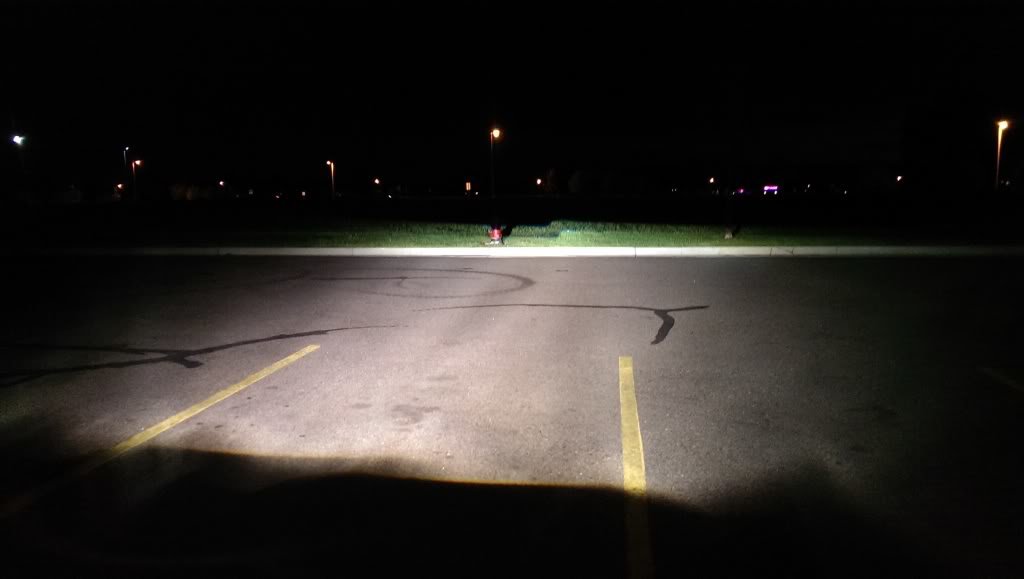

    Remember, the stock headlights out there that look yellow are halogen. Their color temp is lower... between 3500k and 4000k.
    Here's my Phillips D2S...

    I'm with rich.
    Don't fall into the hype.
    High dollar OEM systems use Philips 4300k for a reason.
    Blue from a real hid projector setup with 4300k is an artifact of the projector alone, not the bulbs. On an OEM setup, u only see blue when the vehicle is coming towards u if ur below the cutoff. This blue is the color band, as the vehicle gets closer to an object, the colorband becomes thin and just along the top of the light output. Further away and the band gets wider just because of the optics.
    Hid and halogen manufacturers who want to sell products based on hype and the bling factor offer blue bulbs. Philips has a standard that OEMS prefer and they want more usable light that is less irritating to the human eye, and that's why they don't use blue. Its irritating to the human eye.
    Besides, the higher in kelvin, the dimmer they get.
