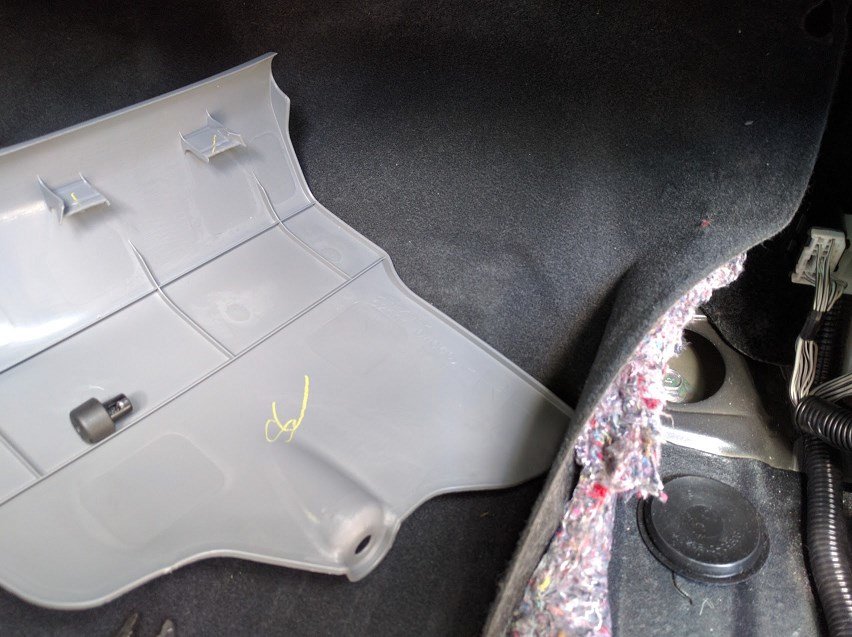

    I have a seemingly stupid suggestion, but check your body mounts.
    I had a similar maddening clunk about a year ago and could not for the life of me figure the shit out. Usually only on bumps at slower speeds (like pulling into a driveway with a steep curb). I gave up and then weeks later accidentally found it to be the front passenger side body mount. The nut underneath had backed off significantly but the bolt had just enough gunk on it to keep the nut held on there. I could push the bolt up and down with about a 1/2" of play. Looked up the torque spec, tightened it, and the clunk disappeared.

    Is this what you're talking about, and the bolt is accessed from underneath the truck? Gonna try the same on mine

    YES! Exactly
    I was changing my oil...stupidly, impatiently...with the engine still hot. Dropped the drain plug, oil all warm and runny as hell, splashed all over the place, all over me, my face and head specifically. I recoiled and squirmed, obviously, bashing my head. Did the whole Peter Griffin "AHHH...hhssss...AHHHHHH...hhssss...AHHH" thing. Came to my senses, grabbed the box of towels I thankfully set within arms reach and wiped myself down. Still laying under the truck, contemplating my mistakes in life, I finally open my eyes, look up right in front of my face and notice that nut and washer look to be threaded too far down toward the end of the bolt. Go to jiggle it...sure enough. Loose as hell. That's the godforsaken noise I couldn't find.
    Thank god I'm an idiot who sucks at things as basic as an oil change, otherwise I never would've found it

    I had a popping issue not too long ago in my 14' Tacoma. Long story short, it was my body mount. I never would've thought that being only a few years old. Replaced the drivers side and sound went away. I diagnosed it with the chassis ear my mechanic had. He said he had it for years and I was the first person he used it on, haha. It worked.
