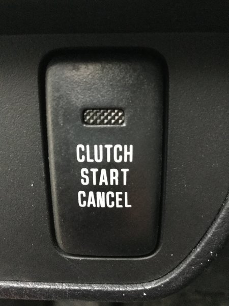

    I have a 2017 Tacoma SR 4cyl,4x4. 5spd. access cab. I need your help understanding the purpose or function of this switch.
    CLUTCH
    START
    CANCEL
    Thank you.

    Allows you to crawl forward while turning the key using the starter.

    It really just allows you to start the truck without depressing the clutch. Yes, you can also rock crawl out of a sticky spot with the starter but... mostly... just very convenient for not climbing in to start it while you brush the snow off, or are working on it in greasy clothes.

    the button works so you dont have to push the clutch in to start the vehicle, just make sure its out of gear before you use it.
    My 2000 you have to push the clutch all the way to the floor to get the lower microswitch to realize that the clutch is pushed in. and sometimes I dont feel like jumping all the way in the vehicle just to start it.
