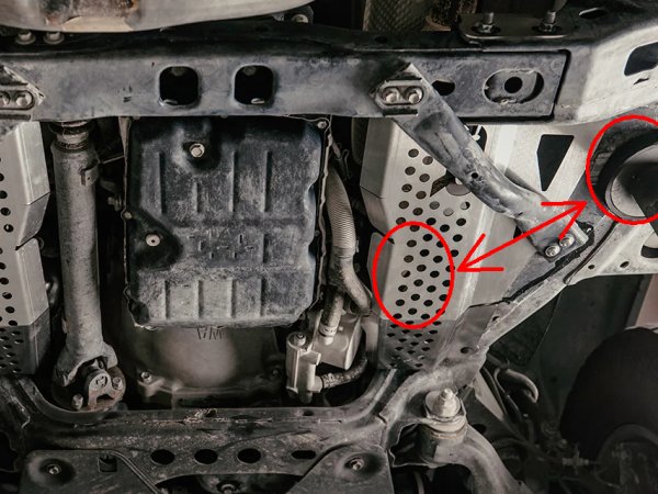

    when did you purchase your cat shields? if those are the caliraised v1, you should contact them (or just have the shop buy you a new set) becasue the v2 are redesigned and no longer contact the cat. I had v1 and they rubbed a hole in the cat heat shield on the passenger side. I contacted caliraised after seeing users on here post about it, they sent me a v2 set for free.

    In the pictures it appears to be 2 rubber coolant hoses going to a transmission oil cooler (the cylinder shaped thing). They swung the rack arms too far under the truck, pushed the cat shield up into the rubber hoses and split one of them open.
    Or if it was a center post lift they didnt get the rack arm under the frame rail correctly

    Even though its a shitty situation to be in, that actually seems like best case scenario. Just looking at that pic Id say those hoses are probably the only damaged items. (and the cat shield itself)
    Hopefully the dealer will give it a thorough look over and make sure no damage to the transmission pan, cat itself, exhaust piping, or anything else in the area

    That's a pretty impressive fuckup on Discount Tire's technician. Where they put the lift arm vs. where they should be putting the lift arm (photo from Caliraised):

    As everyone should know at this point, that cooler hose got pinched between the jack head & the cat shield, puncturing it...

    Final diagnostic they damaged the cooler hoses and transmission cooler. Cat was unharmed.

    And the shield
