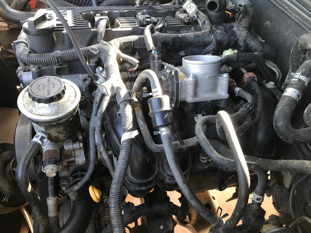

    I know you said you smell fuel, but make sure the two fuel lines with the orange connectors on the right side of the picture are not reversed by accident.
    TnShooter likes this.

    Just went outside and checked that
    They in the right location. Last night I scanned and I had a crankshaft position sensor code should I check that?
