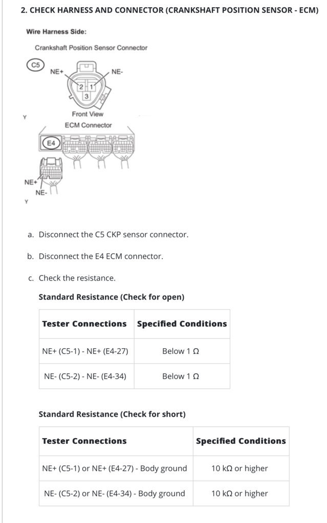

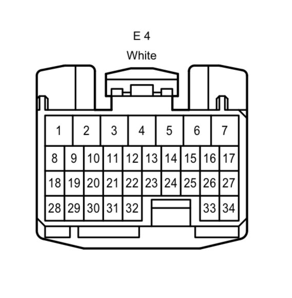

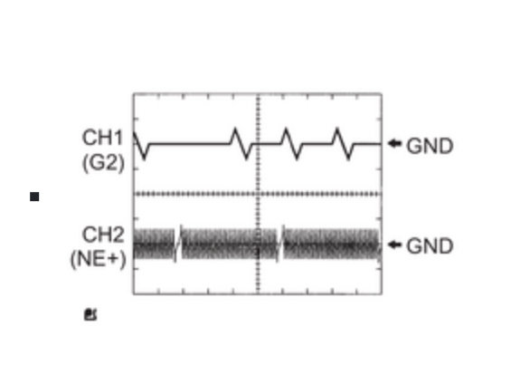

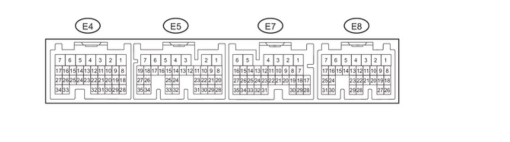

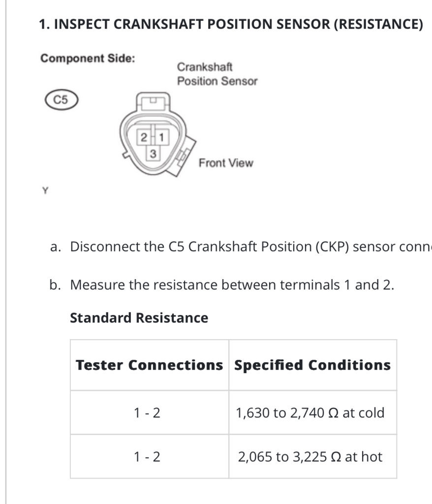

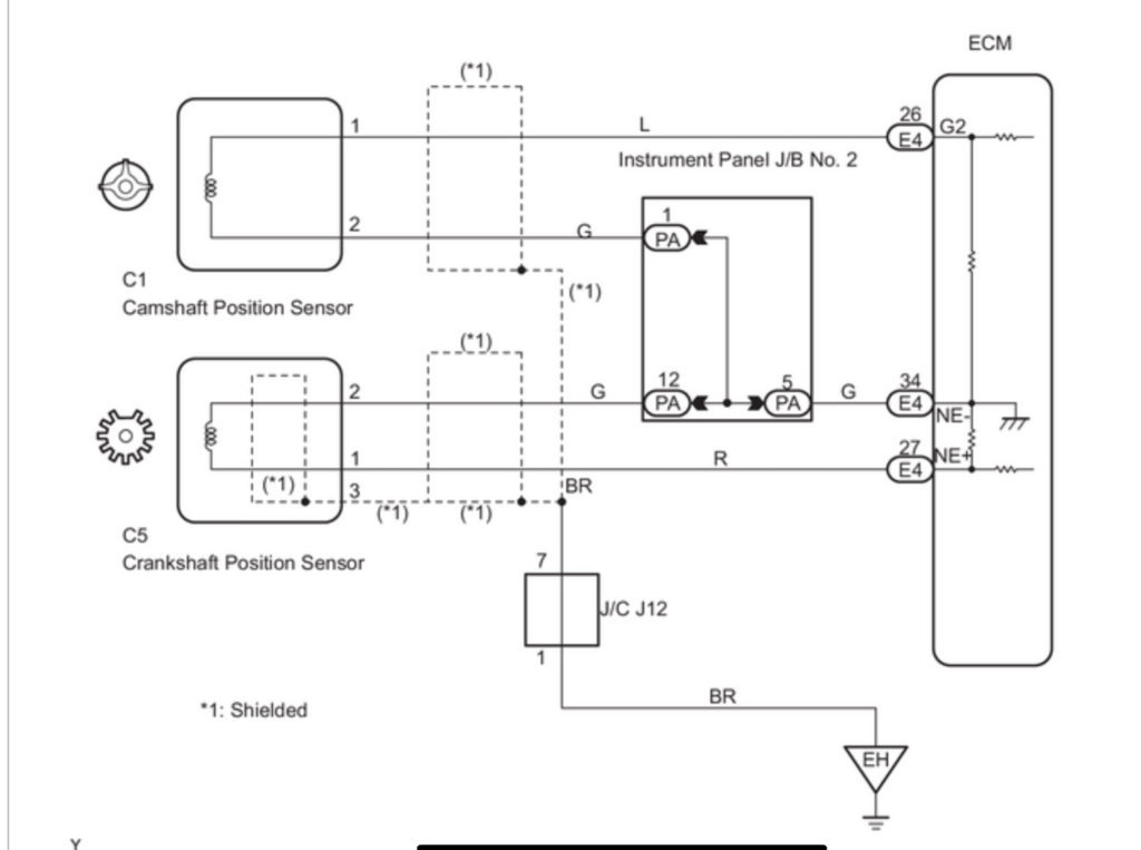

    All it does is pick up a magnet field form the crank.
    Diag for who ever what’s to check stuff.
    IMG_0356.jpg IMG_0357.jpg IMG_0358.jpg IMG_0359.jpg IMG_0360.jpg IMG_0361.jpg IMG_0362.jpg

    Yeah.
    Did you check the harness and connector from the sensor to the ECM like in the diagrams? Fuses and relays good?

    I'd unplug the crank sensor.
    Then place a jumper wire between pins 1 and 2.
    Next unplug the ECM E4 connector) and see if you have continuity between pin 27 and 34.
    If you DO have contenuity, plug the crank sensor back in.
    Then check the resistance between pin 27 and 34 on ECM (E4 connector)
    It should read between 1600-2800 oms on a cold engine.
