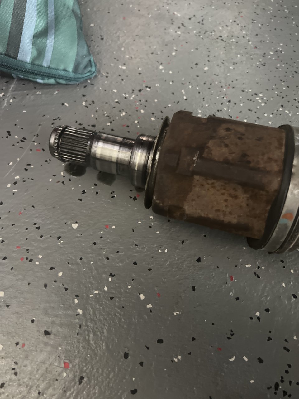

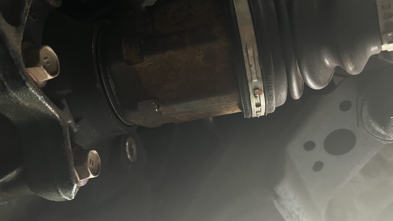

    Dudes (& dudettes where applicable), any tips on removing the left axle? This thing is the immovable object and I feel like I have come at it with the irresistible force.
    So far I have pried with a giant pry bar and used a punch on the (very small/short) tabs - also tapped semi-aggressively on the heavy portion of the inner portion of the axle.

    Those flat spots, you need to put something on like a chisel and tap it.
    Turn your cv axle, and tap another end.
    Rinse and repeat.

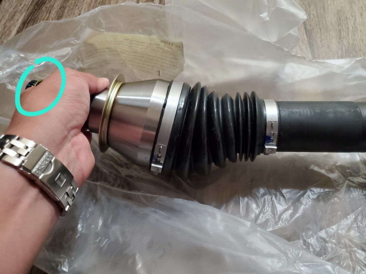

    I dont know if this is true for 3rd Gens, but older models have a sort of "ring/clip" that pops into place. You're trying to knock that over to remove the cv axle hence why it takes a little force.
    Once you get it off, make sure you check your cv axle to ensure that clip came off with it. If not, look inside where your cv axle goes and get it out with a magnet or something.

    yes, been doing that - those are the tabs that I was speaking of. I’ll keep going. Maybe a bigger hammer!?

    This is what you're fighting against -
    Again, maybe...I don't know 3rd Gen Tacoma's.

    Got it! Thanks! I had my son use the pry bar while I tapped - came right out.
