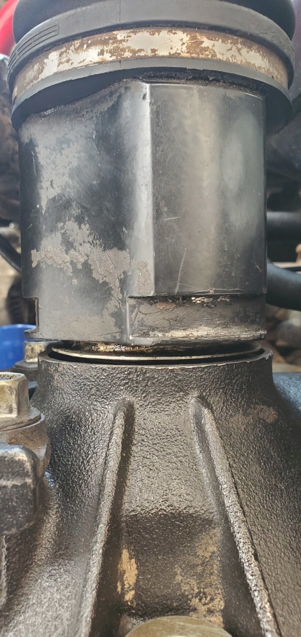

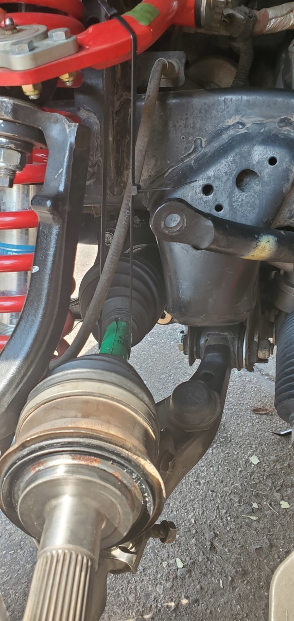

    Just got my differentials regeared and stuck on the installation.. My driver side CV axle won't fully insert into the front clamshell... It will insert smoothly, but gets stuck on the last 1/4" or so... Ive tried messing with the snap ring to fit tighter in the groove and I also have the weight of the cv axle supported go the UCA via zipties..
    Anyone had this problem or any tips?

    Another pic

    How much did you have to force it in? Ive been trying to hammer it in with no luck. Thats why I gave up and tried messing with the snap ring. I also stuck my finger in the diff and haven't felt any burrs..

    That gap looks just about normal to me, might be able to go in a little further. If its leaking gear oil then you'll know it's not enough, rotate the axle a few times to see.
    Either hammer it with a pry bar on the indentations in the axle housing or thread the axle nut onto the end and hammer it in by hitting the axle nut.

    That looks fully seated to me. Are you not feeling the snap ring setting into place?

    I'd also agree that gap 1/4" or less is fairly "normal". My driver side has a gap and my passenger side does not. If it where me I'd just finish putting the front together and drive it. Test 4wd on gravel/dirt. If that works, which it will, go ahead and keep on eye on the diff for leaks. The seal sits inboard so that gap really has no affect on it leaking or not.
