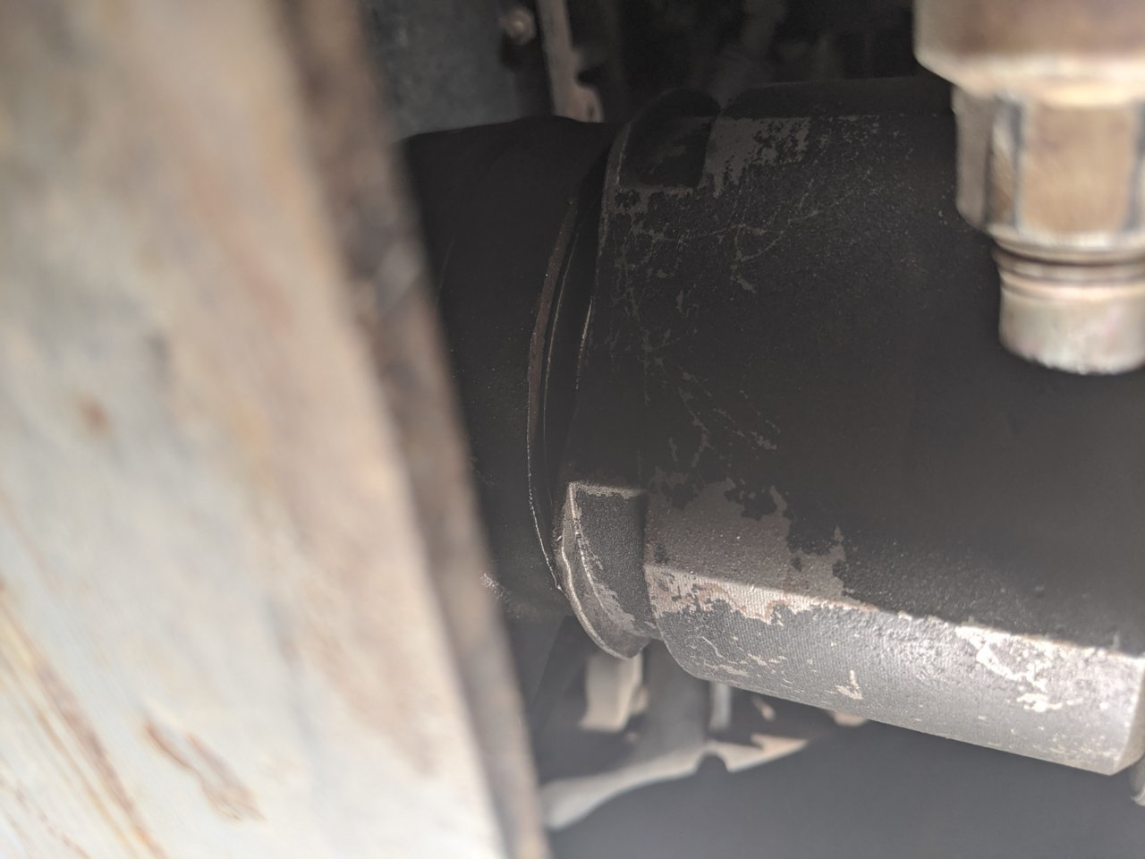

    I cant feel shit. My hands are numb from hammering on this for 3 hours.. :smash:
    Was there supposed to be a noticeable click into place?

    Not really... You just sort of know that it goes in all the way because once you get past the c clip it slides in easily as far in as its supposed to go.
    The only other thing I can think would prevent it from going all the way in is if your axle seal isn't seated in all the way, but if you didn't replace the seal that shouldn't be an issue

    Is there anyway to test that this is okay besides driving it? I'm scared I'll lose an axle while driving a ruin the wheel bearing.
    Thank you all for the help. Im seriously questioning my wrenching abilities right now..

    There's no click. It's either seated or not. Try it the other way. Gently pull on the inner cv cup and see if you can remove it. It should take a good bit of force to get it loose.

    You won't ruin the wheel bearing as long as the other end going into the hub is properly tightened down with the axle nut and torqued to 173 ft/lbs
    You'll know if the axle isn't all the way in the diff if you see gear oil leaking out from the gap. But honestly it looks like it's far enough in to me. There's always a small gap there and there is always some wiggle play in the axle there.

    It slid in smoothly up until where its shown in the pic. After that it feels like I ran into a brick wall. No movement inward whatsoever. I could have sworn they were flush with the diff when I removed them tho...

    They are never flush with the diff. There is always a gap

    Here's a pic of mine... This is a normal gap

    Yes, I've taken this in and out a bunch of times now. On the way out, there is a bit of resistance at first and then the CV will pop free. I simply pry on it and then it slides freely by hand.
    On the way in it needs a little convincing with a mallet but goes in very smoothly until that point. Playing with the c-clip made this part very smooth.

    To me that CV axle looks like it’s in all the way. You don’t want the dust seal to touch the differential housing. If your lower ball joint bolts line up with the holes then the CV axle is for sure all the way in.

    That makes me feel so much better. Thank you @eon_blue

    That's totally normal. Trust me. I have probably replaced more CV's then most. lol
