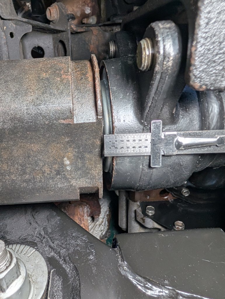

    My passenger side cv axle became harder to turn suddenly as I was installing it, did I drive it in too far? This was not the case on the driver's side. I don't recall this situation last time I had these out.

    Think the answer was yes, something wasn't right. I backed it out and re-installed this time with no hammer assist. Axle is still spinning without much resistance now. Gap seems alright?
