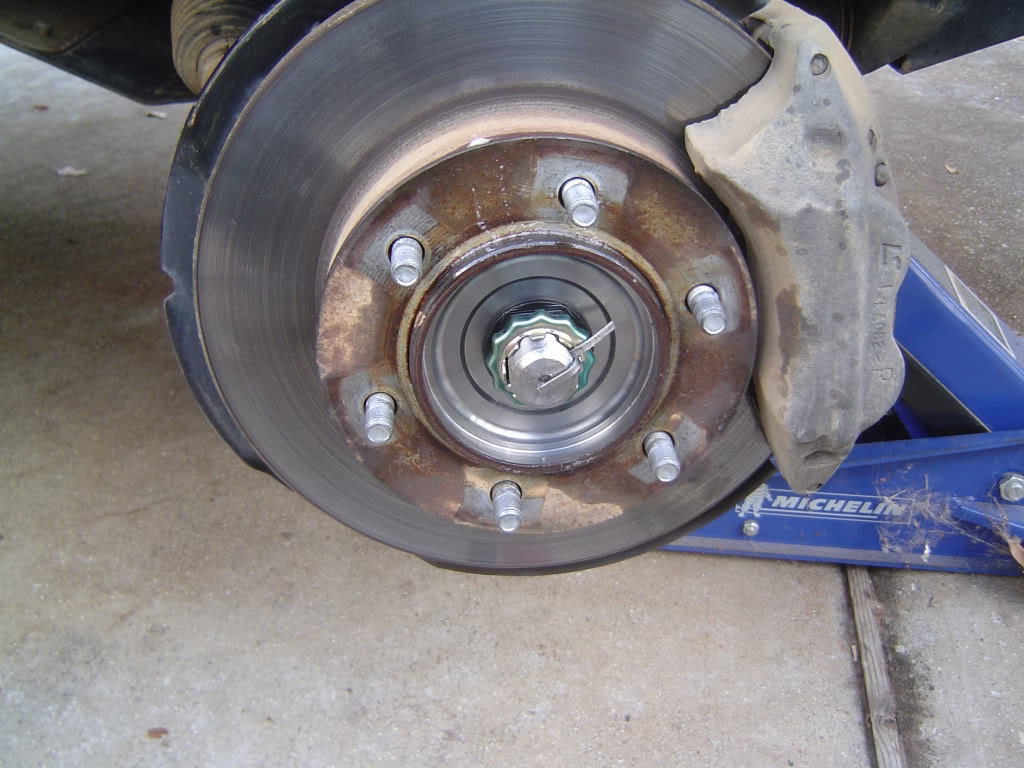

  3. May 22, 2021 at 8:49 PM
    #23
    Taco-Obsessed
    Dec 23, 2018
    #276756
    7,448

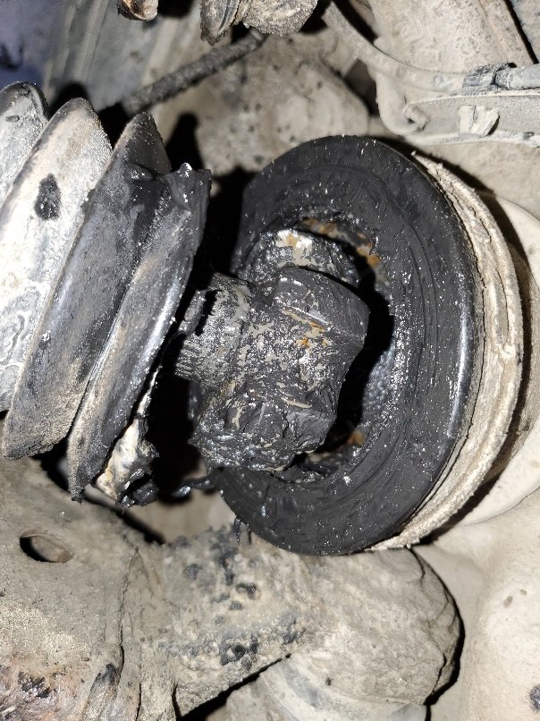

    Posted photos for you to understand what folks were speaking too, but seeing your photo, that is not the issue. Don't worry about that axle nut.

    What is my issue?

    I'm realizing this cog is part of the CV axle assembly right? So the part that holds the bearing to the hub is still probably holding, am I right?

    from the looks of it youre right

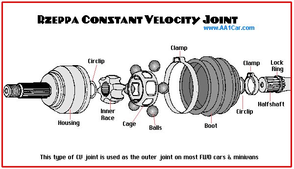

    I found a picture that helps illustrate what happened to me. My "cage" sheared in two somehow. The inner race is just rattling around in the housing now. Since the housing is still there with the axle nut, I should be fine to drive it without losing my bearing and wheel right? Anyone else think so?

    Wrong. The bearing is pressed into the hub only and not bolted. You cannot run ADD IFS without a CV shaft. This is why the axle nut is present with a cotter pin for safety. It appears that the CV joint is just fooked up. A bad CV clicking and popping is better than nothing. Do not remove the CV and try to drive without it or you will separate the hub from the bearing and wheel will fall off.

    That inner race takes a significant amount of force to remove. If the cage is broken or it has popped the circlip then it is out. It would not exceed 10-15mph like that.

    By remove the CV you mean the "housing" in that diagram right? That's what holds in the bearing?
  11. May 22, 2021 at 9:12 PM
    #31
    3JOH22A
    3JOH22A トヨタ純正男娼
    Mar 27, 2019
    #288172
    13,237
    District 6ix
    3G Tacoma on 35"s, 5G 4Runner
    Correct. The "housing" keeps the wheel hub clamped to the wheel bearing.

    i mean the whole shaft complete, but your CV is already broken it appears. That cage holds the inner race and it is gone or broken so your CV is effectively already separated in two pieces so your axle nut is worthless at this point.

    His axle nut and the outer cup(housing) are what hold the wheel on. I'd say that axle nut is far far from worthless. lol

    The outer housing is broken from the half shaft. The axle nut isn’t doing anything.
