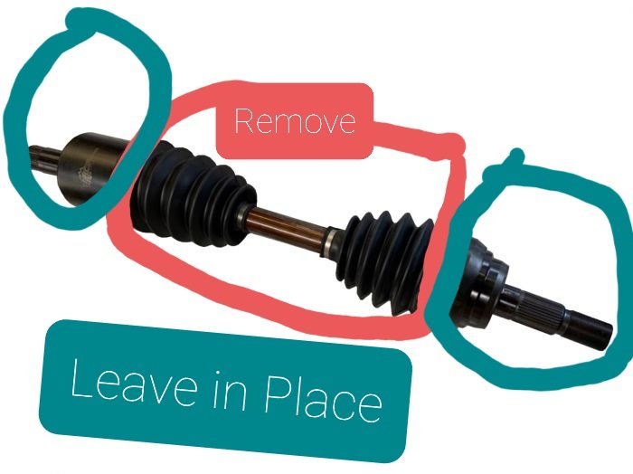

    wait, I see what you are saying now. He could just remove the inner portion of the cv and then keep the outer housing with axle nut on and be okay. I stand corrected. That would work.

    Yes. The wheel will not fall off.
    OP, try this. Turn your wheel hard driver. Push the axle shaft as far inboard as you can get it to go. See if you can get the race to clear the outer cup. If you can just cut the band clamp off the inner boot and you can pull that whole CV shaft and inner tulip out of the cup. If you can get that out you can drive your rig without worrying about the shaft coming loose and damaging brake lines or anything else.

    OP, your axle nut with keep the bearing and hub on even with the cv broken. If the half shaft is bouncing around or banging around then remove the inner portion where the it meets the diff and just keep in 2WD since you will probably leak out all your front diff fluid to get back. @theesotericone is correct in that your outer housing and nut wI’ll prevent the wheel from coming off.

    If he can get the shaft and tulip out the inner cup will remain in the diff. He can drive as fast as he wants without the chance of loosing any gear oil. He can even leave it in 4WD and at least have 3WD. If the 2nd gen inner tulip and cup are like the 1st gen there is no snap ring on that side. The whole tulip will slide right out once the boots loose provided he can clear the outer cage from the outer cup.

    That’s what I was saying you cannot drive without the CV in there I was saying leave the front half of the CV with the axle nut and cotter pin engaged into the hub so it doesn’t fall out. I was saying the wheel wouldn’t fall off assuming that the axle nut was still attached to the hub.

    Put it in a photo in case it helps. Still picturing OP in dark, snow, etc..

    Yea I hope the axle nut didn’t come loose and he just broke the inner joint. You can limp home by the pic you just posted but if that axle nut came loose and you don’t have a 35mm your kinda screwed

    I'm gonna limp home in 2wd today. Shouldn't be a problem as far as roads go. I think I'll leave the inner CV part in, even though it's noisy. I will check on it sometimes but if it stays there it shouldn't hurt anything but the CV itself which will be replaced. Can't tell you how much I appreciate the advice here, means a lot being able to go home with some peace of mind.

    Curious how the limp trip back goes with running it as is and without removing the center shaft.
