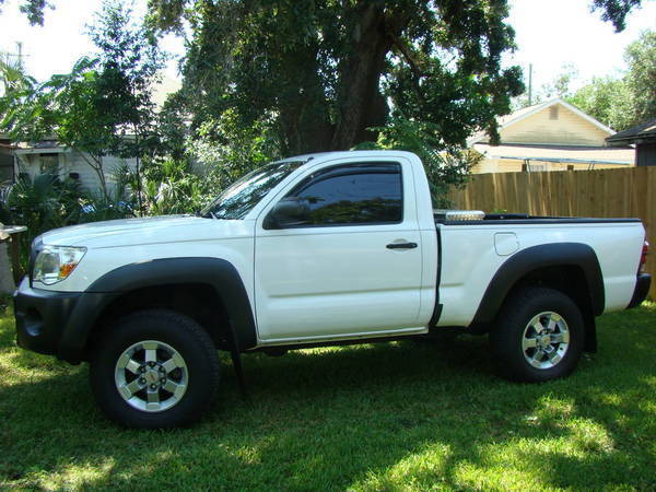

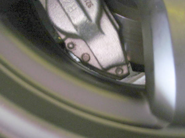

    Clearance with 16" wheels should be very tight, but there is clearance. If the dealer puts stick-on balancing weights on the inside of the wheel instead of the rim lip (to avoid scratching the rim), it could scrape against the caliper.
    My Konig Countersteers:

    Now that you mention it Ken, my SA did say it wouldn't clear with the balancing weights on the inside. Maybe I am SOL.

    So use clip on weights on the rim lip... like how they install weights at the factory.
