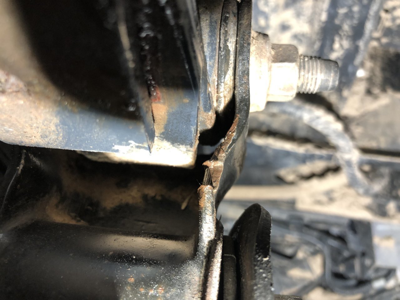

    Sorry for 2nd gen input on a 3G thread, but same as above. Also, there was/is a design flaw with the EL096HD where the top leaf bites into the stock shackles. Definitely not getting these resprung, I ride the dakar train once and get off at the next stop. All aboard the Chevy 63 swap express!!!

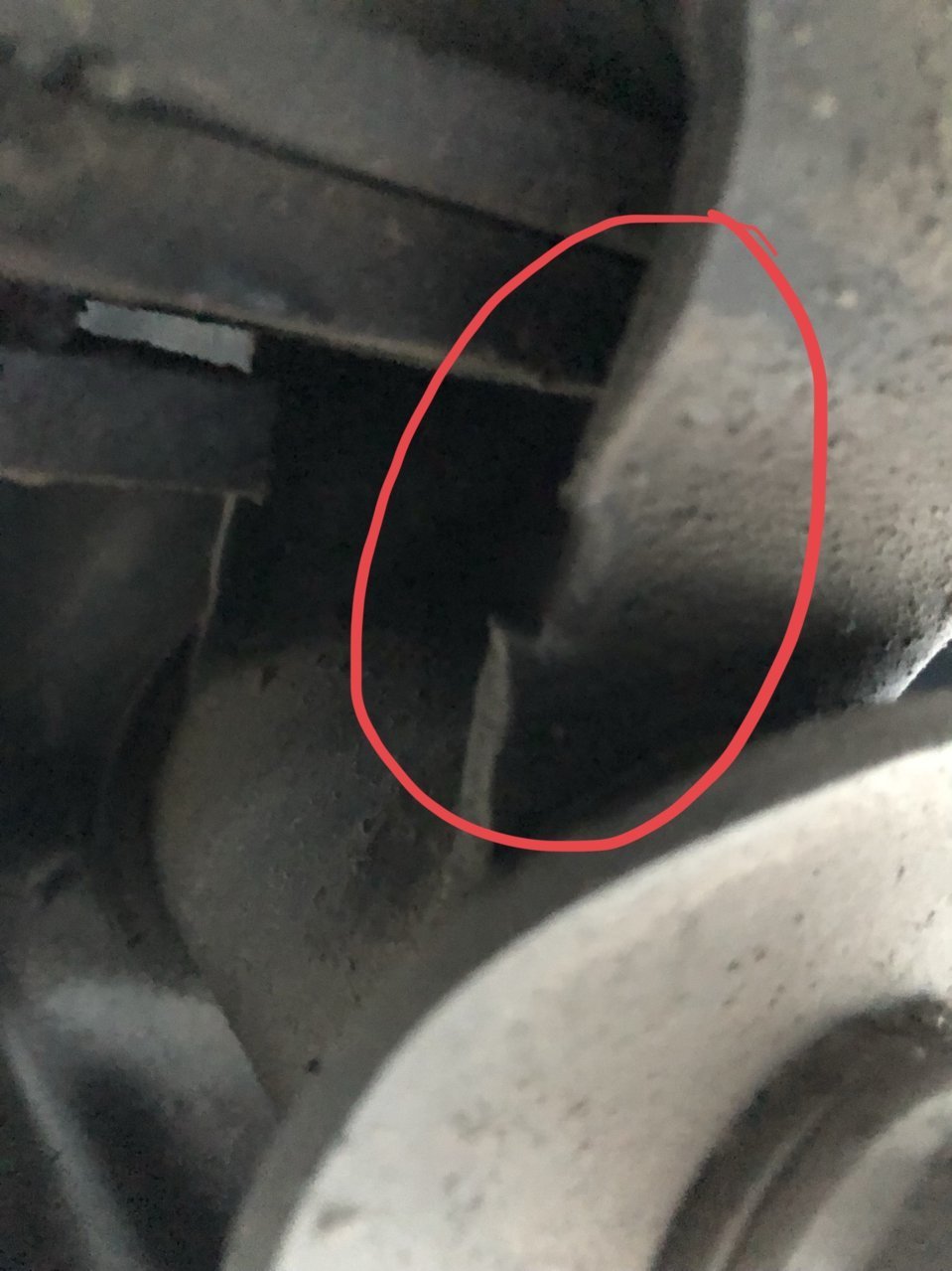

    Don't feel bad, many of us did not expect the performance to be lacking by so much and in the sane boat.
    Though I didn't think there was a fit issue with stock shackles. I thought that was just for the aftermarket ones like BAMF or Archive

    We flexed it pretty good when we were putting them on and while I could see where they rub, that second shackle has been shaved by ARB/whoever makes them. So it's definitely not just a flat leaf impacting the back of the shackle if it hits it all.
