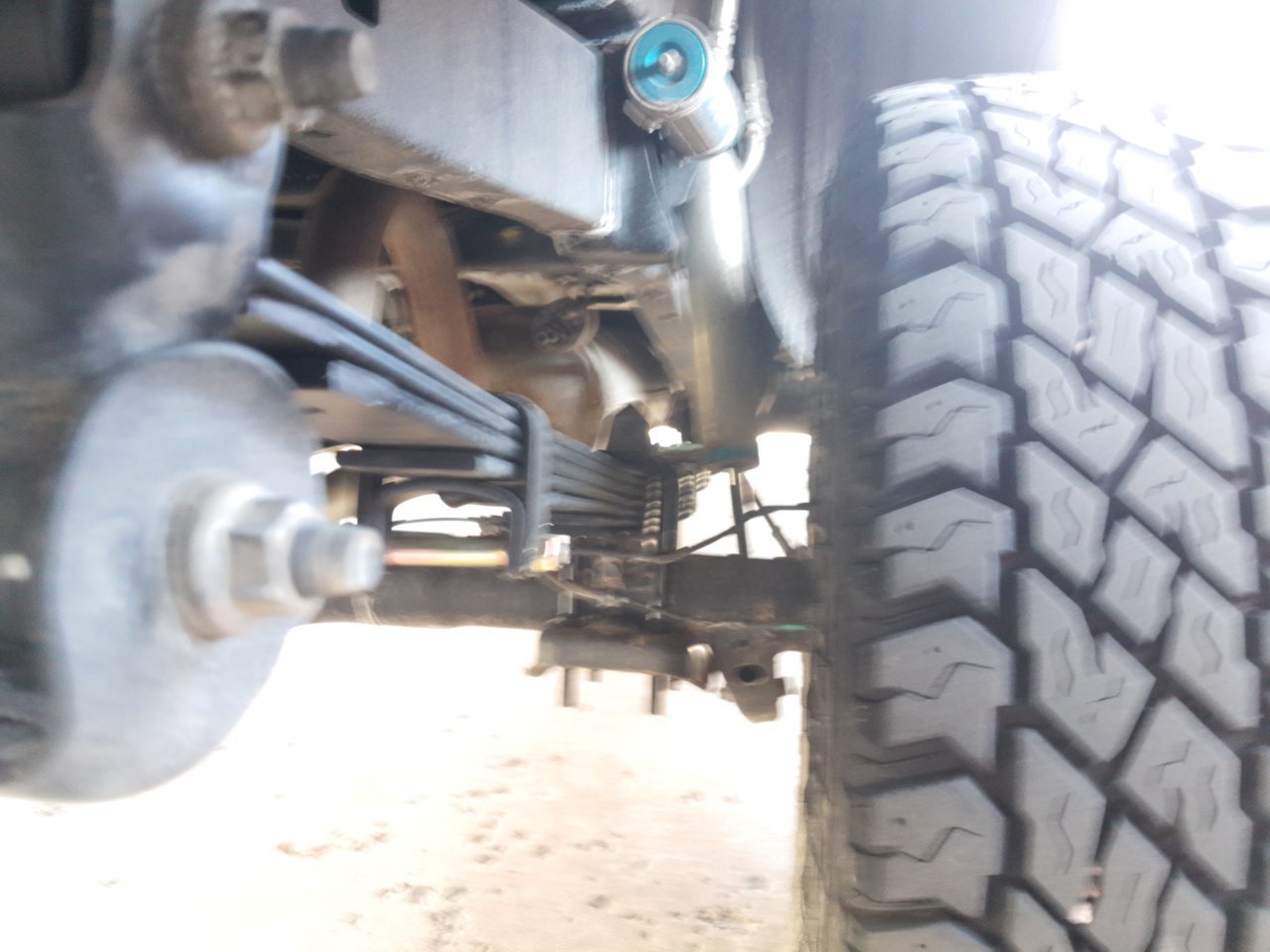

  10. Dec 23, 2020 at 11:16 AM
    #90
    xxTacocaTxx
    xxTacocaTxx Well Unknown Member
    Dec 5, 2017
    #237709
    1,111
    Best Slope CO
    2017 TRD OR DCLB 4x4 OMGWTFLOLBBQ
    RCI skid plates Mobtown sliders Lots of patches and MESO stuff
    The installer took before and after measurements when they installed my dakars. After 8 months I had lost between .75 and 1 inch. Installer went to bat for me with ARB and got them replaced under warranty. I just had them replaced with stage 2 Icon RXT last week.
    Pics from around 8 months after install. Not as bad as others I've seen here, so their number must be even worse than mine.

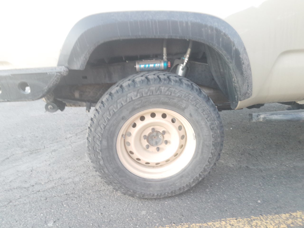

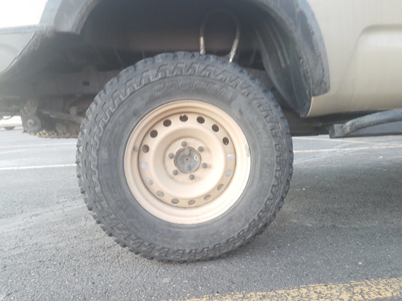

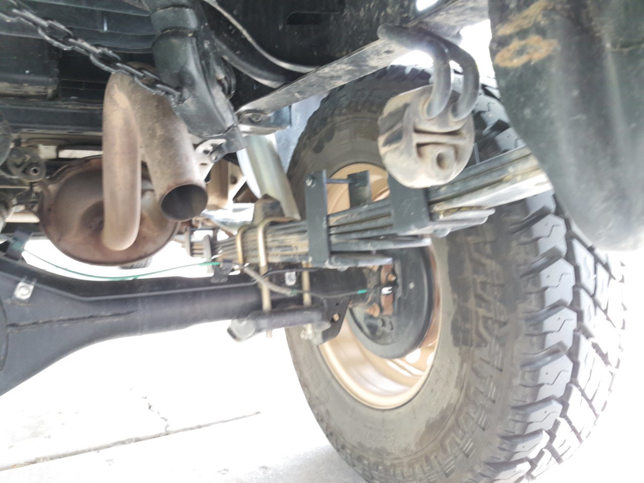

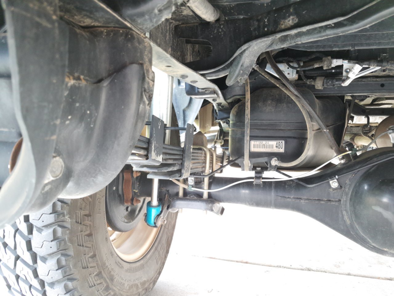

    xxTacocaTxx
    Dec 5, 2017
    #237709
    1,111
    Best Slope CO
    Sorry I don't have the exact same pics to compare, spare tire is in the way. These are all of the right side, but the left is similar. Much less sag after the replacement.
