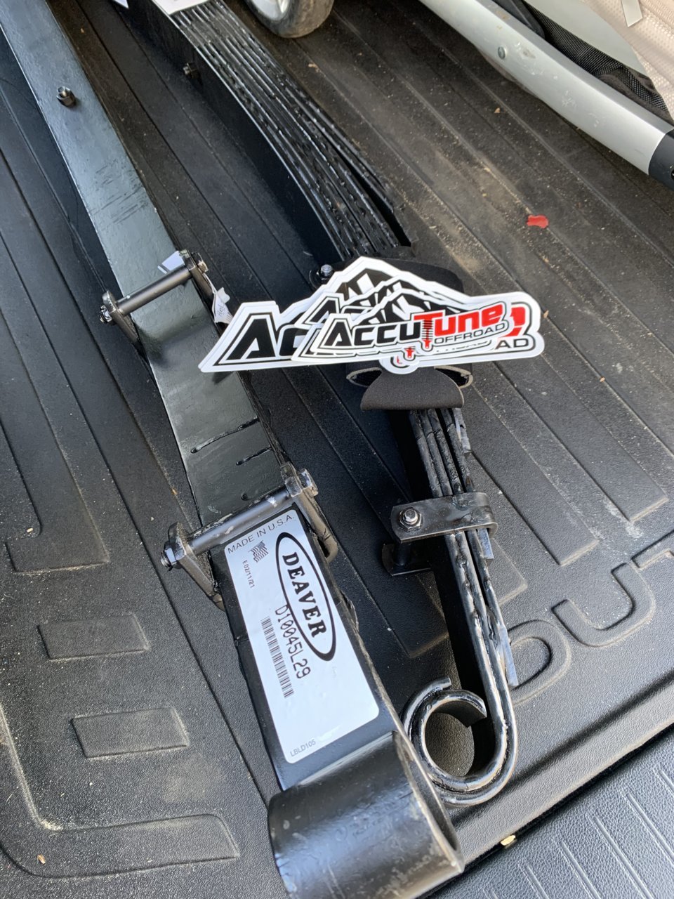

    This is the way. Just waiting for my ubolt flip kit to arrive now. Switching from Dakar’s to Deavers. Thanks to @AccuTune Offroad for their great customer service!

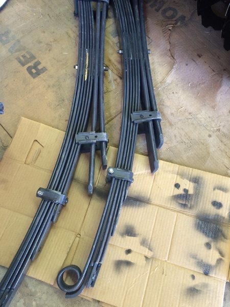

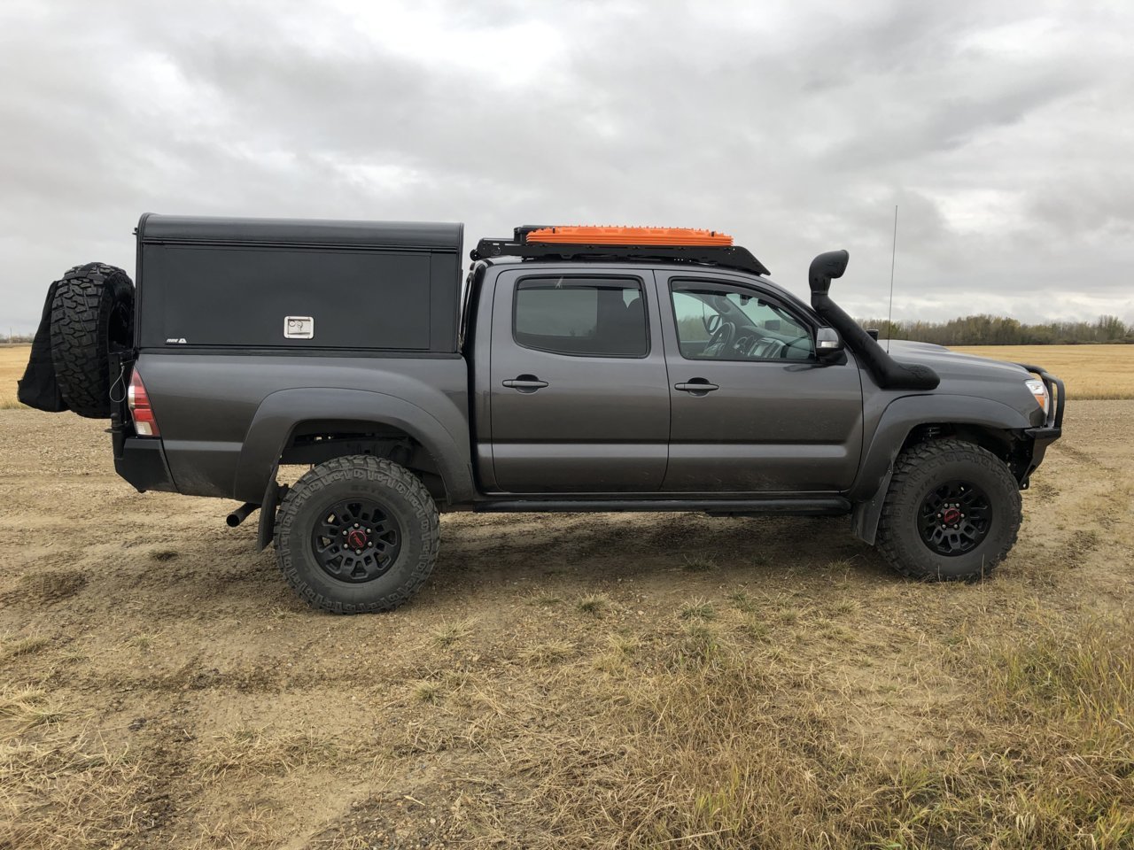

    Quoting here to add that I weighed my truck and wow...she's porky. Front 2910lbs, rear 3505lbs fully loaded. I did not get any exterior pictures when loaded :facepalm:but it sits level front to back. The leaf pack pictures below are fully loaded and the nice "W" of the Crapkars. I'm second guessing whether the Deaver U402 stage 3 pack will be enough or if I'll need to do a custom pack. The truck will not be fully loaded all the time, only when we go camping, etc. I figure it will lose minimum 200-300lbs when not fully loaded.

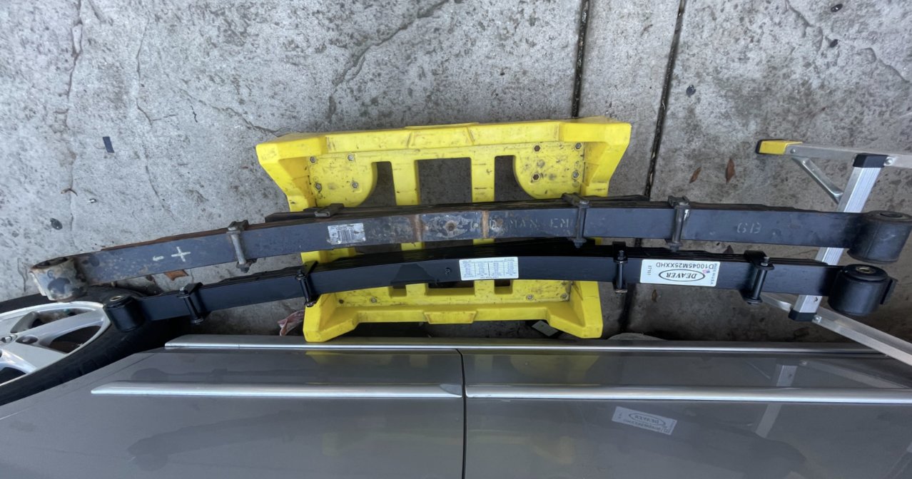

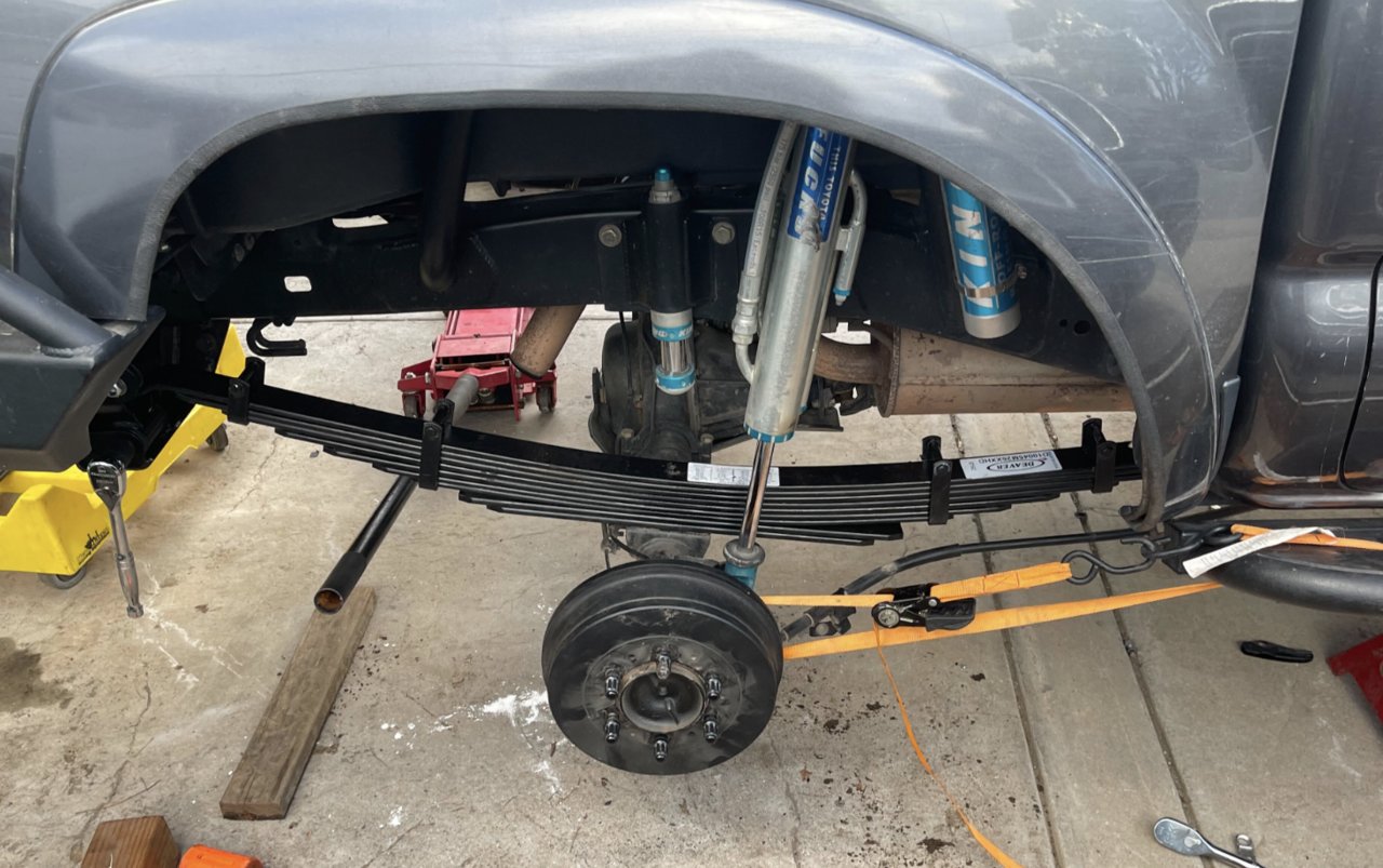

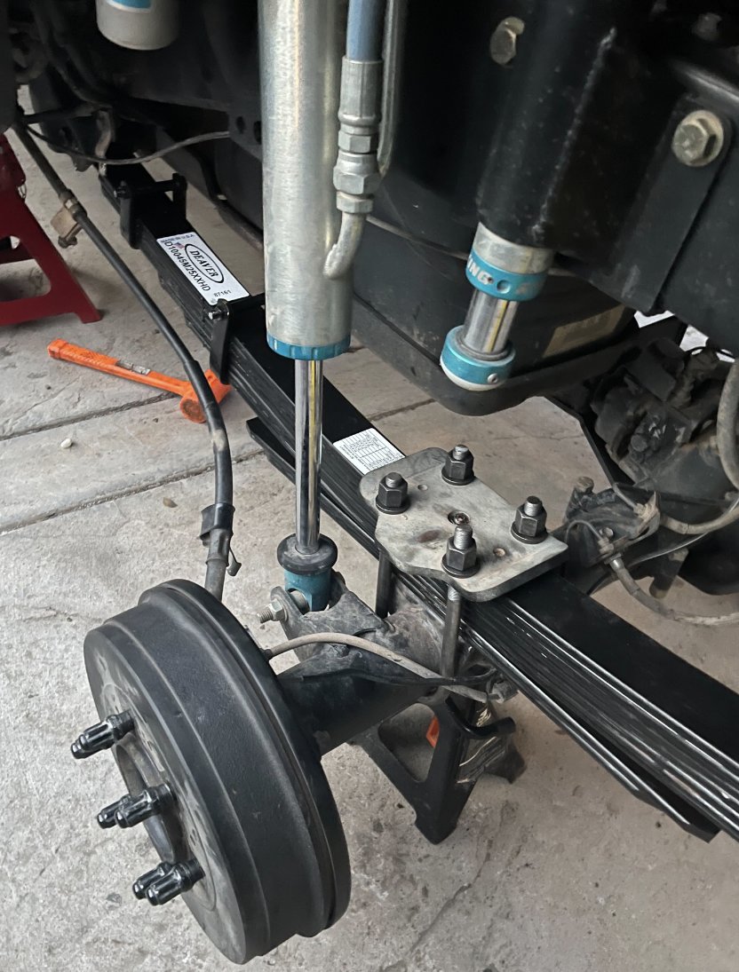

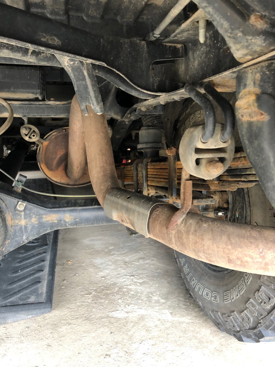

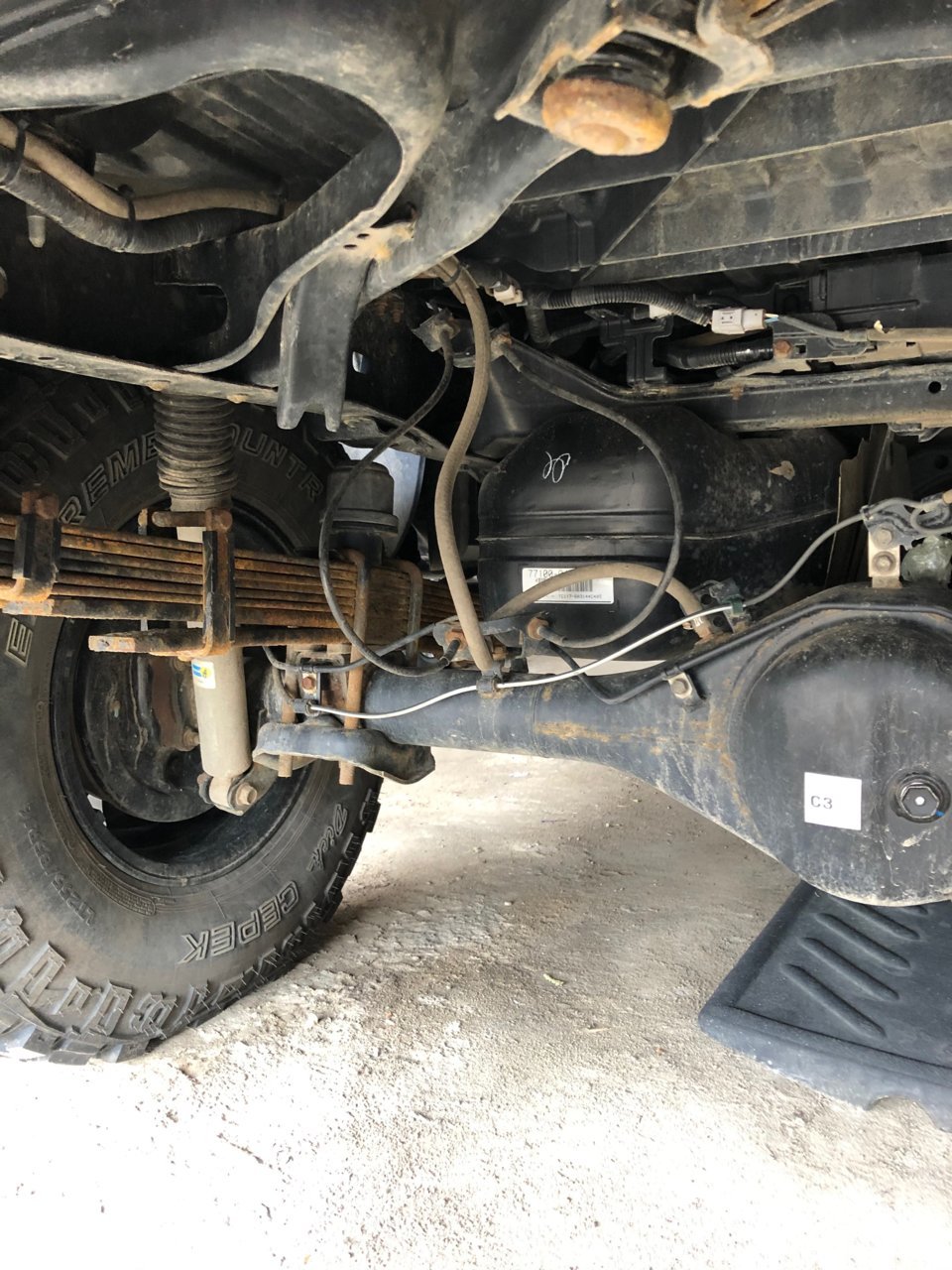

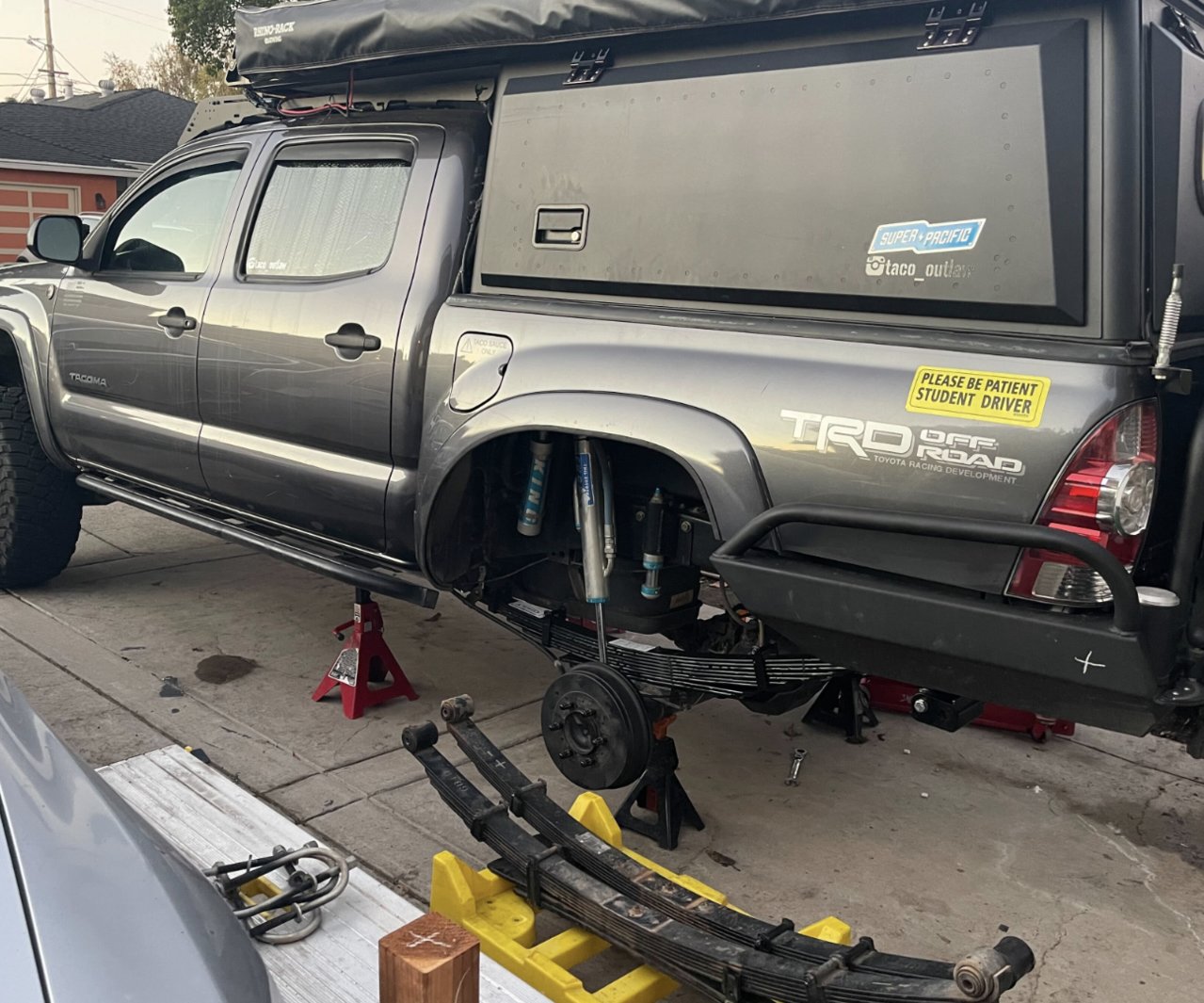

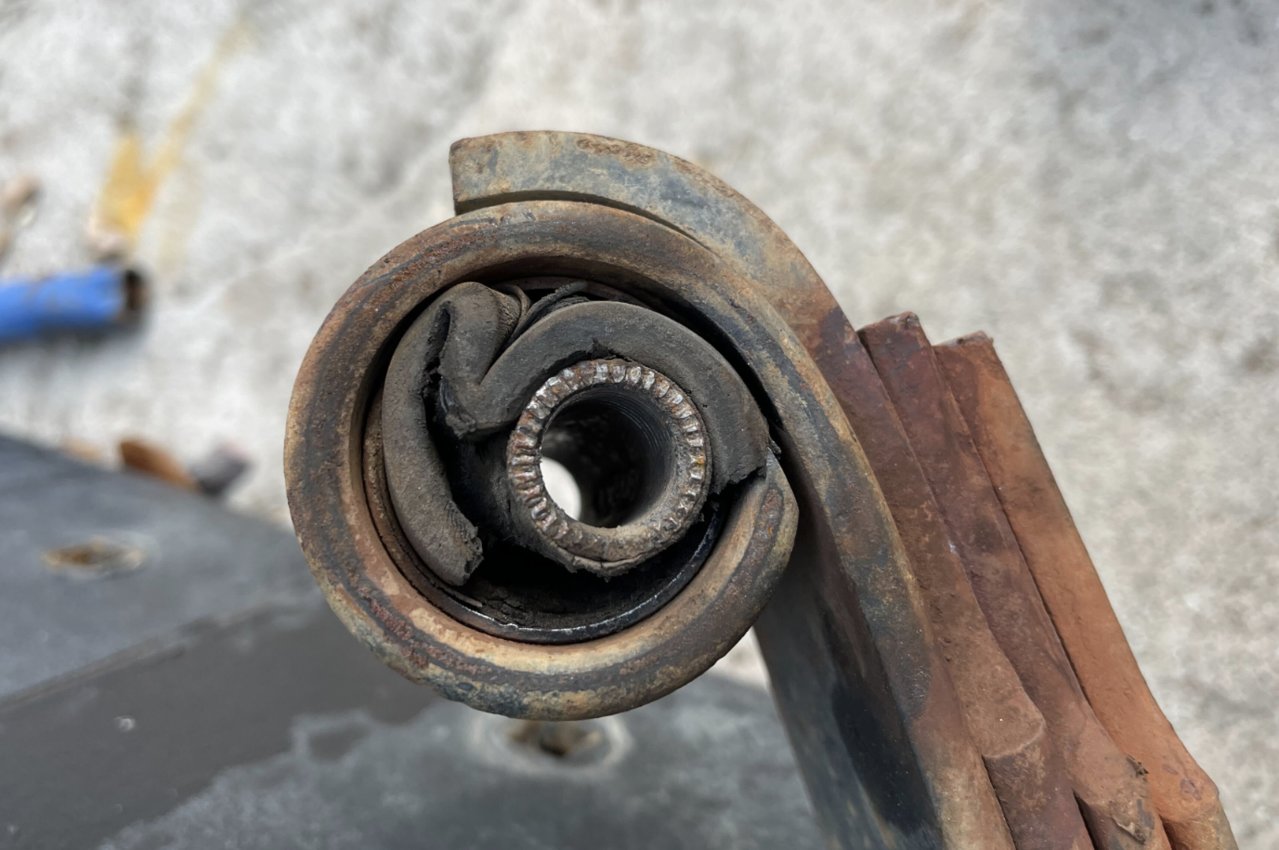

    Finally got my custom deaver pack in. This is the XXHD (good for 15-1600 overstock). When I have full armor and gas I sit close to 6600-6700 and near 7100 with all the gear, myself and son.
    Nice to feel the rear flexing again. Have not taken the truck out yet but def more noticeable than the flat abused Dakar pack. It did its job but def was not great after adding the rear swingout setup. That tipped it over the edge.
    Prior I was seeing 9.5" axle to frame (i have no idea on fender measurements and my fenders are trimmed 2.5" to give some more added reference to the height).
    After I am not seeing a solid 11" axle to the frame. The XXHD is a 3" lift pack good for some heavyweight setups.
    The only issue now which I am seeing is actually an issue is my bump is now striking at an angle and no longer dead center. Curious if I need to rotate my axle or this is more due to the much larger and less flat-leaf pack (seems like it could be a bit of both)
    Old vs New

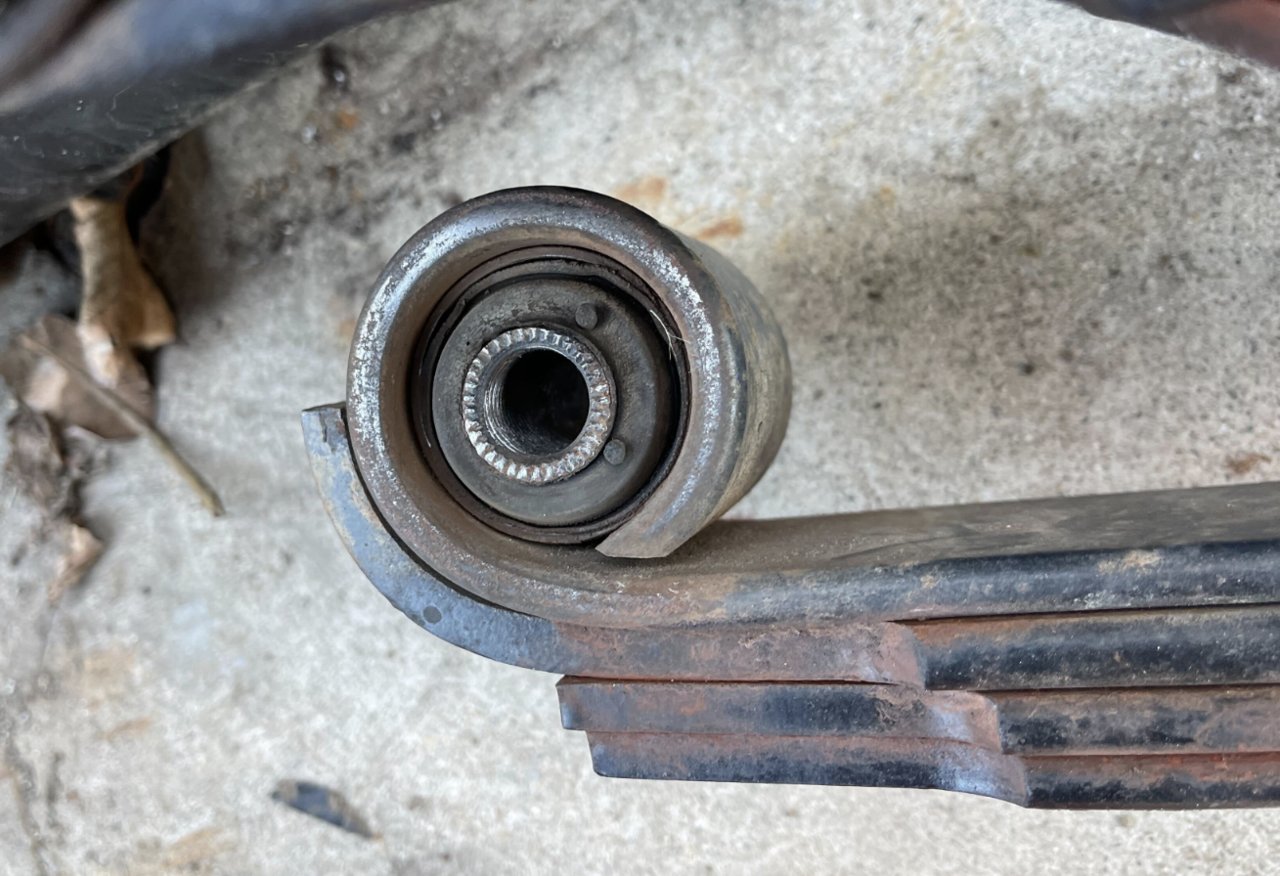

    I had been running my Dakars with OEM pushing and man did they take a beating. This one looked good as new when I pulled the leaves. :rofl::rofl::bananadead:

    I threw new bushings on my dakars when I installed them, and I will again when I eventually get deavers lol

    Those were new when they went in the Dakars as well just used OEM at the time.

    ha yah that was a surprise when I pulled them. Early on in my setup the suggestion was to use OEM not Poly and that was far from a good suggestion.
