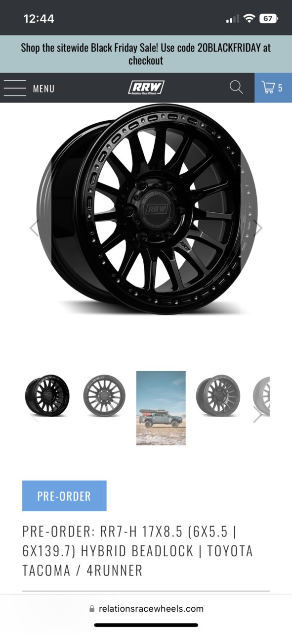

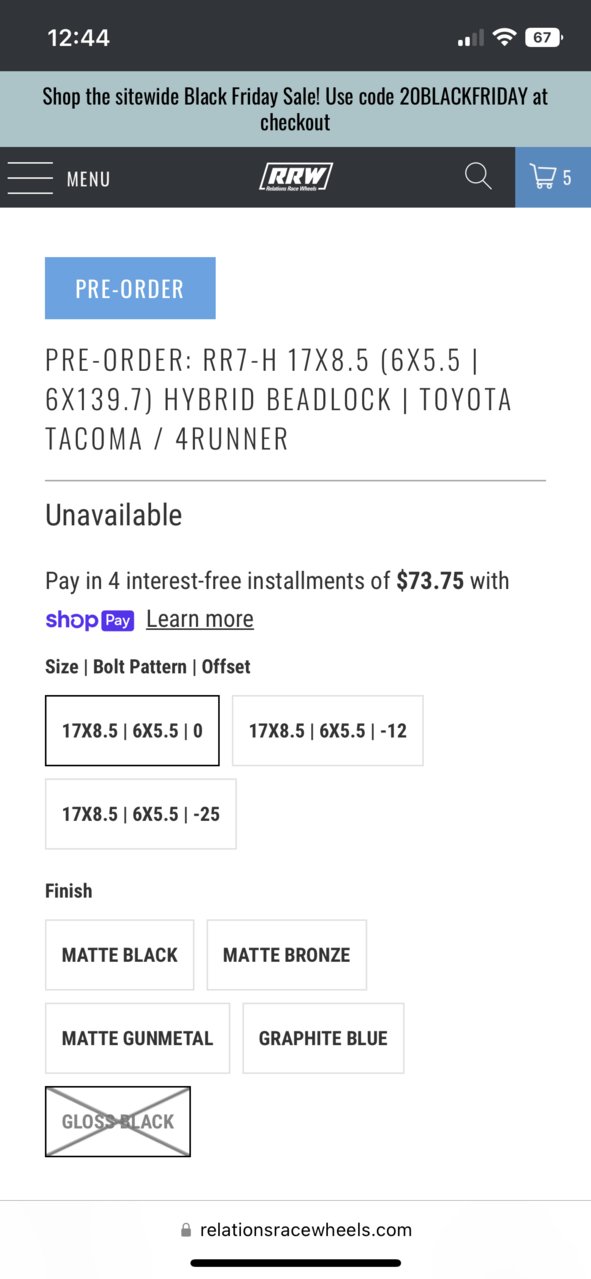

    Hi all,
    I would like to upgrade to new wheels and tires for my 21 off-road. After doing a ton of research I have decided on the relation racing rr7-h with the -0 offset. Unfortunately they only have -12 offset in the color I want. Will these work on my stock suspension Tacoma? Tires I have decided to go with 265/70/17 wildpeaks. Any suggestions would be appreciated.
