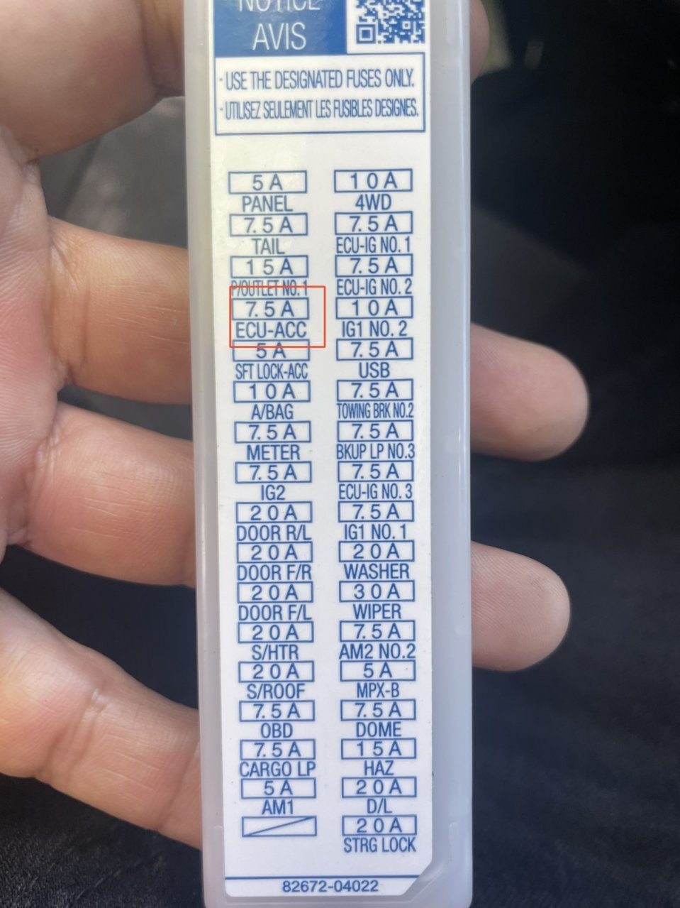

    You need a test light. Need to check continuous power and acc power with the test light. Also check fuses with the test light.
  17. Jun 1, 2022 at 12:19 PM
    #17
    sekohone
    sekohone [OP] Well-Known Member
    Sep 29, 2019
    #306613
    47
    2019 TRD Sport
    It ended up being this fuse :frusty::facepalm:
    FL_TRD Sport likes this.
