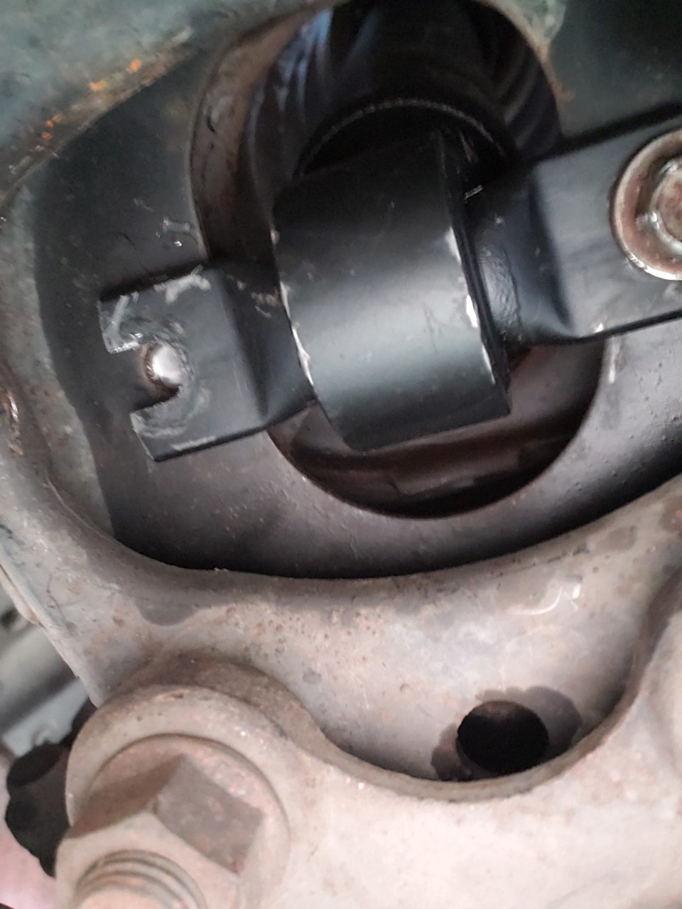

    bottom 14mm bolt, i over torqued it and the head broke off. Can I drill it out or should i take it to a shop?
    2002 4x2 xtra cab 2.4l.

    920
    drivers side

    TRD Pro Grille, Skid Plate, TRD Cat-Back Exhaust System, 2017 Tacoma TRD Rims, ARE Series II Lid,
    Screw extractor, little heat

    10 Taco 4x4
    A bunch a cool stickers, a bada ass MetalMiller Tx Longhorns grill emblem painted Hemi Orange, JBA long tube headers with o2 sims, Diff breather mod, Red LED interior lights, Fancy head unit that plays ipod n movies, Also DIY install factory stuff like, factory cruise control, factory intermittent wipers, OME nitro struts with 886x springs and toy tec top plate, JBA high caster UCA's for better alignmnet and dey beefier too, Old Man Emu Dakar leaf springs in da rear with the gear, U bolt flipper, Ivan Stewart TRD rims with 33" K Bro 2's, some bad ass weather tech floor liners so I don't muck up my interior, an ATO shackle flipper for mo travel in da rear wit the gear, also super shiny Fox 2.0 shocks back there too, all sorts of steal armor for bouncing off of the rocks like demello sliders, AP front skid, trans skid, n transfer skid, demello gas tank skid, and a tough as nails ARB bumper with warn 8k winch, I'm sure there's more
    once you drill it and use a screw extractor, it should spin freely

    1997 Tacoma lowboy
    If it went in easy, it should come out without too much trouble… Left hand drill bits are your friends….

    #335235
    920
    I MOTHER F'IN DID IT!! rode my motorcycle to harbor freight and got a reverse drill set, sprayed wd40, wait 15 in, used a #2 bit in reverse until is snagged and then burst-spun it until it came out!! thanks! Now i gotta wait 3 days for replacement bolts.
