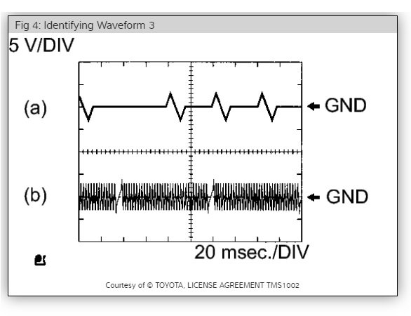

    A scope is required to see the actual signals but are you sure you didn't swap a connector somewhere?
    Did you get the Crankshaft reluctor wheel installed properly?
    Do you have any codes?
    Do you have RPM on the scanner while cranking?
    Image is what the signals should look like, top line is cam bottom line is crank.

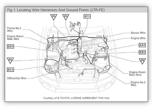

    That really sounds like a main ground or power is not connected.
    Here's the location of all the ground points in the engine bay. Triangles are grounds, rectangles are harness connectors.
    Also check your main block and body grounds from the battery.

    Thank you very much for the diagrams and direction. Will print this out and proceed. Hopefully the rain can stay away for a few more days.
    EDIT: I just used a jumper cable attached the battery ground to try to add a large amount of extra grounding, - no change.

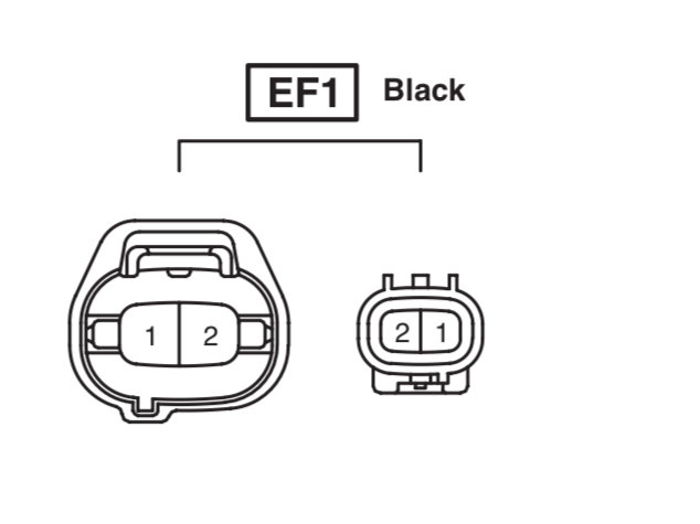

    Could you possibly show me a zoomed in picture of what connector EF1 is? I don't see something that corresponds to that one in the bay.

  15. May 3, 2022 at 11:42 AM
    TnShooter
    TnShooter The TacomaWorld Stray
    Sep 2, 2010
    #42625
    21,592
    Deogee
    07' TRD Off-Road, Auto
    STOCK
    I don’t know if this will help.
    But it’s all I got as for what it looks like.
