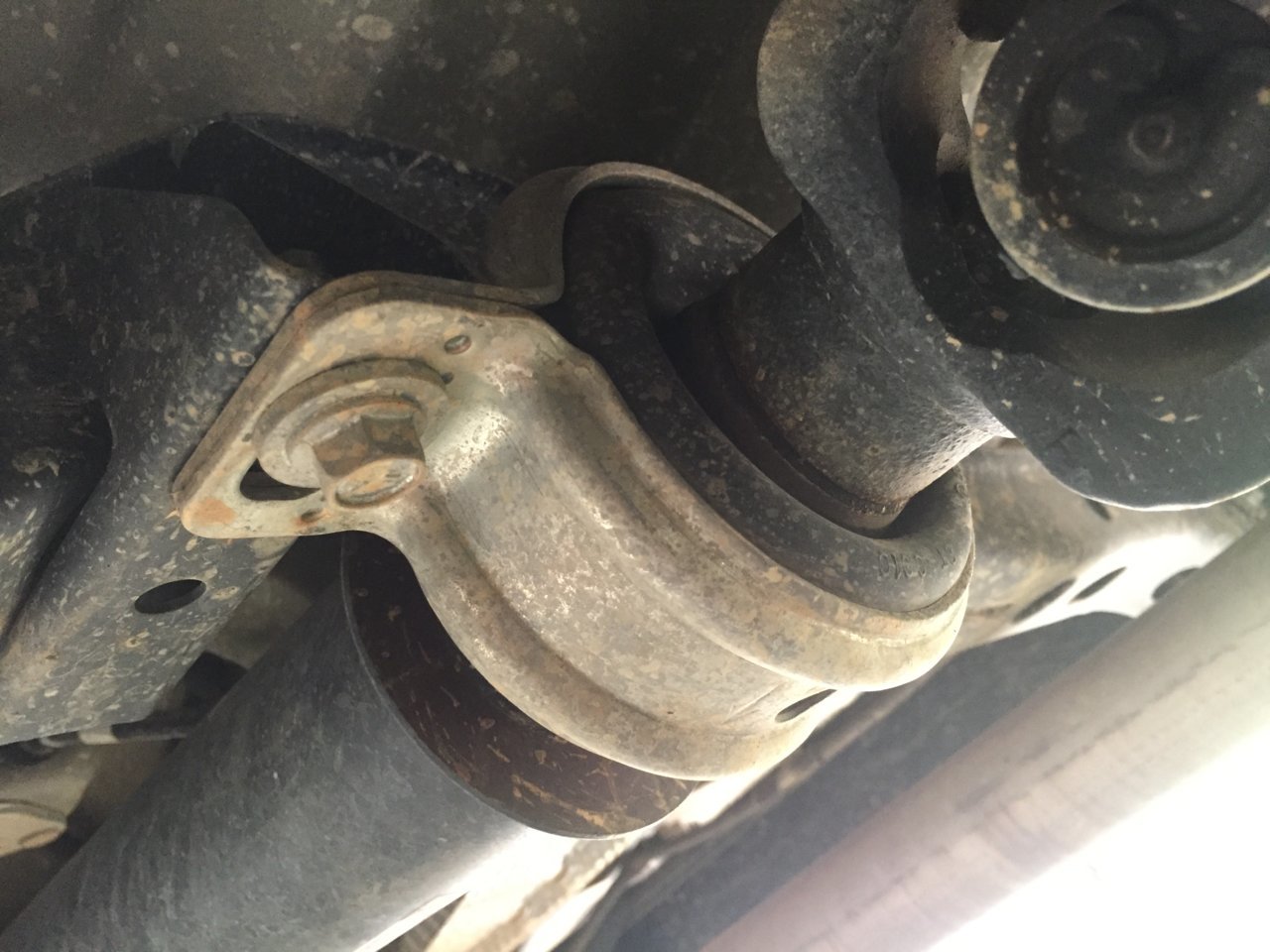

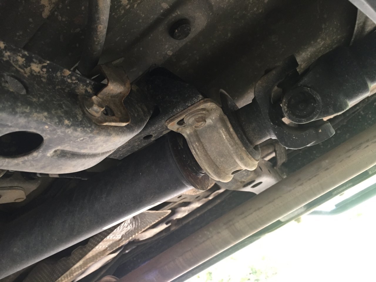

    Let's see a picture of the carrier bearing in your driveshaft

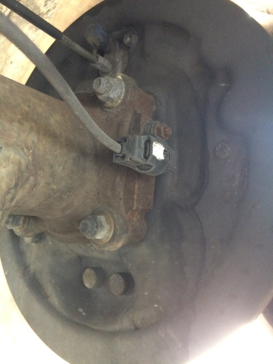

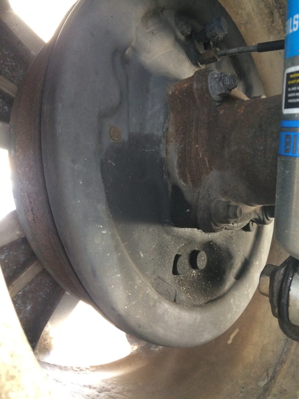

    Any thoughts on what this might be? I still get the noise while coasting in neutral as well. I'm wondering if it could possibly be a rear wheel bearing at this point.
