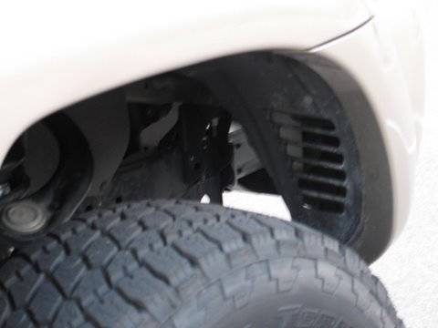

    Here are some pics. I have more, but hopefully this will do for now.
    Passenger front tire
    Driver Front
  13. Jun 22, 2009 at 4:52 AM

    If you've got any pics of the actual bump or the area that was trimmed, that would be appreciated.
    Thanks.
  14. Jun 22, 2009 at 6:47 AM
    Simon2150
    Simon2150 Well-Known Member
    Dec 22, 2008
    #11809
    1,044
    Austin, TX
    06 Tacoma DoubleCab V6 SR5
    Sorry, I didn't get a pic of what they trimmed, just what they look like now. You can go out and look at yours for comparison though.

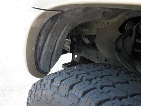

    Here are the new shoes:
    I did have some rubbing of the mud flaps. I didn't want to take them off though as to protect the paint on the doors a bit. I trimmed the fronts so they weren't so long, and I cut the nub off where it rubbed at about 1/2 lock (and only sometimes), noted by the number 1 in the picture. I also snipped a piece of the fender flare which was under the nub (1 in pic) on the modflap.
    The number 2 in the picture is where it also sometimes rubs at full lock, but I felt that trimming this would significantly weaken the mud flap. I'll live with this rubbing as it is pretty minimal.
