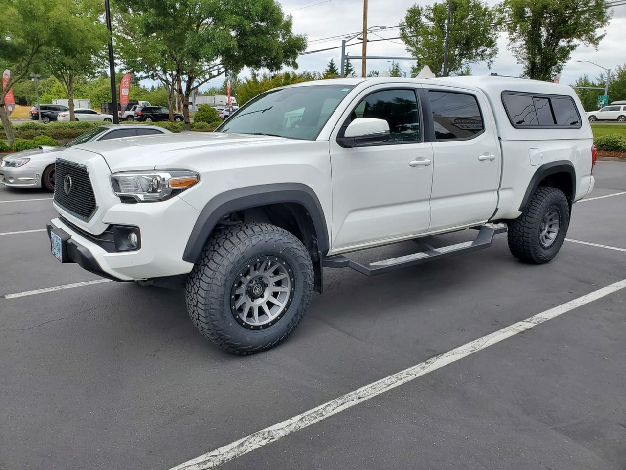

    Not another crying and throwing a fit my MPG sucks thread.
    I recently moved up to 285/70/17 on a 2.5" Eibach lift and a three pack AAL with the Overload in place. And for those that will ask, minor trimming and no rubbing on my mostly pavement life.
    Real question is trying to figure out a ball park MPG so I can plan for a road trip.
    Is it as easy as this:
    (displayed Miles since fill up + 10% that I am running slow)/ gallons of fuel used = Approx MPG
    Pic for looks.. Because I like how it looks.

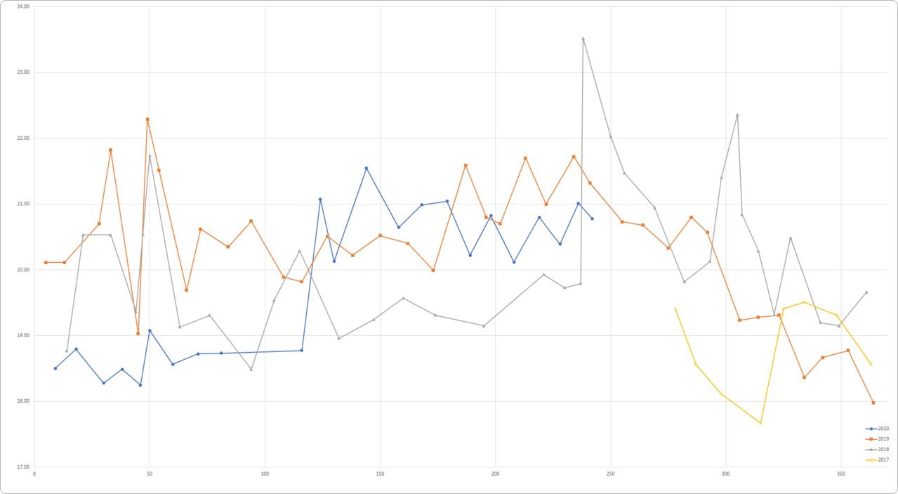

    Ah! You're talking about your available range, not computing MPGs. From that, you need a basis of more than one trip or a current tank of fuel. I log fill ups and have a separate chart that overlays each year to see comparisons and trends, which also includes the speedo correction for the new tires. I got the correction by comparing a GPS measured distance going down a more or less straight freeway for several miles compared to a Trip B distance. I wish I had done this with the Stock tires.
    From that, I know that I will get at least 21mpg for conservative trip planning.

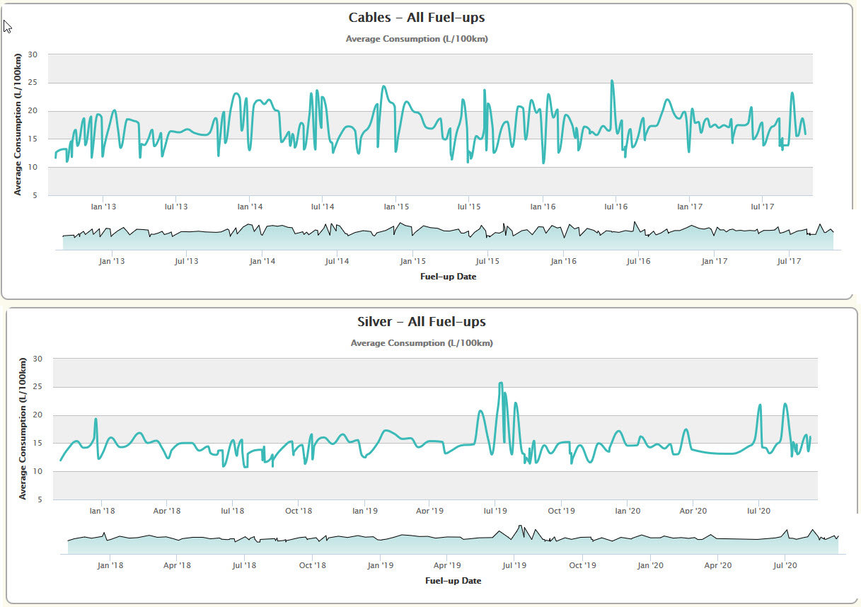

    Go sign up on Fuelly, log your fuel ups, it gives you all sorts of neato stats;
  13. Sep 10, 2020 at 9:51 AM
    tonered
    tonered bartheloni
    Sep 25, 2017
    #231055
    31,235
    tony
    Lynnwood, WA
    I wish they would have a few more. Esp the year to year overlay that I mentioned and sorting the Taco categories better. They have the engines all confused with no transmission choice. Still a great site.
    Here's my own set up using the CSV output from fuelly.com.
    Boghog1 and hiPSI like this.
