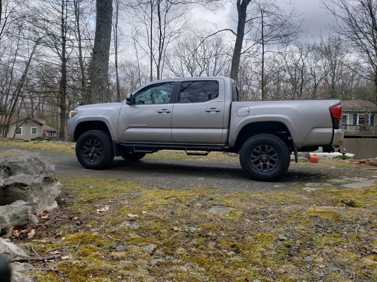

    I have the exact same lift on my 21'. Love it, good ride and good handling but you will only get 2.25-2.5" from the lift. I also went from 245's to 265's and the combination got me the 3+" of lift.

  4. May 15, 2021 at 3:49 PM
    brandons.tacoma
    brandons.tacoma [OP] Member
    Mar 21, 2021
    #360102
    5
    Brandon
    2019 Cavalry Blue Tacoma TRD Off Road
    Do you have a picture of your taco afterwards?

  6. May 15, 2021 at 3:58 PM
    JC713
    JC713 Well-Known Member
    Jan 30, 2021
    #354549
    45
    2021 Tacoma SR5
    After
