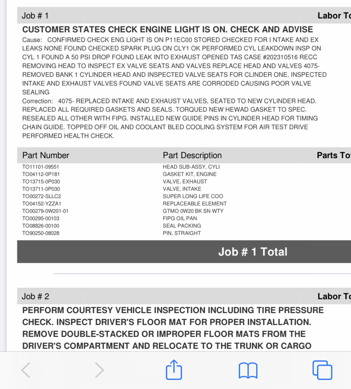

    Got a call back from Toyota today and they didn’t send it to the shop for the test. They are replacing one of the heads on the engine.
    Not 100% sure what is going on but they are going to fix it.

    got the invoice from Dublin

    Interesting. Corroded eh?

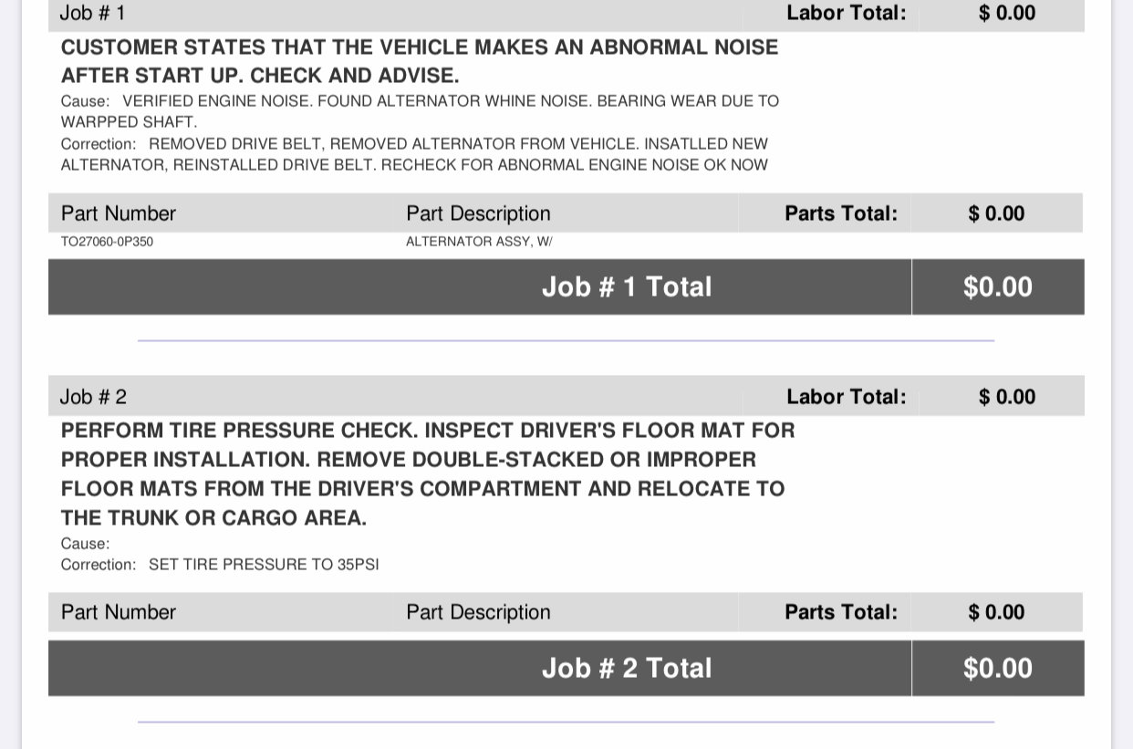

    Went to go pick it up last night. Started her up to head home and heard an odd noise.
    Left it over night and they changed the alternator today....

    We will see how it sounds when I get it in a few hours.

    ive heard stories of excessive tension on alternators/ water pumps from over tightening belts and it leading to ruined bearings in the parts. they could have over tightened it when assembling the engine
