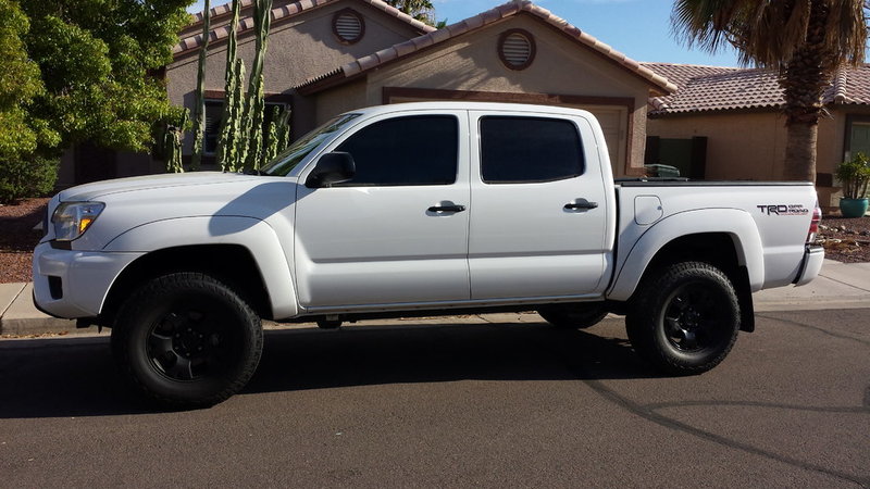

    lift.jpg BOOM! 5 hours later lol. Stuck a 2X4 between LCA and bumpstop and had my wife flex it to squeeze coilover in. As far as the strut bottom, stuck a screwdriver in the hole and twisted it into perfect angle with bolt hole (thanks Dustin). Got about 2.25" of lift. Couldn't have finished this without your suggestions guys thanks. Next week, AALs hahaha.

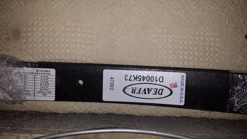

    Got these in yesterday from a fellow member :thumbsup:. It came with the longer bolts now my question is do I need to change out any other hardware other than supplied longer bolts? Don't want to take rear apart and get stuck in the middle of the job.

    Cutoff wheel on an air grinder fixed mine .... $14 later they were new. Lousy design, the Allen head strips right out.

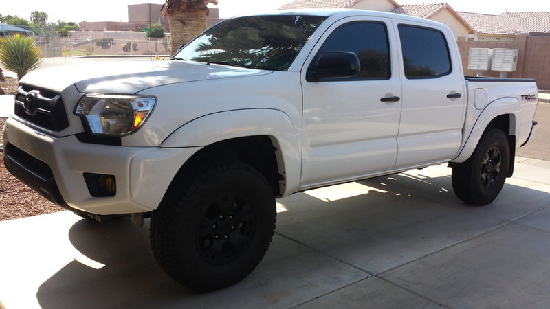

    Installed my AALs today whew :yay:. Took about 3 hours and definitely not as hard as the fronts. I love how truck sits now and you guys are right, the ride is so much smoother.
