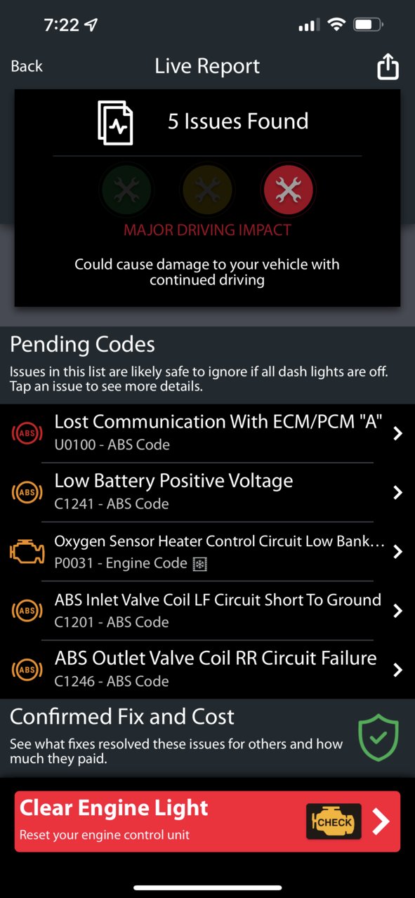

    I have a 2011 Tacoma and can’t figure out what the problem here like if all the codes are connected but could y’all help me please

    Those are pending codes.
    I wouldn’t worry about them until you get a Check Engine Light.
    Some of them could be caused by simply disconnecting the the battery or such.

    I already have cleared all these codes then they came back up like 15 seconds after the check engine light still keeps coming up

    Is that all the codes you are getting?
    Because the ones shown are pending.
    I suspect your code reader can’t read ABS codes. And you have ABS codes being thrown. Or at least it isn’t reading them as active?

    Seeing low voltage, circuit, and com codes I would want to first verify the battery and charging system is good as well as main grounds and battery connections before proceeding.
