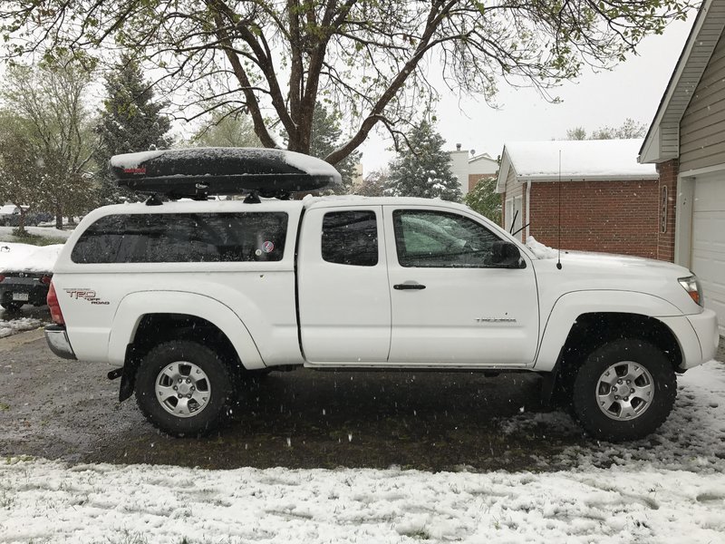

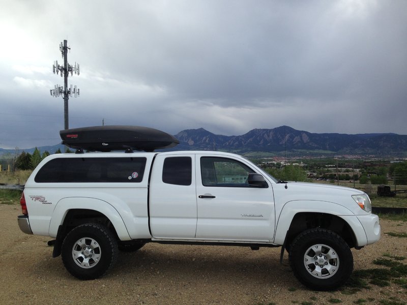

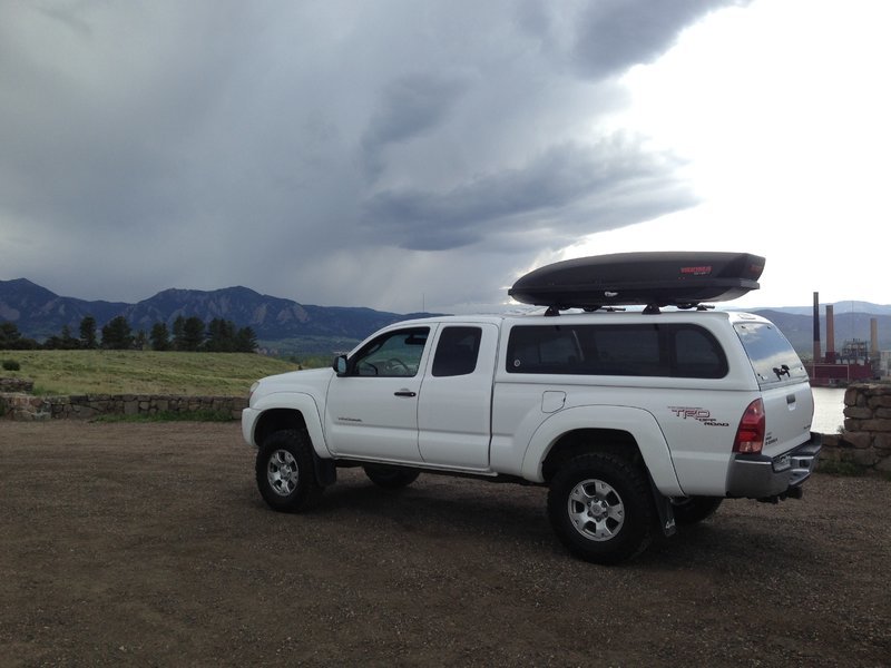

    They didn't align it, I was going to bring it in for alignment tomorrow, now I'm just driving it back to the shop in the morning and they are going to fix it. Kind of glad I get to re do it because I don't think I would have been happy with the 1.75 setting.
    If anyone is curious, here are some pictures of an 05 tacoma with 2" rear tuff country AAL with the recall leaf pack and Bilstein 5100s with the spring perch installed incorrectly, upside down, giving me 5" of lift in the front :p
