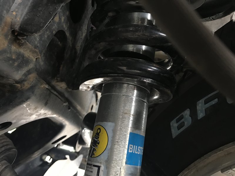

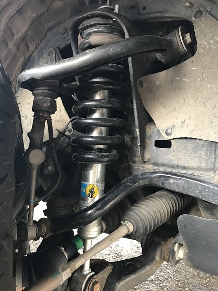

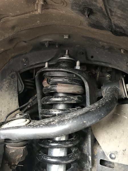

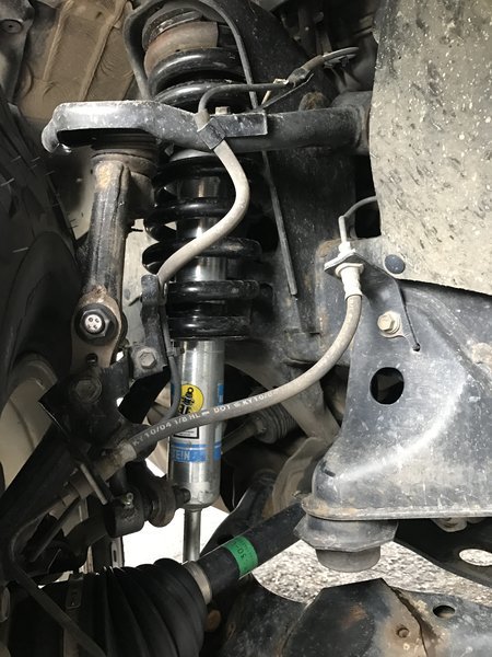

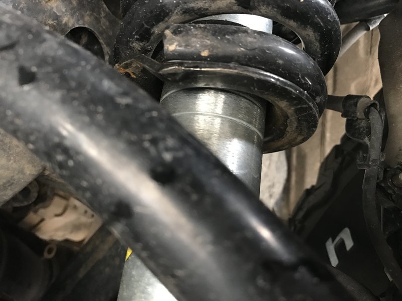

    Well shoot, now it looks like the truck is sitting about .25-0.5 lower on the passenger side. Is that normal or do you think the springs got swapped. Is anyone able to tell the difference between driver side and passenger side stock coils on an 05 ? Here are photos, does anything else look wrong? IMG_0919.jpg

    You could be right. I believe the Driver's side spring is slightly longer to account for the Taco Lean. When installing aftermarket springs people typically install a small spacer on driver's side since aftermarket springs would be same length on both sides. Sorry, but I don't know how to tell the difference.

    You have what some people call the "reverse taco lean". Its usually the drivers side that sits low. People will either live with it or put about A 1/4 inch spacer on the low side. However, with the drivers side just a little high, it may be close to level with you in it?
