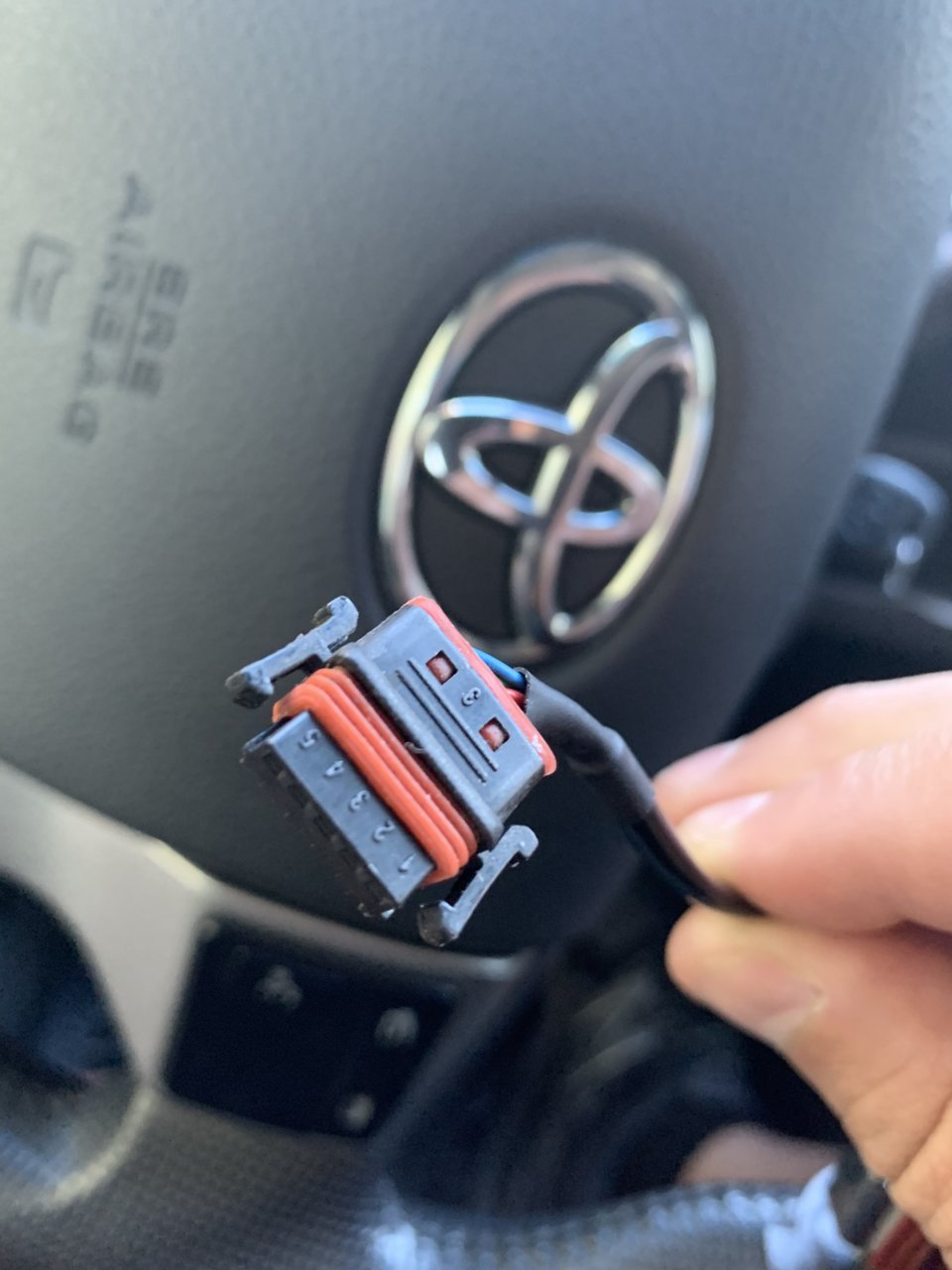

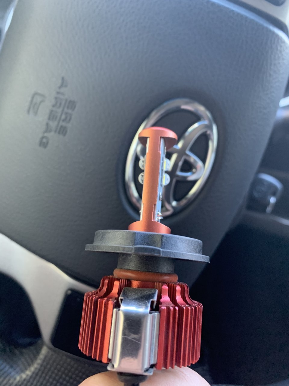

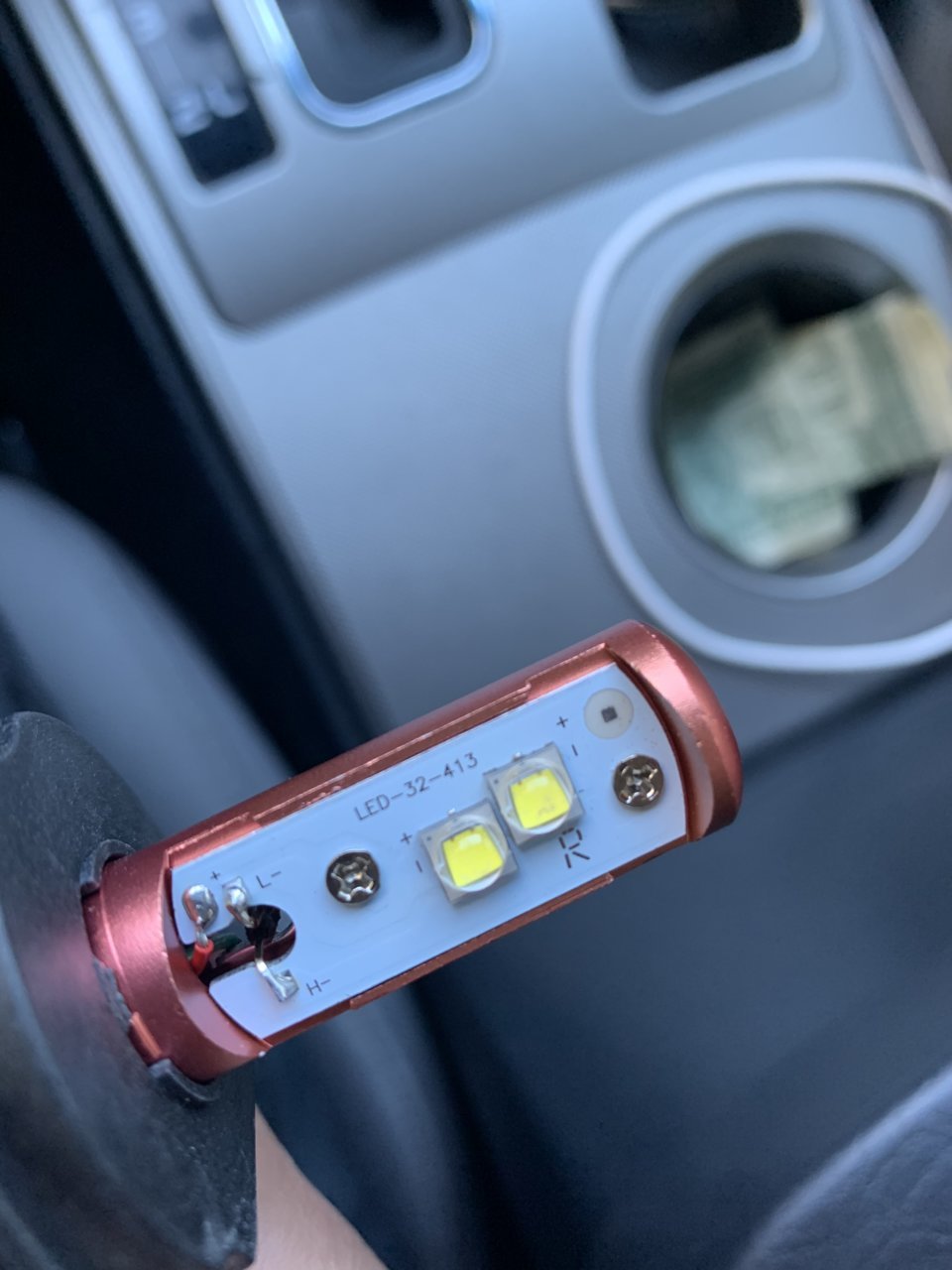

    Could anyone help me identify this bulb?
    I bought my 2013 Off Road used, and I think this headlight kit is aftermarket.
    One burned out and I’m having some difficulty finding a replacement

    It's an aftermarket (Chinese) drop in LED bulb. Literally dozens of them out there - all claiming to be awesome. Truth be told, you're actually losing performance with them in a factory headlight housing. Going back to a standard 9003/H4 halogen will actually improve your performance and significantly reduce glare for oncoming drivers.

    The whole kit with two LED bulbs and igniters can be bought for less than $20 on eBay or Amazon. Search for "HB2 LED". You won't find a single bulb for sale for cheaper.
    There will be beam pattern drawbacks like @Too Stroked mentioned.

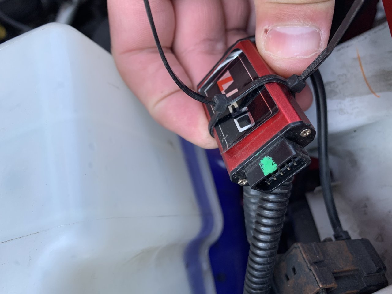

    the bulb was hooked into this thing, which says OPT7 on the sticker.
    This is wired into the cabling pictured at the top.
    Will an OEM bulb work with this setup?

    Could someone tell me if I’m good to plug an oem bulb into that thing I posted in my last pic ?
    Im assuming that harness isn’t standard... what do I have to do to make the OEM bulbs work in it?

    No you rremove that thing that is connected to the h4 plug and plug the h4 into the stock bulbs

    so I’ve gotta pull apart those bundles of cables there?

    Remove all that red Chinese garbage. Those are awful performing illegal opt7 LEDs that everyone thought were the rage years ago before people knew better. Beam pattern on the right is Opt7 with glare everywhere above the cut off dangerously blinding other drivers while having reduced visibility for you. Beam pattern on the left is the halogen upgrade linked earlier, far brighter and doesn't catastrophically change the beam pattern like the Opt7 LEDs. The glare on the left is carryover from the LEDs, as they are that bad.

    Yes, following all that wiring back and you should find the connector for the oem bulb.

    Yes
