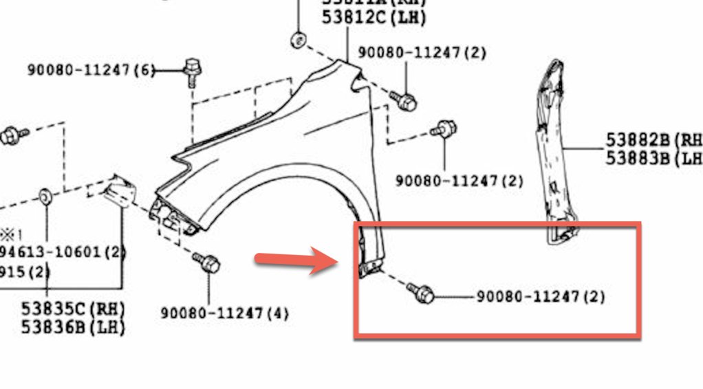

    I'm trying to identify the proper size for a specific bolt. I have the part number, but the Toyota Parts site is a dumpster fire.
    I am looking for the correct bolt for the lower front quarter panel (see Diagram)
    And if anyone can help with a part number, or replacement option for the Air Filter box with the rubber isolators that would be helpful as well. (I want to take out the big S&B, and put in an OEM Airbox for more room and flexibility)

    The bolt is a flanged M6x1.0 by some unknown length with a 10MM hex head. Just go down to the local ACE hardware - they should have something very close.
