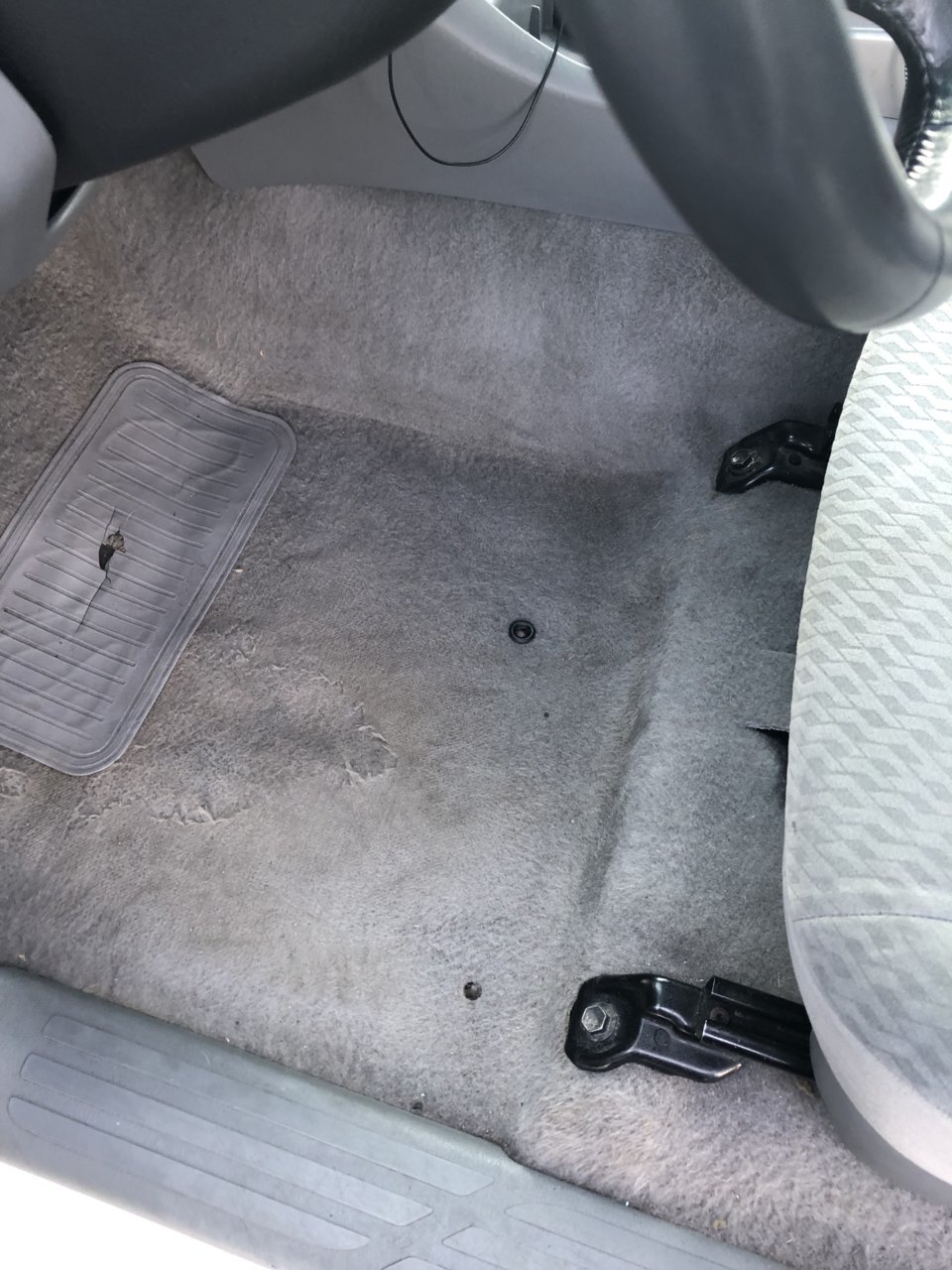

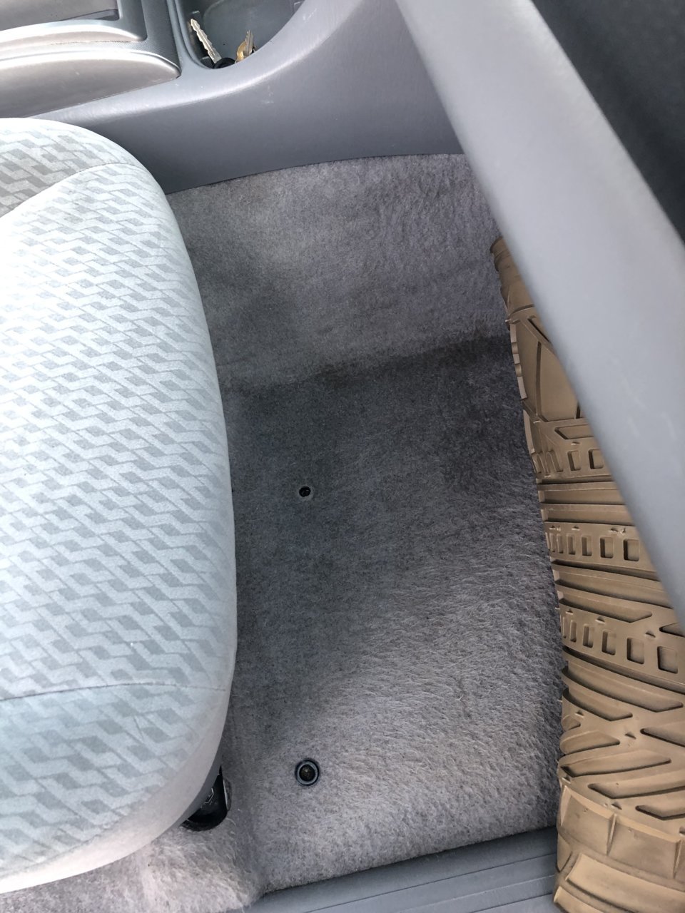

    Hi everyone,
    I have been striking out lately looking for the 2 piece grommets that secure floor mats to the carpet. The local dealership parts counter have either been too lazy to try to help or don’t have the expertise to know how find what I need.
    The best they can offer is for me to replace the whole carpet just so I can replace these parts. What I’m trying to do is upgrade the floor mats to either weathertech’s or husky’s but the grommets that the plastic anchors would latch to are missing 1 of 2 on each side (driver & passenger).
    There are no local junkyards I could travel to and I have come up with no options online. Please find the attached pictures of what I’m referring to. Thank you for any input on what route I can take to get this taken care of! 64EB44D4-9AF9-4247-ABFB-96FD22D6AFC4.jpg60786AB9-63BF-4F1F-A1DD-694C4A66B611.jpg

    Erm... I don't know that Toyota sells those separate, I'm sure they do come already installed in a new carpet. If you really, really wanted, I'm sure you could measure the ID (or just guess it's 3/8", close enough as it's probably 10mm) and buy some grommets & an install tool for a few bucks.

    I’d just pick these up and install your own. You’ll have to take part of the carpet up to get access. Should be easy enough.

    I don’t think so. If you notice the picture I posted the ones I have are different. I actually ordered those through my local dealership and they are not compatible. I considered them but the mats would not lock in the same.

    Can you post a photo taken closer to the retention hook? I can’t see enough detail in the pix in your first post.

    The dealer should have stock of the carpet hole repair kits. They use to be be free. I think they’re a couple bucks now. No part number of hand unfortunately. But 5 years ago I got them for repairing my fathers hook on his 02

    Sure looks close but this one looks different. I hadn’t seen this one. I’m not sure that the Toyota replacement kit would fit into it

    the repair kit will fit. its not the same as the factory hole. its a little larger of a plastic clip to make up for potentially worn out carpet holes., install and the J hook will pop in
