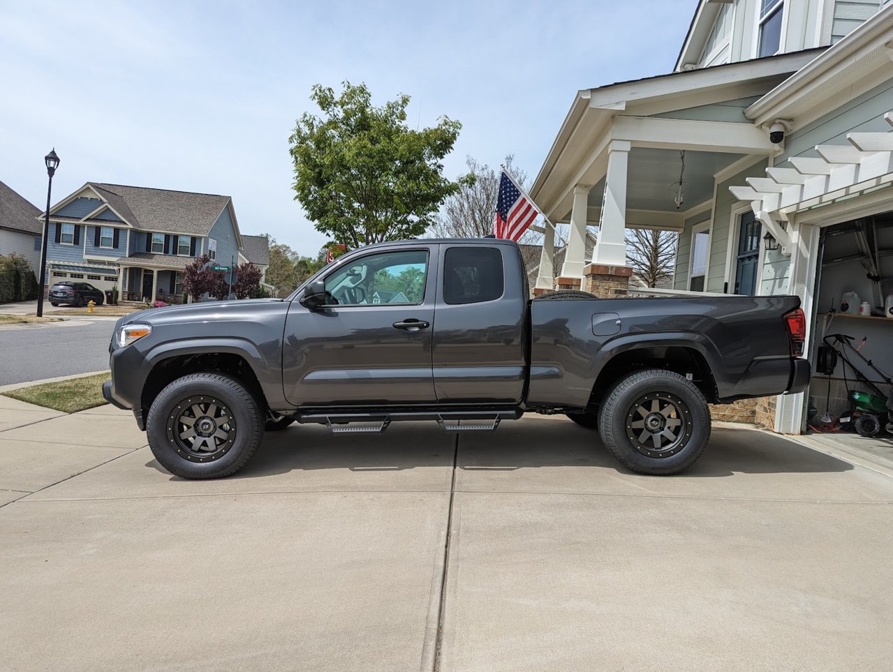

    Got the wheels/tires installed today. I cannot get over how good this looks. Rides amazing too! Thank you all for the tire size suggetion. Those 265's are perfect!
