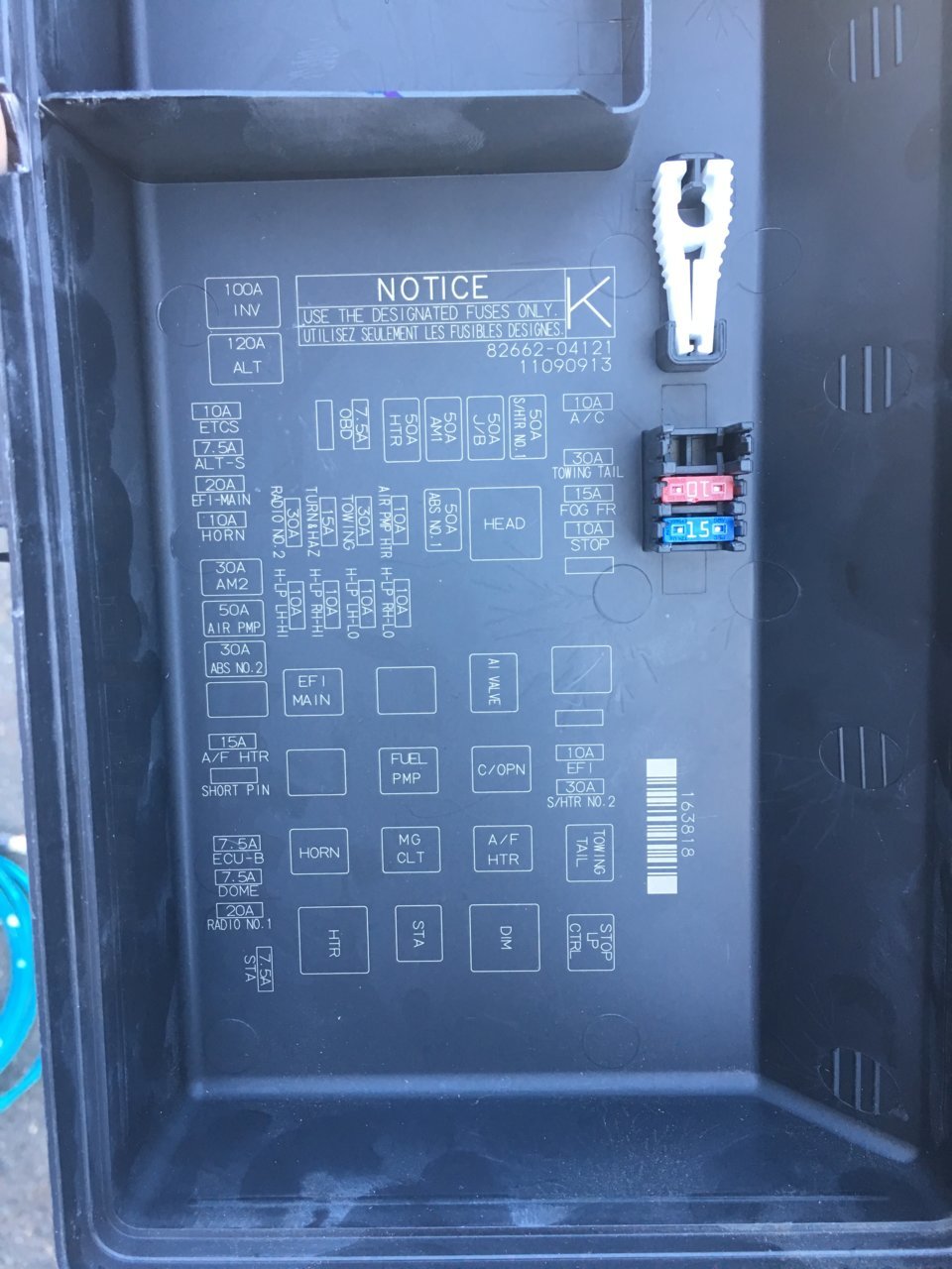

    So this brings me to my thinking on what I did to get it to that point, and I figured I'd wired the triggers for my isolators on incorrect fuses. I am including a pic of my specific panel for my 2014 DCSB. I had one triggered to 'RADIO NO.1' and the other triggered to 'RADIO NO.2'
    Am I wrong in thinking these were ignition on? Are these always on? What fuses on my panel can I tap to allow the system to turn on when I turn my truck on? Thanks for the help yall!

    I have a 2014 DCSB and I'm pretty sure there is no fuse that is truly only on with the ignition. The closest you're gonna come is the EFI. It will turn on and off with the ignition but that circuit runs a check every 4 hours for about a minute so every four hours you're gonna get power for a minute. I have my halos on my headlights wired to this and they turn on every 4 hours, I just don't worry about it. I will get calls from friends occasionally telling me my headlights are on though.
    I tested all of the fuses with a multimeter and couldn't find one, but if there is one I'd love to know which one it is!

    thanks for the replies @Muddinfun and @The Boat Oar ! thats interesting that there's no 'ignition on' on that fuse panel. VERY good to know, that makes sense as to why my battery drained so thoroughly! There are some in the interior fuse panel, so I can bring my triggers through the firewall and tap in there. Thanks again!

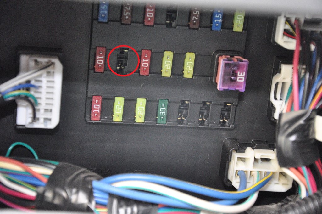

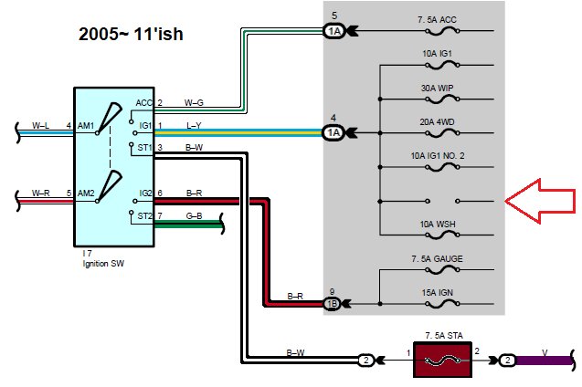

    ACC or any of the 3 20A power window fuses. The drivers door PW fuse is 30A. Leave that one alone.
